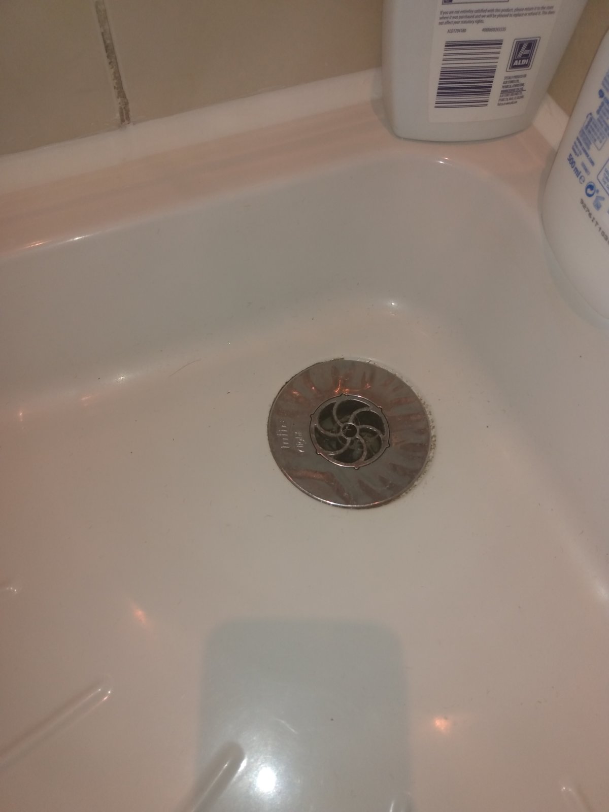

Hi,
ive attached a pic of what is a Mira flight drain.looks older than other online ones.
the drain is blocking and ive removed the lid but there doesnt appear to be a "cup" insert
that you can then lift out and remove hair from.
Any advice -thanks !
Ade.

I had one which blocked in months. Its not serviceable from above and once youve undone an outer cup from below its quite difficult to get hold and pull out the slime thats gone part into pipework as the tube that helps form the water seal restricts things..I hope you have access from the side or its hole in the ceiling time.
I posted a pic on page 3 of the trap
https://www.diynot.com/diy/threads/shower-tray-to-replace.539223/page-3
