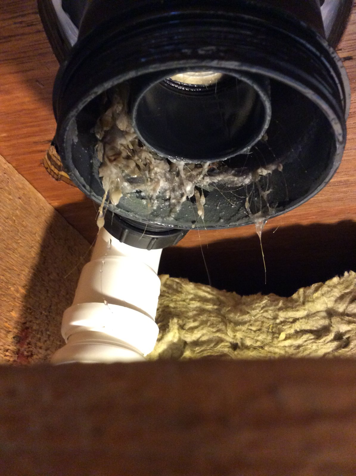

Having spoken to Mira, I have to find a Shower Waste Adaptor to go between the 43mm waste pipe and the 39.5mm bore spout of the waste unit. None of the local plumbers have such an item, such fun!
Is that using the Mira supplied trap cos mcalpine fits the larger bore?
Not a pretty sight after 3 months, outlet has a lip part blocking the outlet which would only fit 40mm push pipe.
Yes, the Mira requires a reducer which I've not been able to find yet, 43mm pipe down to 39mm to fit into the spout bore. Its ridiculous of Mira not to supply the part.
