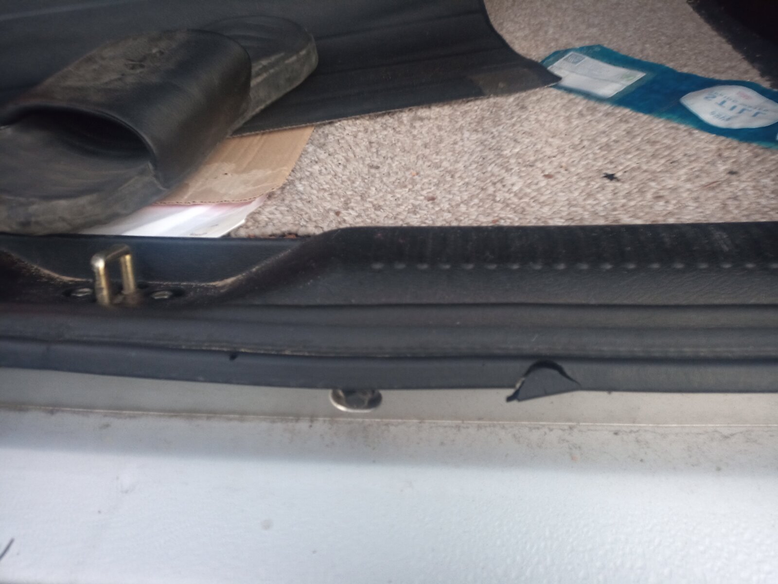

Got another issue to deal with....
There is moisture in the car. I checked all the door seals and the only one damaged was the tailgate seal.
The moisture is mostly appearing on the tailgate glass.
Do you think this is the cause?
