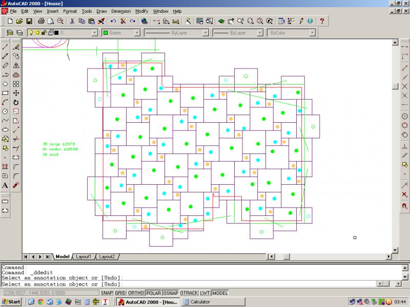

I would like to tile my kitchen using a 3 tile pattern, using 500, 333 and 165mm sq tiles. How big a grout line should I aim for? The lines will be various sizes as the tile sizes don't add up, a 333 and a 165 only give a 2mm wide line if they are next to a 500 tile, my planned pattern is below.
How big a notched trowel should I be using for a mix of sizes.

It's called modular pattern your looking at fixing...
Floor substrate?
As for grout spacing on a floor ..min 3mm...
If your as good as me then yes you can go done to 2mm...
For your first attempt at tile fixing mate....thick you better look into something more easier to tile...

The existing kitchen floor is concrete, and currently very cold. I want to have elec ufh so will be using a 10mm board. Rapid set flexible adhesive I believe? I thought about only using 6mm board to limit the overall increase in floor surface but 6mm just seems to thin for decent insulation properties. I'll end up about 25mm above existing concrete.
The tiles should fit well, starting at a set of french doors, tiles centered at the doors. The pattern is also to be centered down the middle of the kitchen so there is an even tile around the plinths.
Tile shop bloke says to make the 2mm gap 4mm by moving each by 1mm and having 6-7mm around the larger tiles. I'd rather have even gaps but tile sizes dictate uneven grouting.
