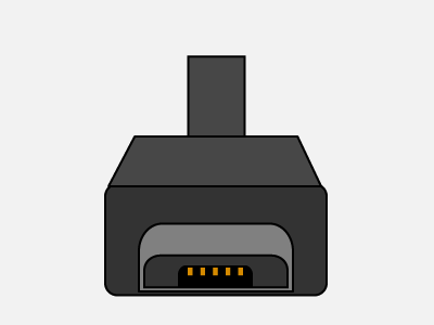

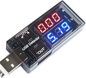

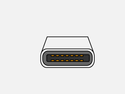

1655551863465.pngType C can be reversed, it was the type B micro 1655551953122.pngwhich only fits one way. I used some thing like this 1655552061585.pngto work out the problems when I had them, and it turned out to be the cheap leads from Pound World which were type B micro which was the problem, they did charge but at a very low rate, less than the phone was using. Just plugged in my phone and charges at 1 amp in the socket selected part of a 3 gang 230 volt extension lead. A USB lead connected to a LAP top can be charging as low as 0.1 amp, as said before my phone alerts me if charging slow, I have not found any charging at 100 mA but many at only 300 mA, some were due to using 12 volt plug in devices, it seems many cig holder units have a low output, but most due to the lead, most the Pound World leads I have now got rid of, but without the tester near impossible to work out which leads are which.

Eric is correct, it can be reversed - I had it in mind that the c was the the trapezoid shape plug.
