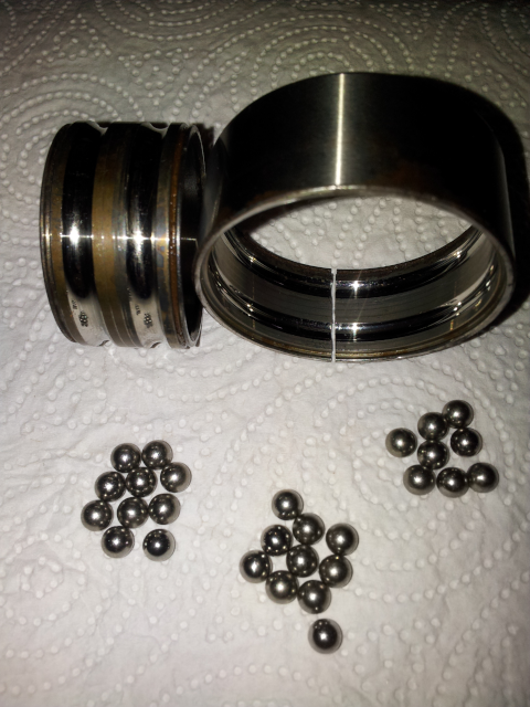

The old bearing was cut open for reuse as exact size bearing drifts. All the bearing balls were present and undamaged after prolonged use, indicating very good quality bearing material. The bearing had debris bulging under its shield. That might have been the cause of the aircon noise. It could be an assembly defect.
This type of bearing allows transmission of force from one bearing race to the other without destroying the bearing - useful in difficult installation/removal scenarios. There is no risk of the two races separating until most of the balls are destroyed.
Your picture shows the two races separated with all the balls present though.
Yes, you do have a sharp pair of eyes, not. Can you not see the outer race sliced up on the bottom side? I reckon you never won anything in a spot the ball game.
