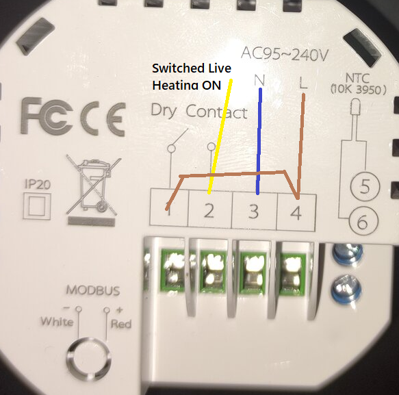

Can someone help me as trying to wire my new thermostat, I have enclosed a picture of my current setup and my new thermostat. I think the live is red and blue is neutral but not sure of what goes in the dry contact ports on new thermostat
Any help would very much be appreciated

Thank you very much bernard, I had read a thread from a few years ago that suggested similar but wasn't 100% sure as the person's setup was slightly different
Thank you very much for your help, you are a life saver
Might want to sleeve that earth wire and try and cut back the yellow wire so not as much copper conductor is showing.
your new stat doesnt use the earth so safely cut it back and terminate it, and as @Chris_W correctly says trim all those wires so the only bare wire is the part inside the terminals

I thought the earth wire was required for testing? At least that’s what sparks tell me :confused:
If ( when ) in the future you change the thermostat for something else you may need an Earth connection so do not cut the Earth wire too short. Put a sleeve on it.
Thank you, I already have a mounting box that has an earth so will put a sleeve on it and attach to earth connection
