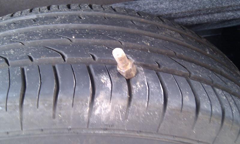

Friday coming back from Metro Centre, a very loud clattering coming from under the car. Pulled in, all tyres still inflated couldn't see anything, so I got down and looked again and saw this ;-
Very pleased I had a spare wheel (previous CMax only had a seal and inflation kit) Changed to skinny spare quite easily.
However 2 nationally established tyre businesses wanted £162 and £194 to fit new tyre ( the car is only 3 months old) I told them where to go. I then went to a local guy KB Tyres Houghton le Spring. Tyre repaired £10. Brilliant.
Now had the car 3 months and I am very happy with performance and comfort. A big improvement on the Ford C Max.It is like the C Max a 1.6 petrol and I am averaging 42 miles per gallon
I'm pretty sure that repair is bordering on the edge of legality due to its position, but I'd have done exactly the same as you!
