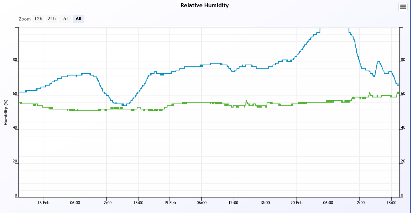

That's great, be interesting to know what readings you get?Cheers Dave, yes I have a couple of those sensors. I’ll move one in there and check the readings. Just struggling to envisage what insulation to use

Strive to keep surfaces above 14 degrees C, and absent any better option, encourage a flow of fresh air from the world (recently) through the room
Insulation wise, at least 50mm PIR board, joints taped, plasterboard over. Probably easiest to mount with plasterboard adhesive foam.

I'm certainly no expert but I have heard that some cavity wall insulation can cause damp problems. 65% humidity sounds a bit high especially if you say you've got a dehumidifier in the room.thanks again chaps, so the humidity reading in the room this morning was 65%
Should have mentioned the original house has been pushed out at the back where this room is and has a cavity wall that is bead filled.

Ok, that doesn't sound too bad as long as it doesn't go over 70%Yea the 65% was a morning reading prior to using the dehumidifier. I can get it down to a 50% range with
