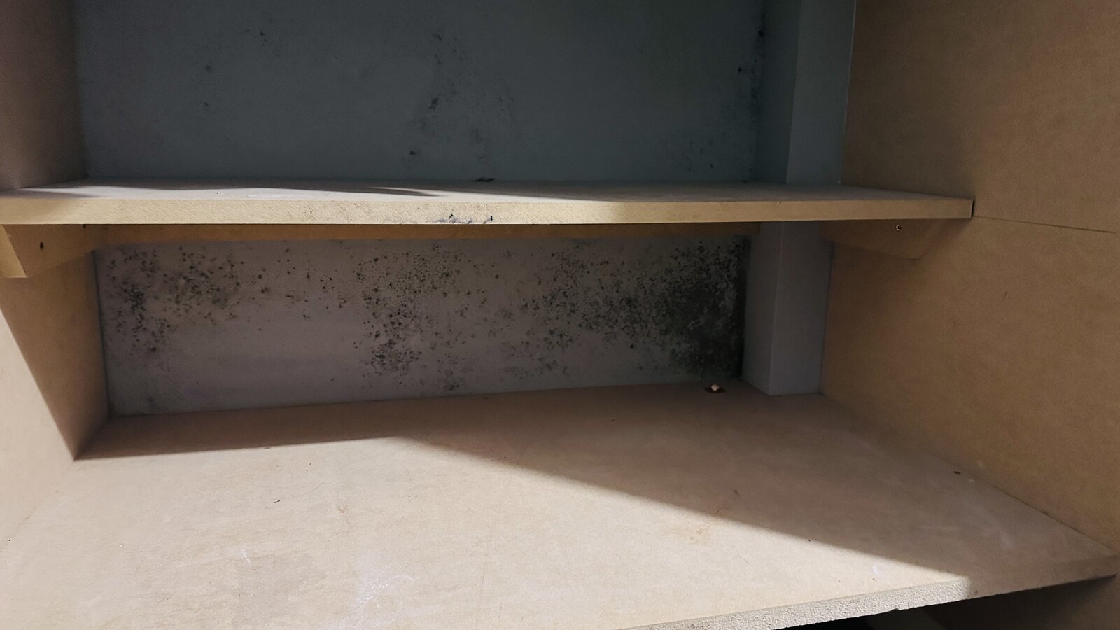

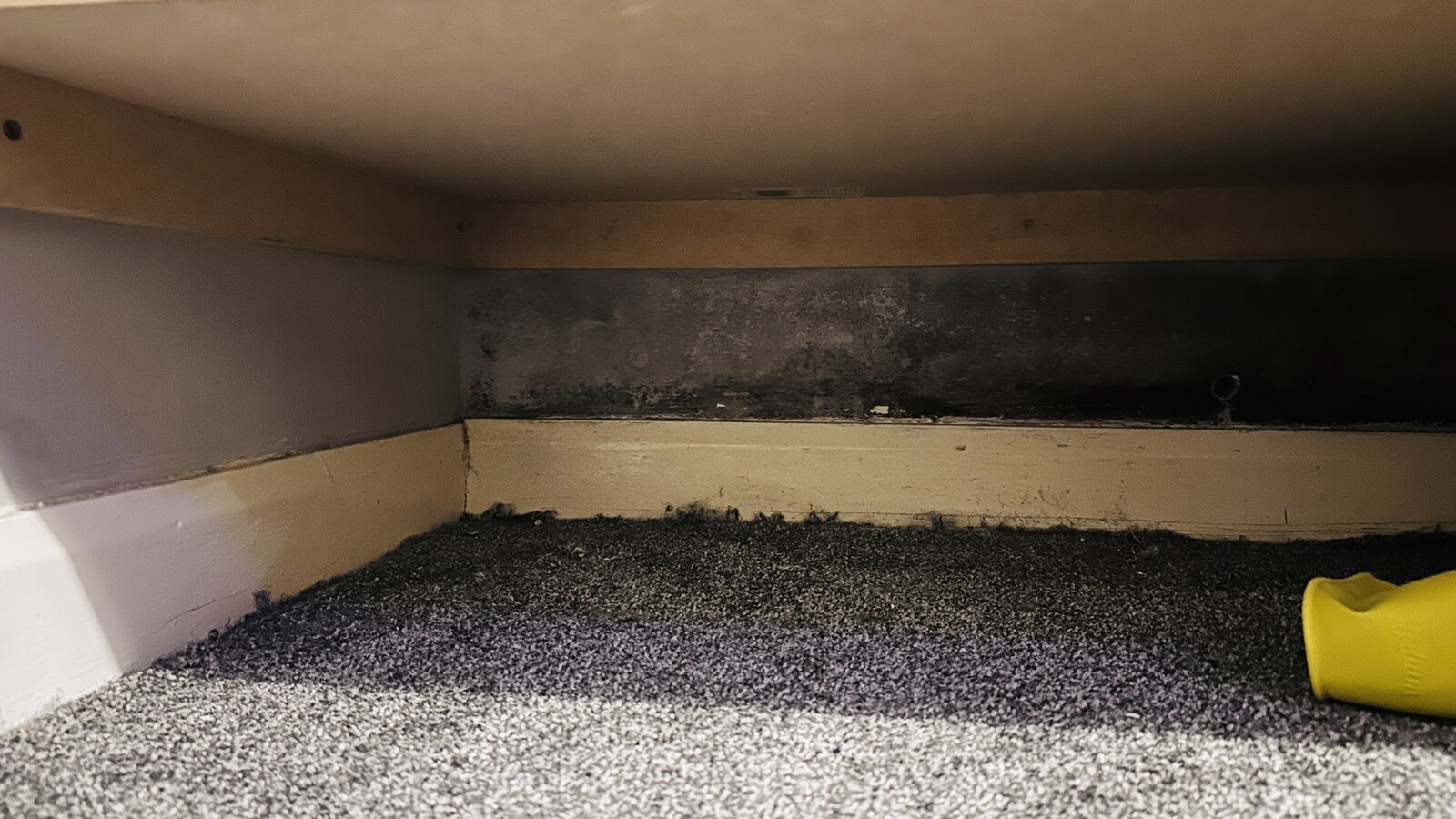

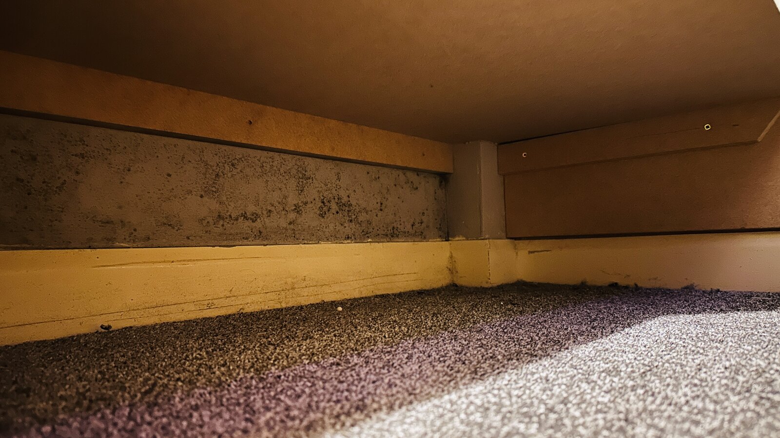

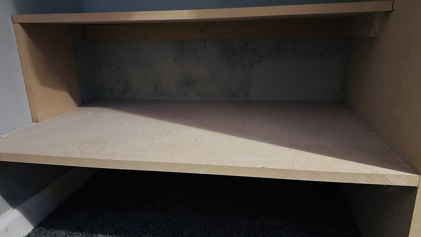

Hi guys, I wondered if someone could help me? I’ve recently moved into an old Victorian house that I’m currently renovating. I have noticed mould at the bottom of my son’s builtin wardrobe. This was cleaned off a few weeks ago with bleach and has returned.
I’m not 100% sure how to approach this. With it being the top floor is it more likely an issue with the roof or can damp rise that far?
Is there any benefit to damp proof paint?
Any thoughts or suggestions would be greatly welcome.
Many thanks

Absolutely not rising damp, probably it is the cold weather, moist air and lack of adequate ventilation.
Yes , ventilation prevents mould spores settling .Should have been constructed with a back not touching the cold exterior.(or insulated )

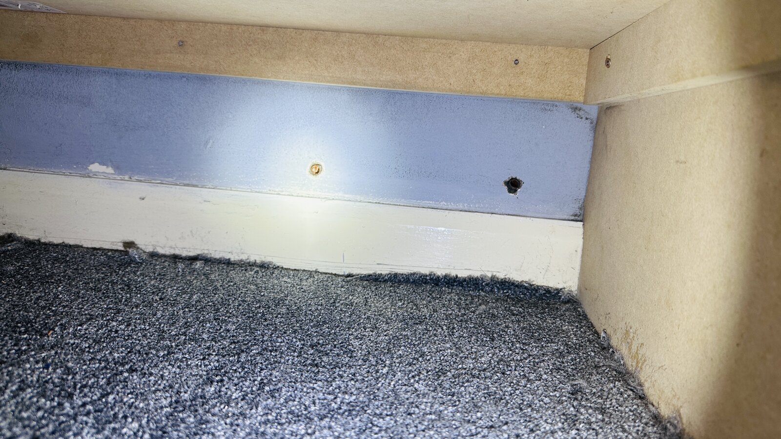

Thanks very much for the input chaps. Just had another closer look and spotted a couple of holes drilled that appear to have a bit plastic pipe in? I’m unsure if these were a previous attempt to remedy or if I should be filling.
Do you have any suggestions on what I should be doing? I’ve told my son to keep the doors open on the wardrobe and placed a dehumidifier in the room.
If I were to paint with a damp seal would that likely help?

Your mould is caused by condensation. This is extremely common behind wardrobes that are up against an external wall. Its not an easy fix. Paint, and it will return.
Only real solution is to line the walls behind with insulation and make sure plenty ventilation in the room and around the wardrobes...
Not easy when they are built in though....

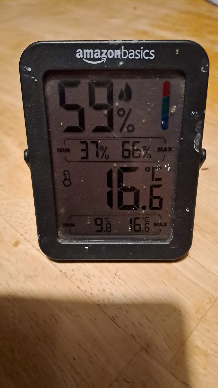

Dehumidifier is a good move. Also a cheap hydrometer to monitor moisture levels in the room/wardrobe. Must be kept below 70% humidity to help prevent mould from re-growing. A wardrobe with outside walls is a difficult area to keep mold free but as has already been suggested insulation should help.
