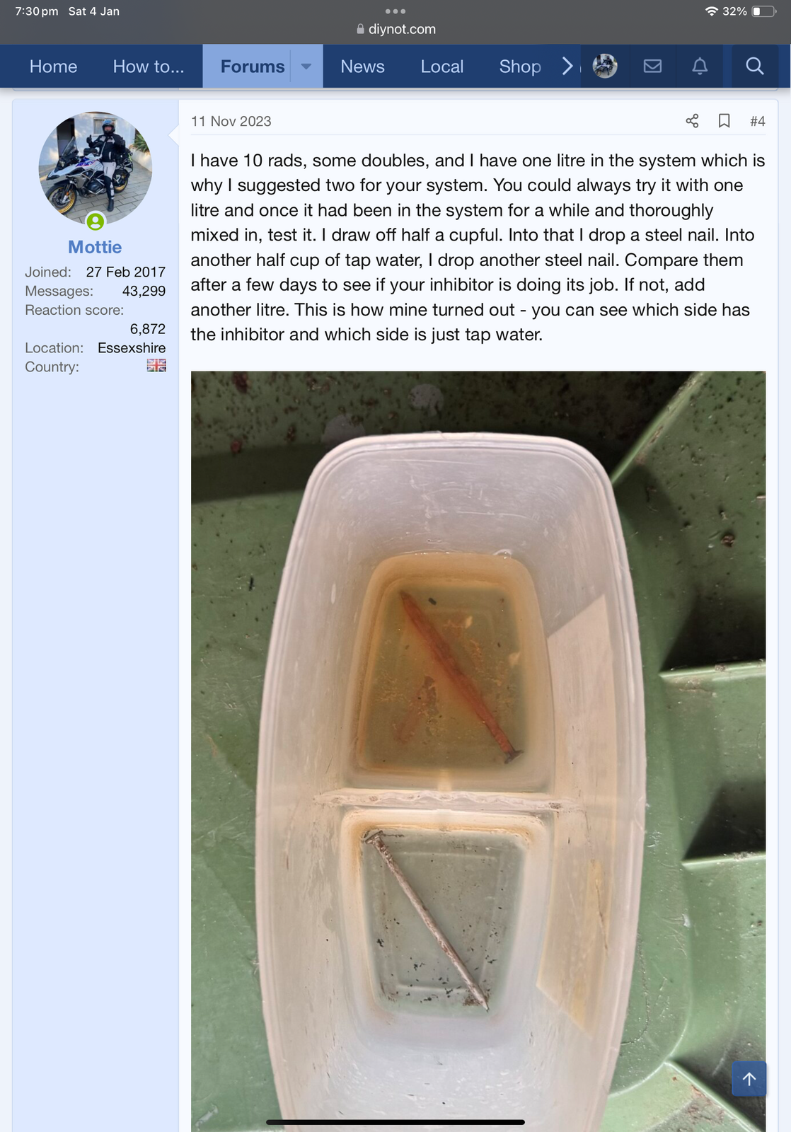

I've seen systems without inhibitor for years. Inhibitors do not magically vanish, it just degrades.
A good test is to drain a little water from your system and put half an inch in a container. Put half an inch of tap water in another container. Drop a steel nail in each of them and see what happens over a few days. The nail in tap water will rust, the nail in your central heating water should remain rust free if the inhibitor is doing its job.
