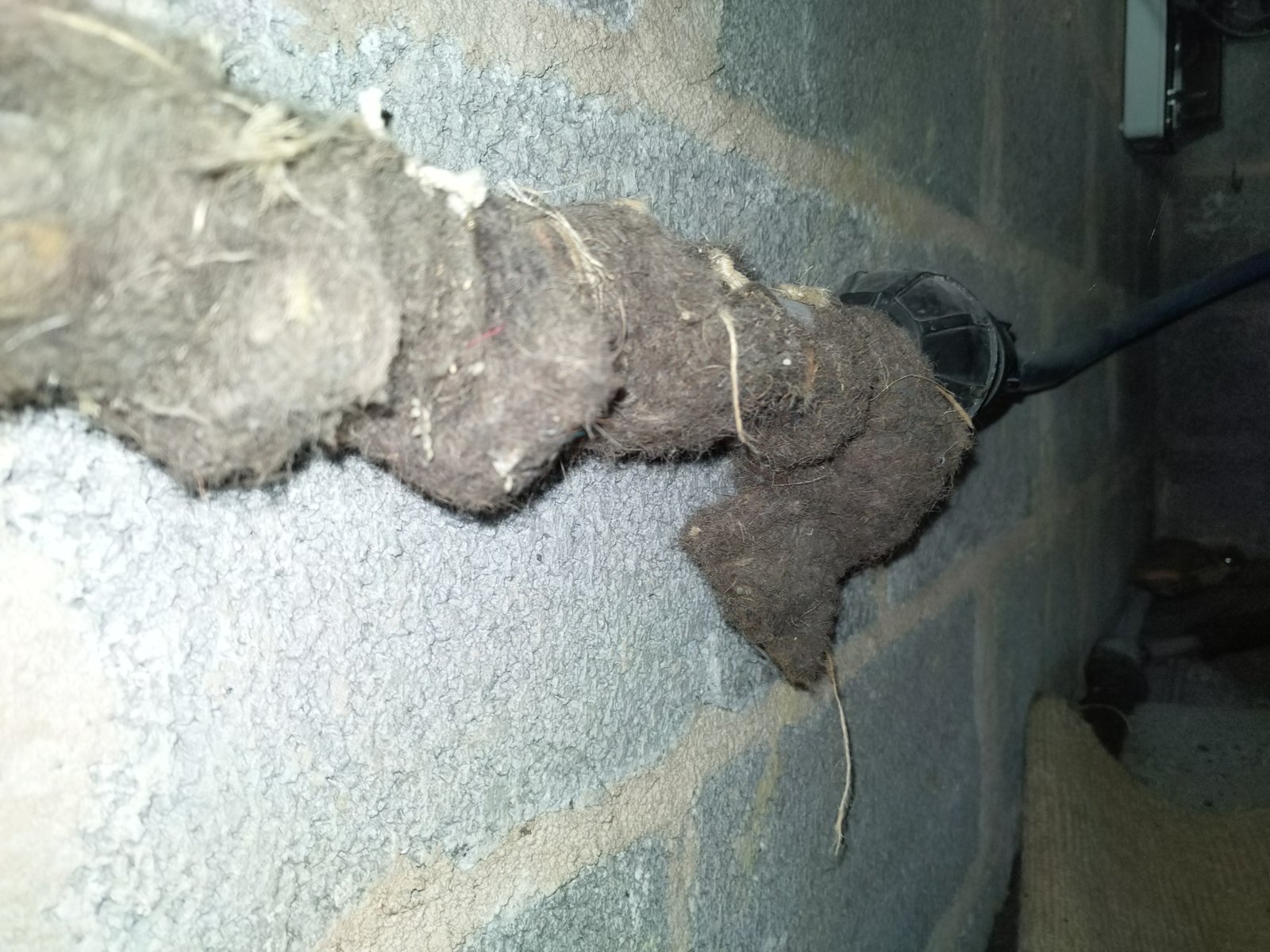

More unidentified pipe lagging in my undercroft. Please see pic below - what is this stuff? Any chance it contains asbestos? Or is it some sort of mineral wool? Any advice welcome!
That's hair felt - no asbestos (y) One of my first jobs (1972) was putting that stuff on the pipes in an Edwardian house undercroft. It's good now that "hot working" is not allowed - a small flame near that stuff, and it will run along the whole length - as my co worker showed me , out in the open !
Thanks again Nige F, much appreciated. I'll avoid getting any flames near it!
