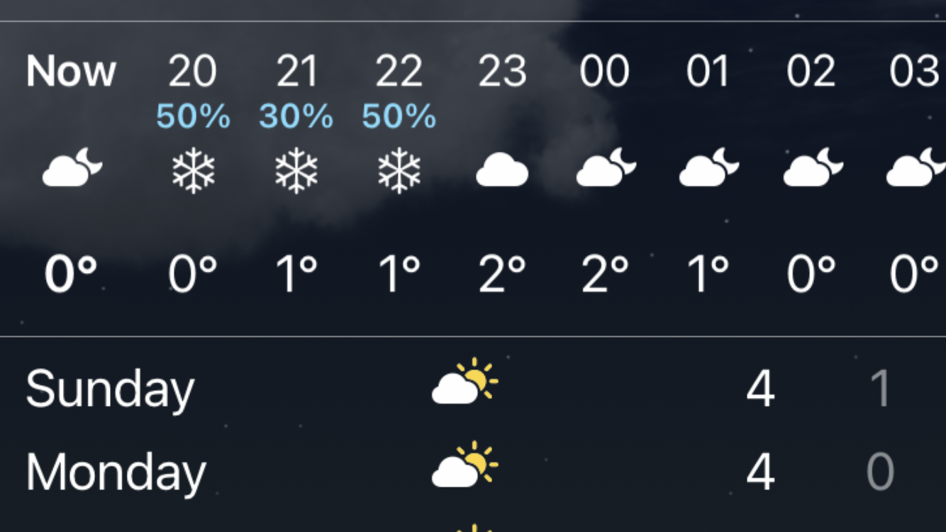

I’m looking to mortar down 21 medium dense building blocks to concrete piers (already set) in the ground for my garden building tomorrow.
Checked the weather forecast and it’s 4 degrees tomorrow and drops to 1 degree on the evening and 4 degrees then next day to 0 degree in the evening.
Do you think this presents an issue to the mortar setting?
thanks
3° and rising normally.
But "in the ground" may provide some insulation, depending on how deep.
The concrete is level with the ground and the concrete blocks would be sat on these laid on a bed of mortar.
I’m could have these laid in a couple hours in the morning but don’t know how long to would take for the mortar to cue and what impact the temp would have on these during the night.
temp is 4 degrees during the day but drops to 1 degree at night and then up to 4 degree the next day.
Surely if it’s 3-4 degrees during the day that counts as 3 degrees and rising (before it starts dropping again) then cover it up well afterwards? I was planning the same tomorrow if it doesn’t rain/snow

I’ll see how cold the blocks look in a bit, but agree it’s borderline. Trouble is it’s the mildest best day for about 2 weeks apparently!
A plasticiser helps deal with any potential problems around 0°c. For lower expected temps, use an accelerator or frost-proofer additive.
Or cover the work with some insulation, if practical.
Start early, after it starts to warm up.
I’ve got a few courses of engineering bricks to lay and some (soaking wet) 7N blocks on top. Worst combo in this weather, I’ve bottled it today. Will do it when I’ve got a chance of getting it jointed nice the same day when it’s still light :)
You might want to let the engineers go off before laying the blocks.
Cover the blocks or move them to a dry place to dry or unfreeze. Water may be frozen in them, even so, it will all run downwards when you come to lay them, and mess up the joints or add to the risk of freezing - a layer of ice between the mortar and block as well as frozen joints.
