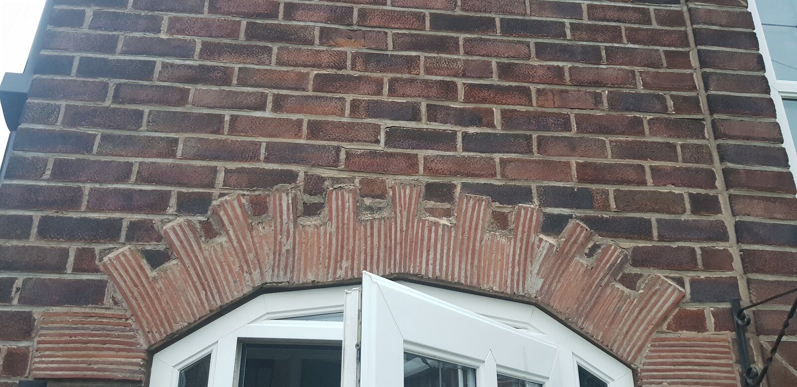

Mortor cracks above archway
26 Jan 2022
12

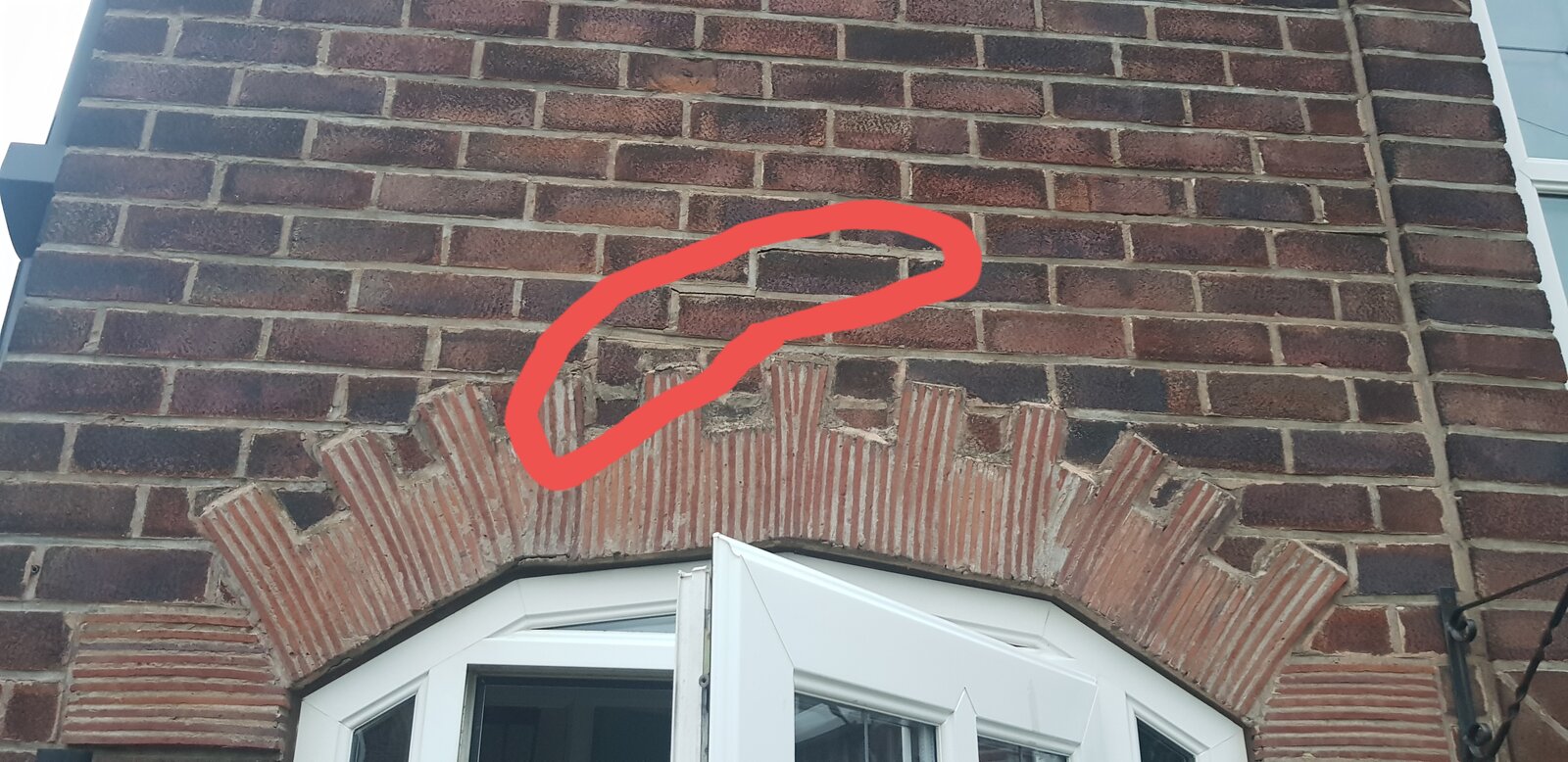

Our upvc front door has been sticking for a while and i noticed a crack in the mortor joints above the brick archway above. I have filled it in for now to prevent moistyre from gwtting in but hiw should i go about gwtting this fixed properly please? Do i need a surveyor and BC, or just a competent builder to sort out?

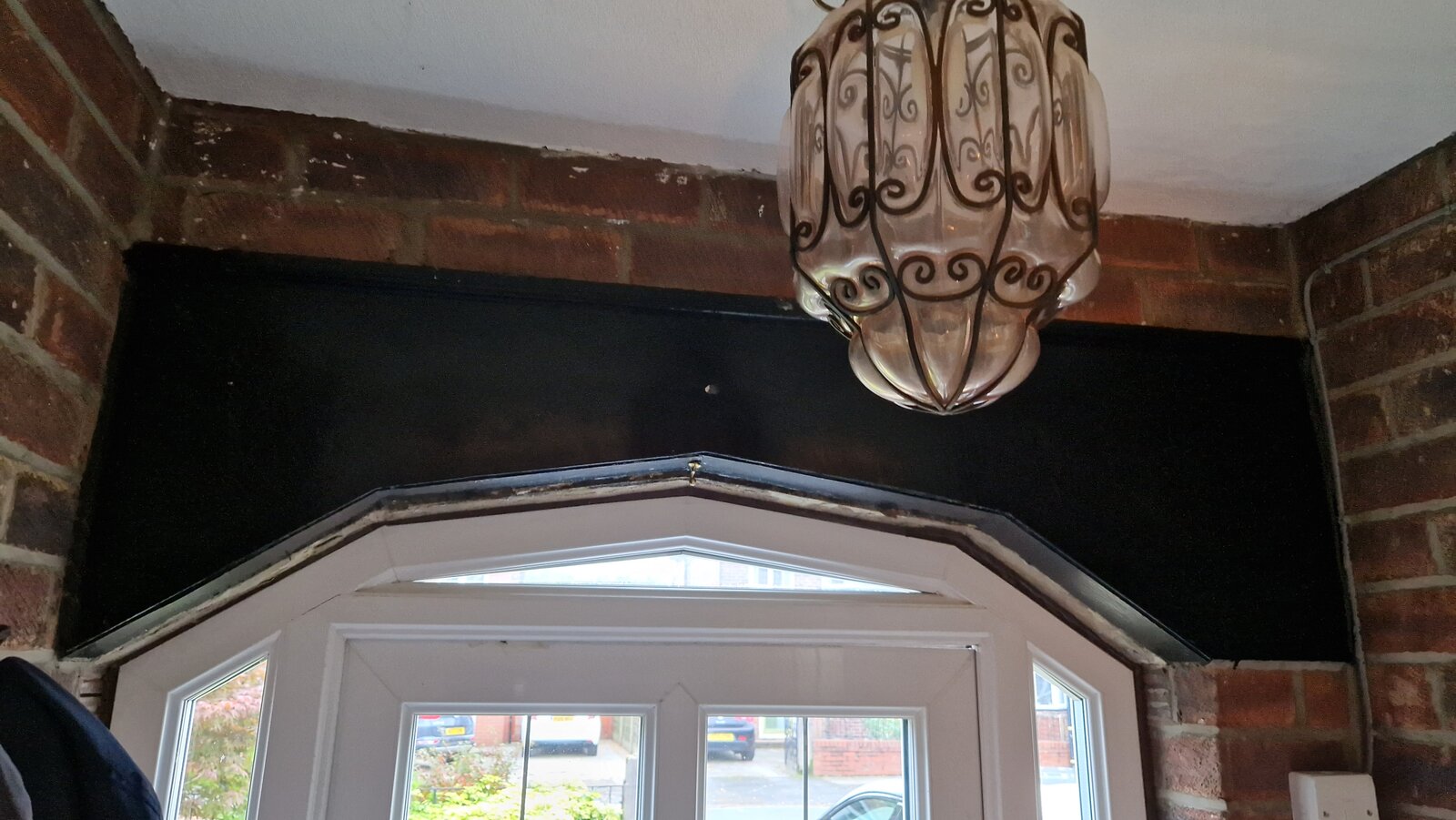

Not sure. This is it from the inside.

Holy Jezus! That is one ugly feature that will have twisted the melons and sanity of any self-respecting bricky. Who ever came up with that chaotic mess, must have been sniffing glue.
Instruct a structural engineer to diagnose and devise a repair.
It may require reinforcement to stop further movement, or in the extreme, rebuilding of the arch.
A builder won't know the correct repair for the specific circumstances, just what he did on the last similar job.
