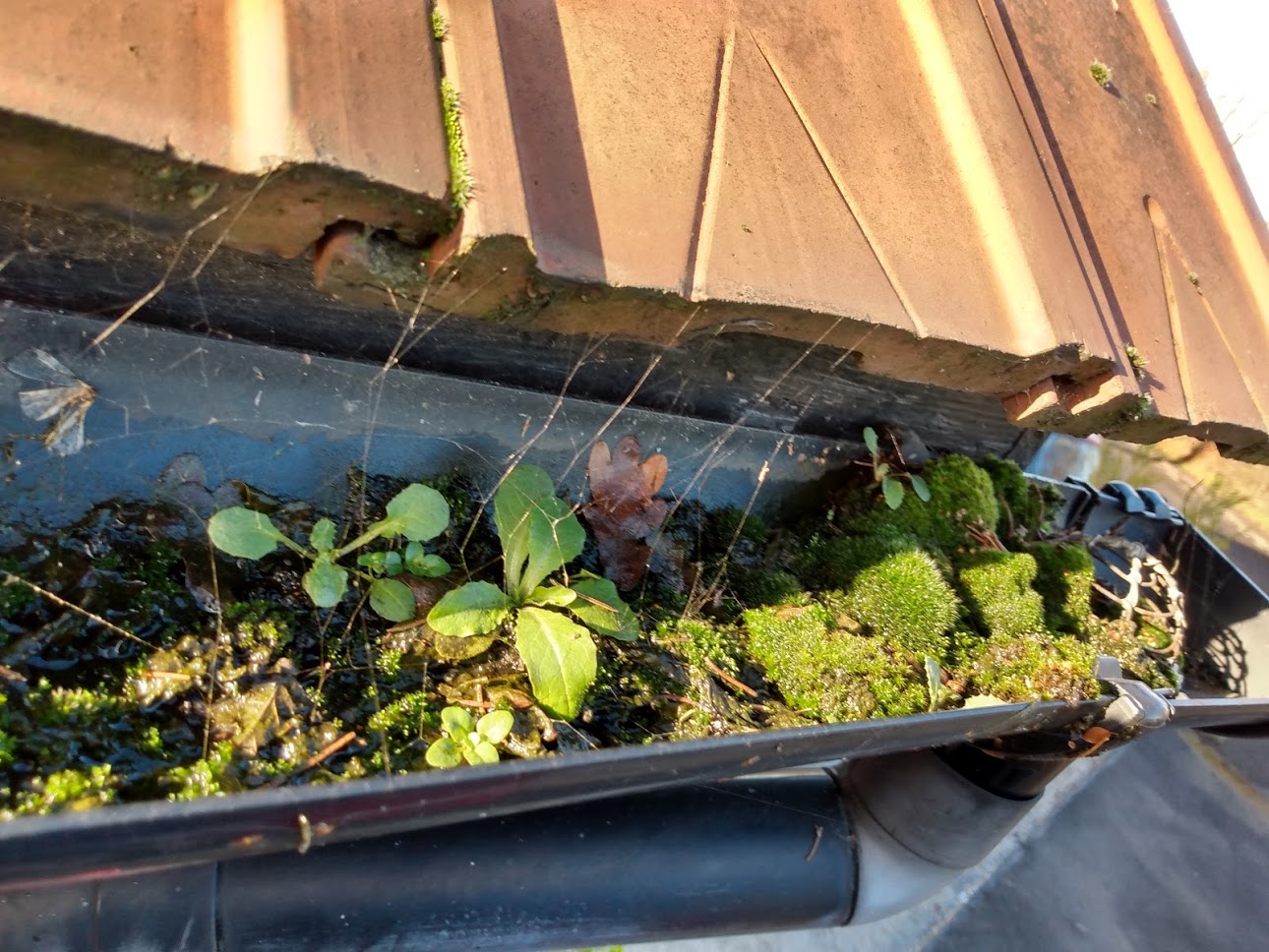

the greatest damage moss can do is blocking gutters -so put your money towards having them regularly cleaned out.

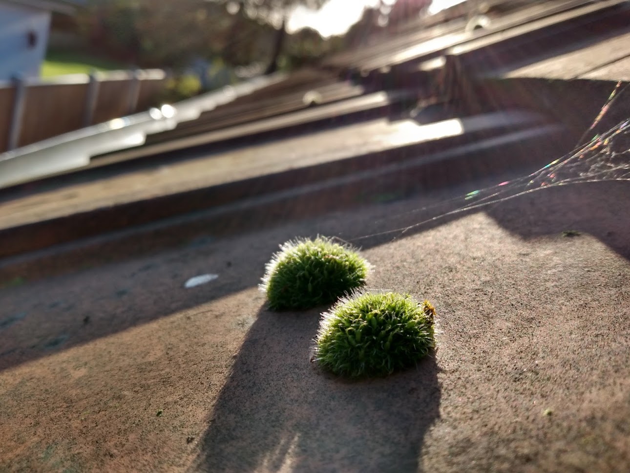

I'd focus on keeping the gutter clean, and maybe installing one of those leave / moss catcher things.
I cleaned my gutters out this year, had loads in as sometimes the moss rolls off the roof and lands in the gutter.
I left these two there, they looked happy.
Moss's have sex organs so those 2 could start breeding if not careful.
