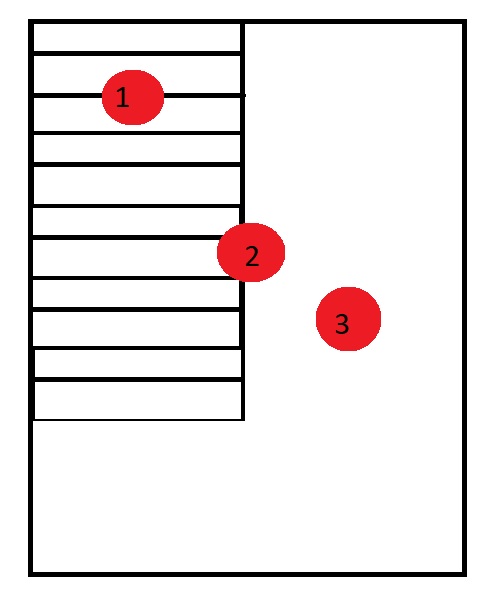

Hi all.
When it comes to fitting a smoke alarm on a landing which postion would you consider it best located?
Currenlty it is in positon 1, however I was wondering whether 2 or 3 would be more effective (there is another smoke alarm in the hallway at the bottom of the stairs).
Many thanks

I would have thought they are all equally effective. You're overthinking it, it's smoke, it will drift around in the breeze...
Okay then, what would be the standard position you would put it in?
Probably 2 or 3, since access to the ceiling over the stairs would presumably be less straightforward. make sure you comply with the manufacturer's recommendation about distance from walls etc.

Not merely manufacturer's instructions - there are explicit requirements for siting in BS 5839-6 (assuming domestic, otherwise BS 5839-1).

Position 3, so that people are actually able to reach it and press the test button.
Fair enough, but I would imagine that if they could reach Position 3 (with or without standing on something), they could equally reach Position 2. As I said originally, it's really only Position 1 that might well create access problems.

None of you experts has mentioned the location of the alarm must take account of the locations of the bedrooms.
There’s no point having an alarm going off at night if nobody can hear it!
So, need a better dimension plan of the landing, with locations of rooms and doors.

As long as it’s a regular 3-5 bed house, a decent smoke alarm, mains or long life battery sited anywhere on the landing ceiling, 20cm from walls will be fine. Not in a recessed loft hatch or anything daft. Make sure it’s tested every month. Position for this is important. Right over the deepest part of the stairwell is gonna lead to lack of testing.
Smoke will very quickly reach the whole ceiling and set it off. One on each level of the house.

Thanks guys for the input, no worries on that score as an alarm is going in every room (interlinked).
In that case, any position that is convenient and consistent with the manufacturer's advice and instructions (which I feel sure will reflect relevant Standards and regulations) would be fine for the landing one. As I and others have said, the main thing to avoid it siting it somewhere where, because of difficult access, it probably would not be tested as often as it should be.

And if they can't reach the ceiling without standing on something, or if it cannot be guaranteed that there will never be a time when someone who can't reach needs to, #2 might worry them.
