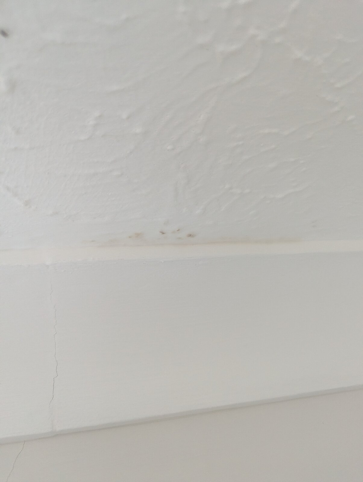

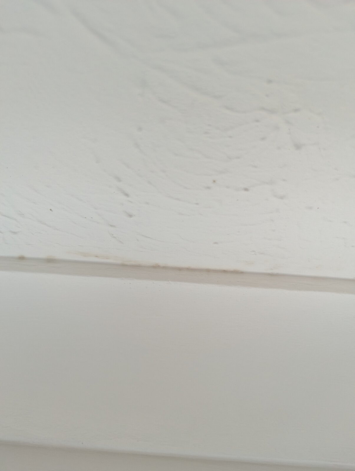

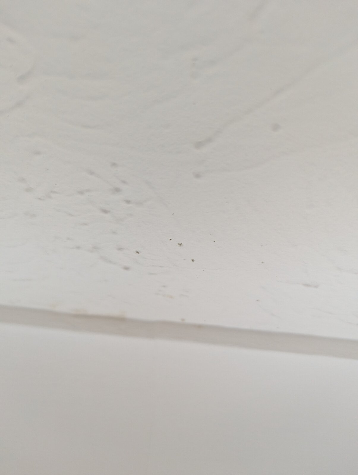

I have always had issues with mould in my houses. I have just moved and been in the property for a month, there was no mould in the house/bedrooms but now mould is starting to appear around the ceiling where it joins with the coving, generally on the window side of the room.
I have a dehumidifier and when putting this on it show 55 humidity as a norm. I open the windows during the day regularly and put my windows on the vents at night. I really don't understand why it is appearing and feel it must be something I am doing wrong as the homeowners didn't have the issue before. I have sprayed HG mould spray on and it disappeared however is slightly coming back on photos.
I have just bought Zinser Perma White Anti Mould in the hope this will help.
Does anybody have any suggestions on how to improve.

Put the central heating up or massively improve the insulation
The patch of ceiling is probably cold due to a lack of loft insulation. (assuming room is an upper bedroom)
No point having a dehumidifier running with the window open.
Insulate. Even if that means something as drastic as fixing rigid insulation direct to the ceiling joists.
The junction between the wall and the ceiling (upstairs) is one of the most vulnerable parts of any home, in terms of cold bridging. It all makes sense when you see an eaves section drawing of a house at this location. At this point in the building, there are only a few inches of poorly insulated construction between you and the outside, especially when you consider that some older houses may only have 3" deep rafters.
Turning the heating up won't help unless you keep it on constantly. Moist air will always cool at this junction unless it is adequately insulated.

Adding adequate thickness PIR insulation will solve it instantly.
Applying the Zinsser paint after cleaning is good, but check if you are adding extra moisture by drying clothes inside, or if large furniture is blocking airflow to that cold wall.
Thanks all. So there is no furniture blocking. We have clothes on a heated airer regularly in another room but always have the windows in that room open and door closed. The bathroom doesn't have an extractor fan but again we have window open when showering and door closed. I am due to check the loft installation today to see what that looks like. I have condensation all over the windows every morning.
