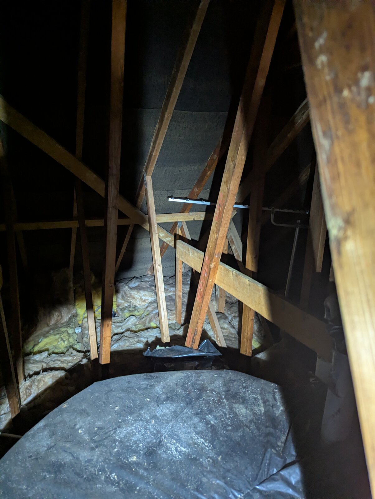

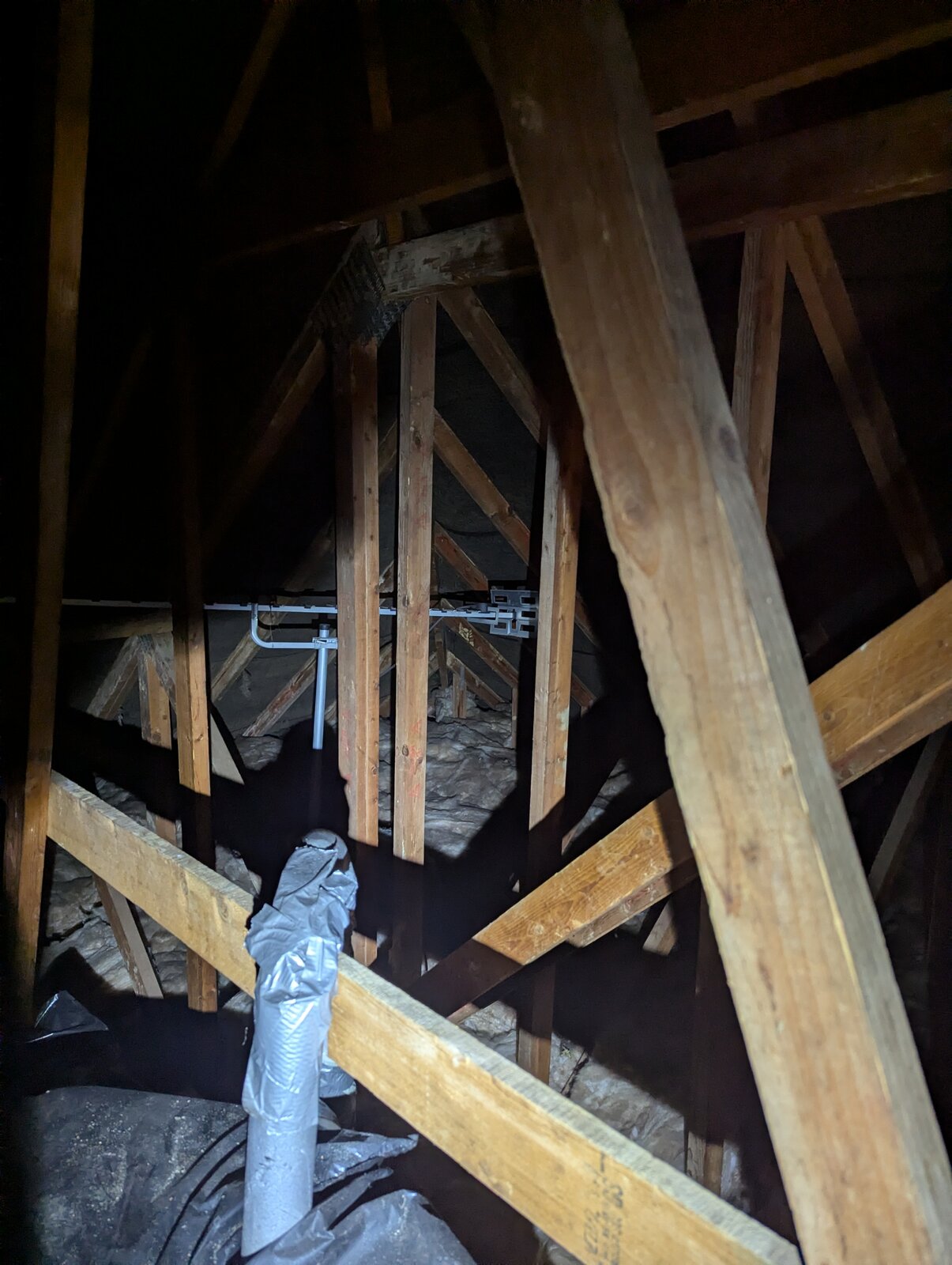

Thanks for all the help. I have lived in the house for 2 months and there was no mould before this and the couple before that lived in the house over 30 years didn't appear to have this issue which to me points to lifestyle. I have checked on the loft but couldn't get in far enough of that helps show if I need more insulation or not?
I will look to not dry clothes indoors now, put kids on the saucepans at all times and look to get a PIR/humidity extractor fan installed. Do you think it could still be loft insulation?
Mould, needs moisture, condensing on surfaces to grow, and so good insulation of those surfaces is one factor. The insulation you have, appears to be quite deep, in your photos, so should be effective. What about the walls, are the cavity, are they insulated?
