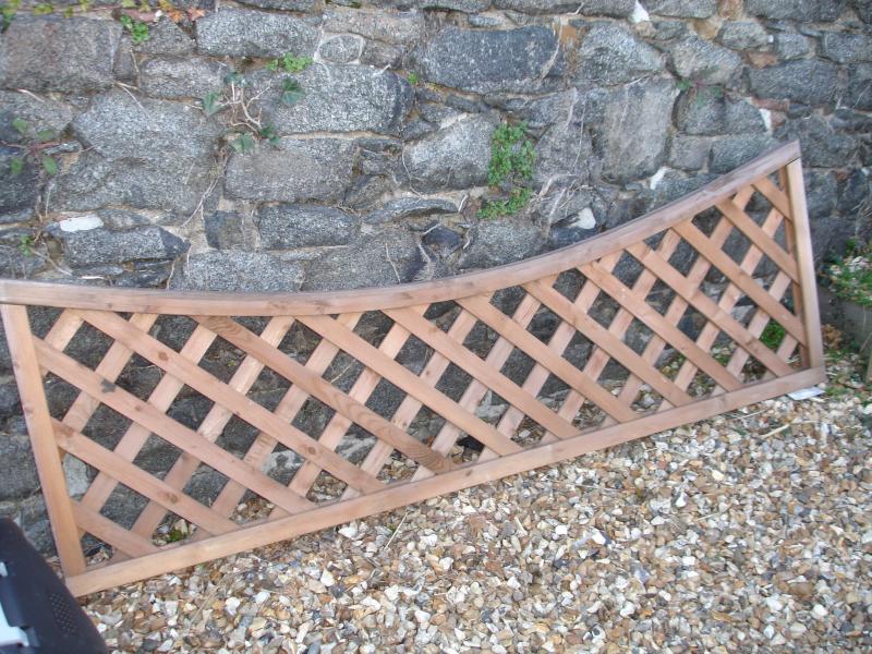

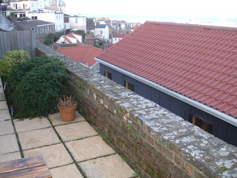

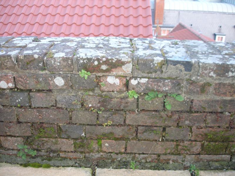

I have a very low wall on my patio which on the other side of is a steep drop, to make this safer I am wanting to mount a series of fence panels shown on the picture, but at the moment I have no idea how to to it and have bought all the panels! I am also unsure if the bricks look reliable enough to hold it as they look quite worn
I have included photos of the wall and panels in question so if anyone has any advice at all I would be very grateful!

I would buy some 3" x 3" posts and fix them to the front of the wall and leave the posts long enough so that they accommodate the screening trellis.

I appeciate your comments, drunks are the main cause of concern!!! The Panels are actually a lot studier than the general trellis so think it will probbably be ok. Your advice is good and seems a good way to do it, but what would I use to secure the posts to the inside of the wall?

Fix them with expanding bolts. Don't fix to the top course of bricks, but at least one course down.
Katy - as soon as you erect a fence folks will assume it's OK to lean against it .... ahhhhh, splat. So to prevent to splat part the fence (ballustrade) need to be made from stout timbers or better, from steel. You can then cloak this steel (or timber) structure with your trellis.
Fix the structure to the inside face of the wall with long bolts going all the way through to the other side; fit speader plates or really big washers. This assumes the wall is in good condition otherwise after the ahhhh, splat will come rumbling and squashing sounds.

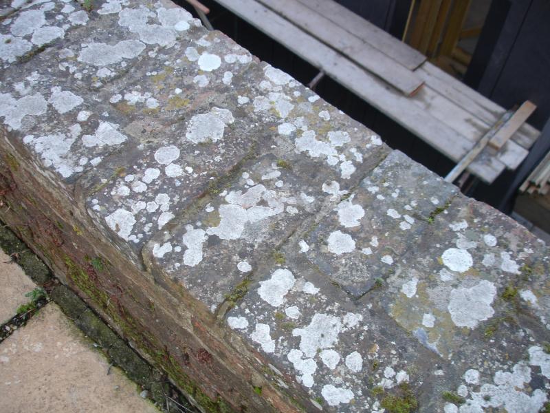

The wall looks a bit weathered and needs some repointing in any case.
But that looks like one hell of a drop to have lived with for such a long time :shock:
hi,before you have anything festened to your wall,it is worth having the wall made safe 1st,as it is full of mold and weeds growing tells me it is full of moisture,this will cause problems on its own,you are just adding to it,also throwing money away.

Yes the drop is pretty scary, its not as bad as it looks as the house infront is half below ground but could still do you a lot of damage. We bought the house last year and have been so unsure about the condition of the wall and how to make it safer we haven't been able to do anything about it. I think as MhTiler commented my first priority is getting my wall checked out. Is a builder the best person to do this, as I wouldn't have a clue whether or not it is at all structually sound! In the mean time I will invest in some mattresses to place on the other side!
