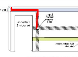

Hi all,
I am going to change the way the door open and I need move the light switch. There is no space in the other wall so my only option is to move it a meter away so the door does not interfere.
How could I extend the cable of the light switch to the new position? I was hoping to use a one to one conector for each cable and chase the wall to the new switch location.
Any suggestions would be great. Cheers
You can do as you propose, following the green line, BUT you will have to put a blank plate over the existing switch box.
You cannot run the wiring horizontally and then plaster over the old box.
Cables must run in zones (effectively horizontally or vertically) from a switch or socket so that others know where cables are/should be.

Why can't he do a joint, and plaster over??
The existing switch is within 150mm from the corner, and the new cable will go horizontally.
Assuming the current switch cable is within 150mm from the corner (which it appears to be), then all will be in a wiring zone.
The only thing left to think about, surely, would be HOW to join the cable so it can be plastered over safely and correctly.

If the existing cable is in tube, you may be able to replace the cable, to avoid having a joint in the plaster.
I didn't think of it either, BUT -
could it be that neither of us thought of it be because it is not really a corner; more an edge (with just a pretend door frame)?
Also, would anyone in the future think it is a corner and there might be a cable there?
