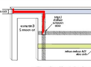

The existing switch is within 150mm from the corner, and the new cable will go horizontally.
Assuming the current switch cable is within 150mm from the corner (which it appears to be), then all will be in a wiring zone.
The only thing left to think about, surely, would be HOW to join the cable so it can be plastered over safely and correctly.
That's what my original idea, but was not 100% sure whether I could do that. The cable comes from the ceiling vertically to the current location. I guess the location of the switch is a corner. Can share another picture of the room.
If I were to do this, how could I join the cable so I can plaster over safely?

Red in-line crimps, covered by heat shrink (not tape). You will need to re-strip the ends pf the existing wires, as they will be all squashed up.
You will need a proper crimping tool, not the rubbishy ones.
No doubt someone will have a picture.
The coloured insulated wires will need to be covered in heat shrink too.
It would also be idea to cover the cable with conduit or capping before plastering over.
