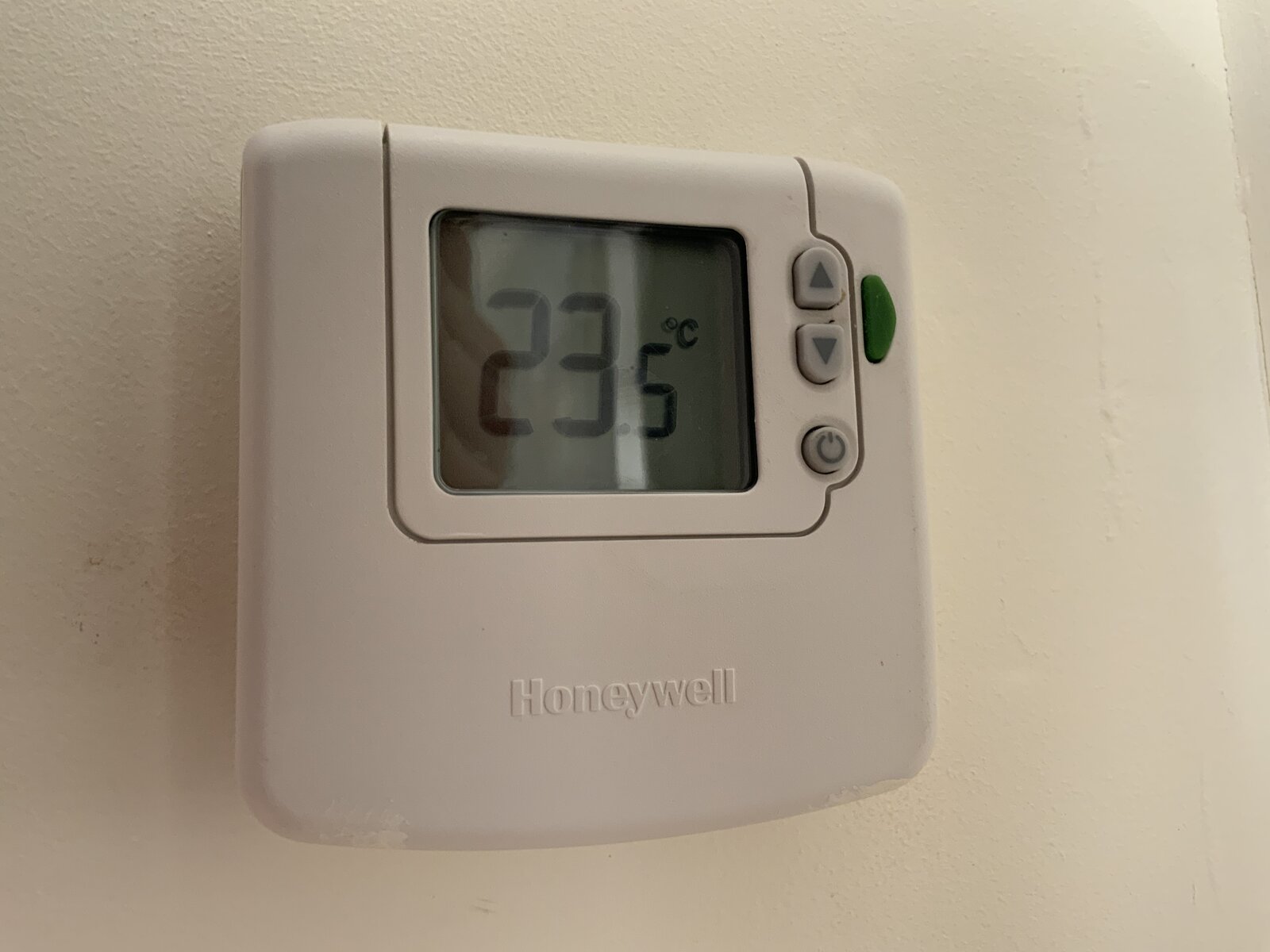

I imagine that the thermostat shown below would have 2 or perhaps 3 wires. If that is the case, what problems might I encounter if I moved it from the living room into the hall. At the moment we have an extension where all the radiators have thermostats fitted but in the older part of the house the radiators do not. This means that when the thermostat in the living room reaches the set temperature the flow from the boiler to all of the radiators in the house stops. A friend suggested that moving the living room thermostat to the hall would alleviate this problem.

View attachment 205001 Doing that and changing the thermostat to a digital one should make the room temperature a lot more stable.
