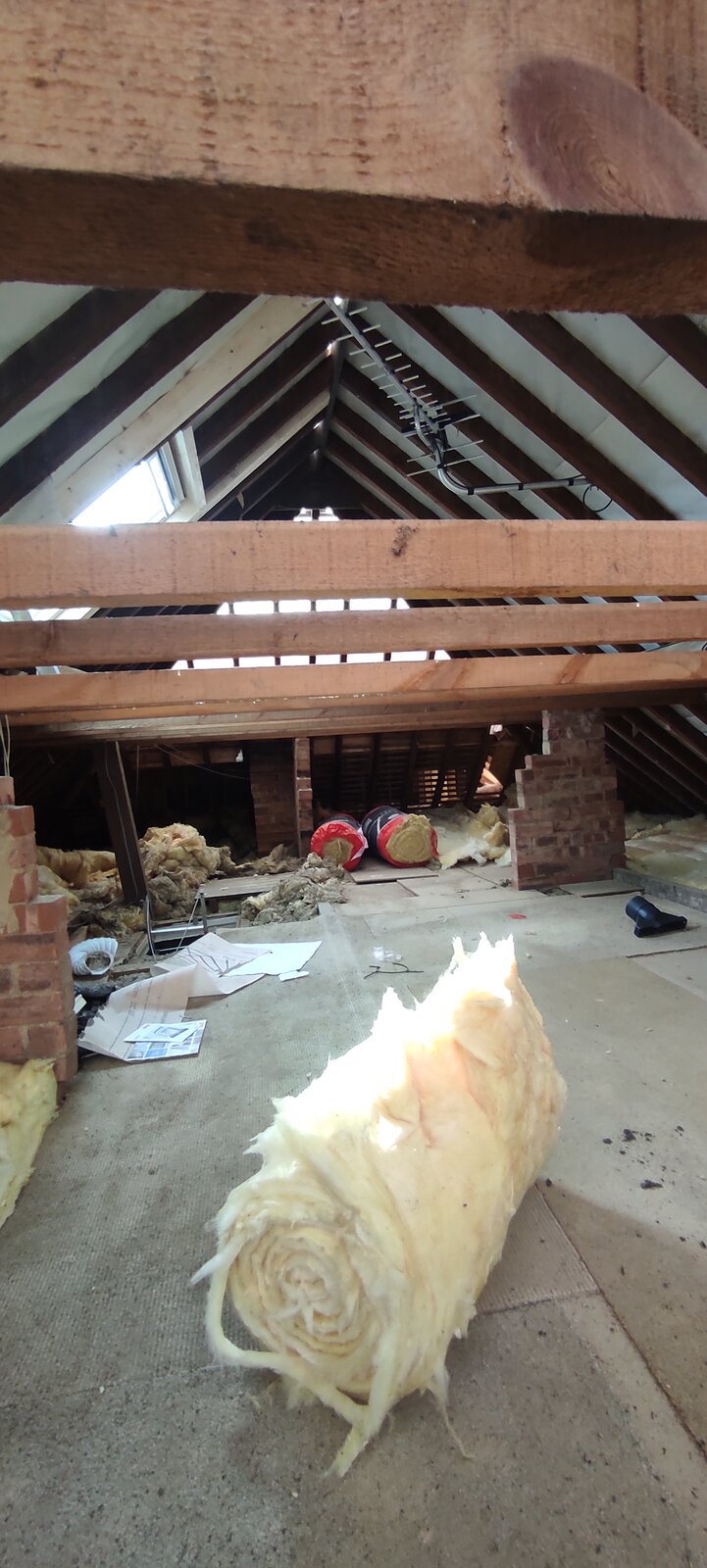

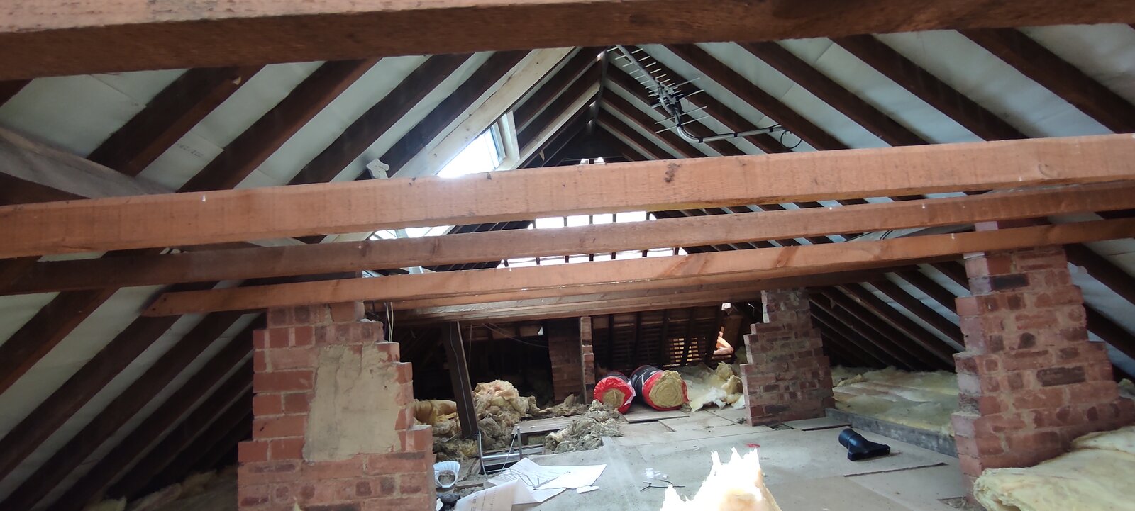

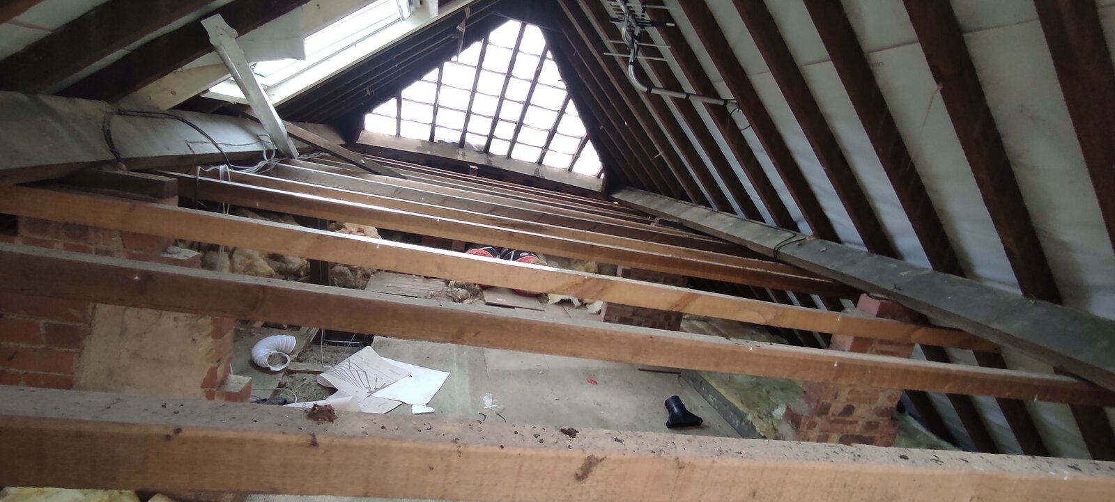

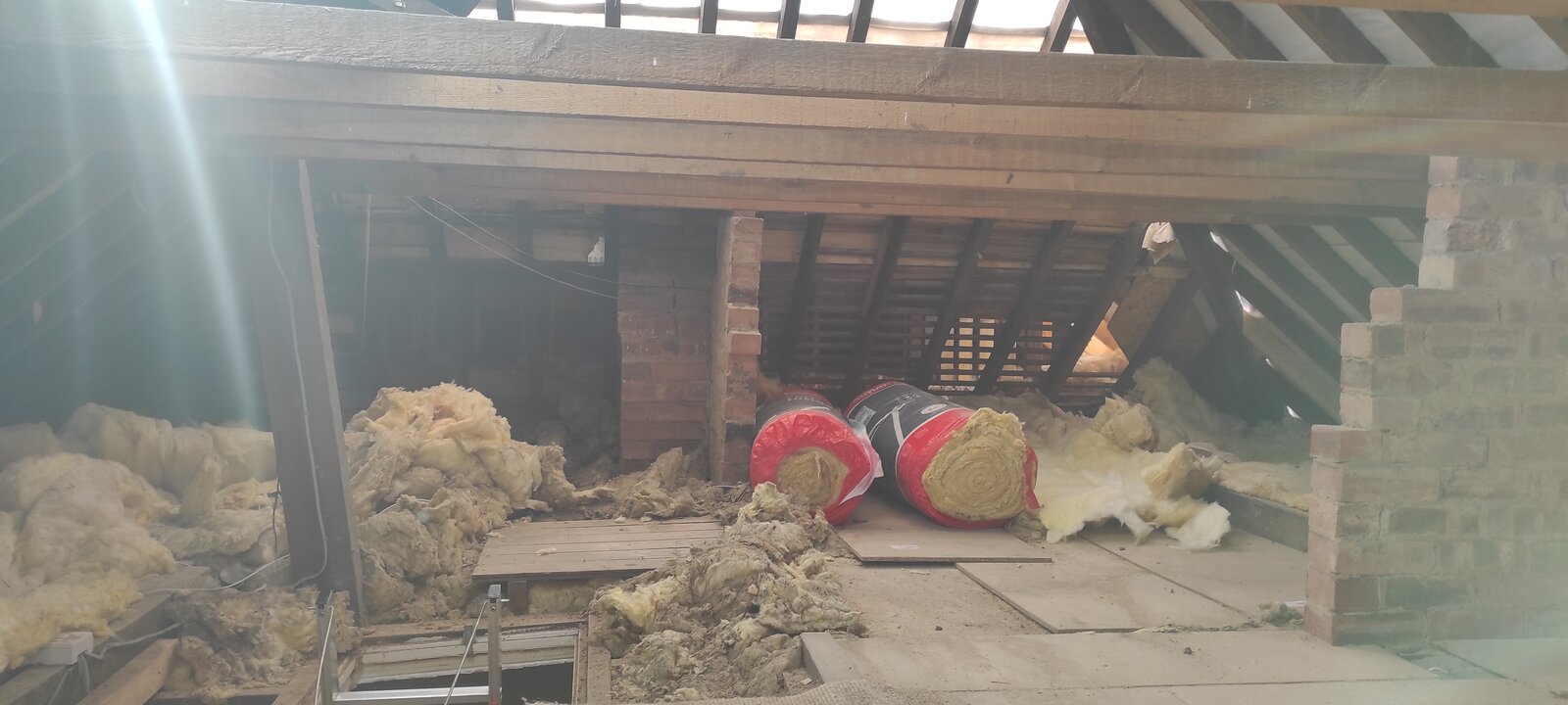

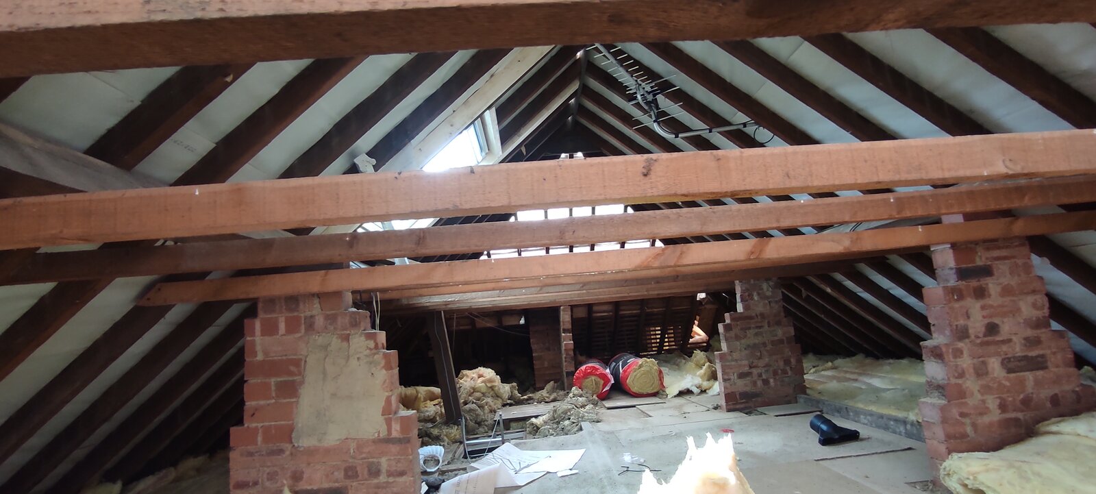

Hi all, I'm looking for some advice on moving some beam in my loft to make the space a little more useable. It lends itself to a loft conversion but is cost prohibitive at present.
It's a 1930s roof which we are having replaced due to leaks and dust. The loft has beams across every rafter 4.5m in length at a height of 1m. The top of the roof is 2.7m.
I read somewhere that collar ties van be anywhere from 1/3 to 2/3 of the height meaning should be 90cm to 1.8m. if I can move to take each one off and move to the highest point it would make the space more useable.
Have I understood what I read correctly or is there something I'm missing?
I've added pictures which hopefully are useful.
Thanks in advance

Maybe its best to leave all your roof timbers alone - there has been previous work, possibly remedial work for whatever reason(s): dont mess with it.
It would be possible to re-build the loft & roof under the direction of a SE.
IOW's a fully engineered loft conversion. But you are already having the roof cover replaced?
FWIW: why not get a SE in for a heads up - contact them with an email attachment of the above pics.
You'll need a structural engineer to do some number crunching and give you a proposal, it matters not what you have read online or on this forum. Except this post obviously. :p

Thanks, We decide to have tiles and felt installed and also sort out gutters and facias as it was just tiles which meant it was dusty and we had a few of leaks. That's going on now and now we can see the space better had thoughts on the space inside.
