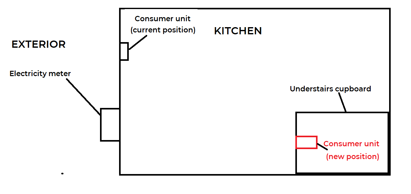

Hi all,
I'm looking for some advice.
My consumer unit is in a really awkward place at the moment. It is on the kitchen wall. I'd like to move it if possible because we are having a new kitchen put in and it's not aesthetically pleasing.
I have attached a crude drawing of the consumer unit and where I intend to place it.
As I understand it, if the consumer unit is moved more than 3 metres away from the meter, a switched fuse must be installed. Is this correct?
Looking at my drawing, how would you go about moving the consumer unit?
My thinking is that I run the tails and earth from the meter into a switched fuse unit and place it where the consumer is at the moment (the switched fuse unit can be boxed in with an access door).
I then run SWA from the switched fuse unit outside and then under the floor to the understairs cupboard where I intend to move the consumer unit.
I'd appreciate your thoughts on this.
Many thanks :)

Since the work is notifiable, you need to decide first if your using a scheme member, or going down the LABC route. And you need to get who ever is signing the paperwork to agree as to where it can go, although at one time under the stairs was common place, today it is not so common and of course there needs to be a route for the cables.
It really does not matter what any one on the forum says, it is down to guy doing the work and if LABC route the LABC inspector.
Have you planned how all the other house wiring will be re-routed to the new CU position?

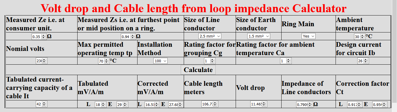

There are maximum lengths for cable runs, the first step is to test the cables to see if they can be extended, a 2.5 mm² ring final has a limit of 106 meters for example, sounds a lot until you realise how cables have to run to comply with rules on drilling beams, so a low ohm ohm meter or a loop impedance meter is required. These tend to be expensive and so not normal to find as DIY tools.
I find the calculations rather complex, so as a result I use a java script program to work it out for me, this shows maximum readings.
for a ring final, it is the correction factor Ct which is the complex bit, I used Java Script so it would work on my phone, until you have taken the readings and found out if it can be extended or if heavier cable is required etc, it is a non starter. It may be that your well within the limits and you can extend without a problem, but you need to find out before you start, not after completed.
You often say this, but I'd be interested to know how many electricians have actually dealt with a ring final in a 'standard dwelling house' that was anywhere near 106 metres. Even in my (very large, certainly not 'standard') house I don't think that any of my final circuits are anything like like that long.

Hands up, yes I have in the past done it wrong, at that time it was 80 meters when we had 4% now we have 5% for most and 3% for lights so it has allowed the 106 meters. But I was lucky I was not caught, I know I did it wrong, but I got away with it.
