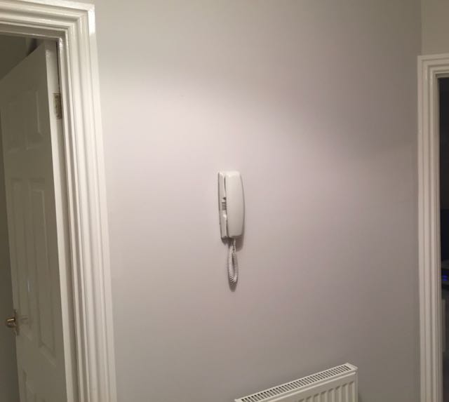

The intercom handset for my building front door is stupidly placed in the middle of a wall where I want to put a mirror. Would I need an electrician to move it for me or would it be quite simple to do it myself? I have attached a picture.
Photograph all the connections, and annotate where every wire goes, before you do anything else. If there is more than one wire of the same colour, mark it.
Good idea to have access to cupboard where the control power supply is before you move handset, just in case you blow fuse ? As that could effect the whole door entry system.
