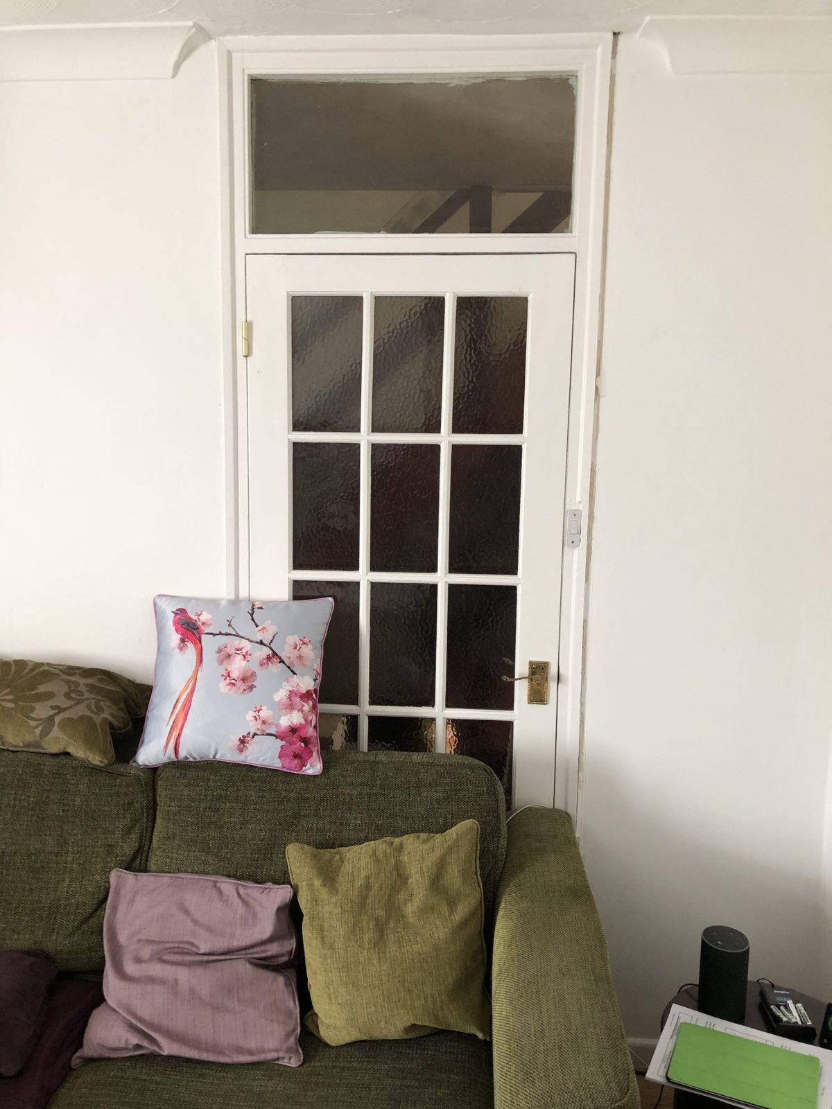

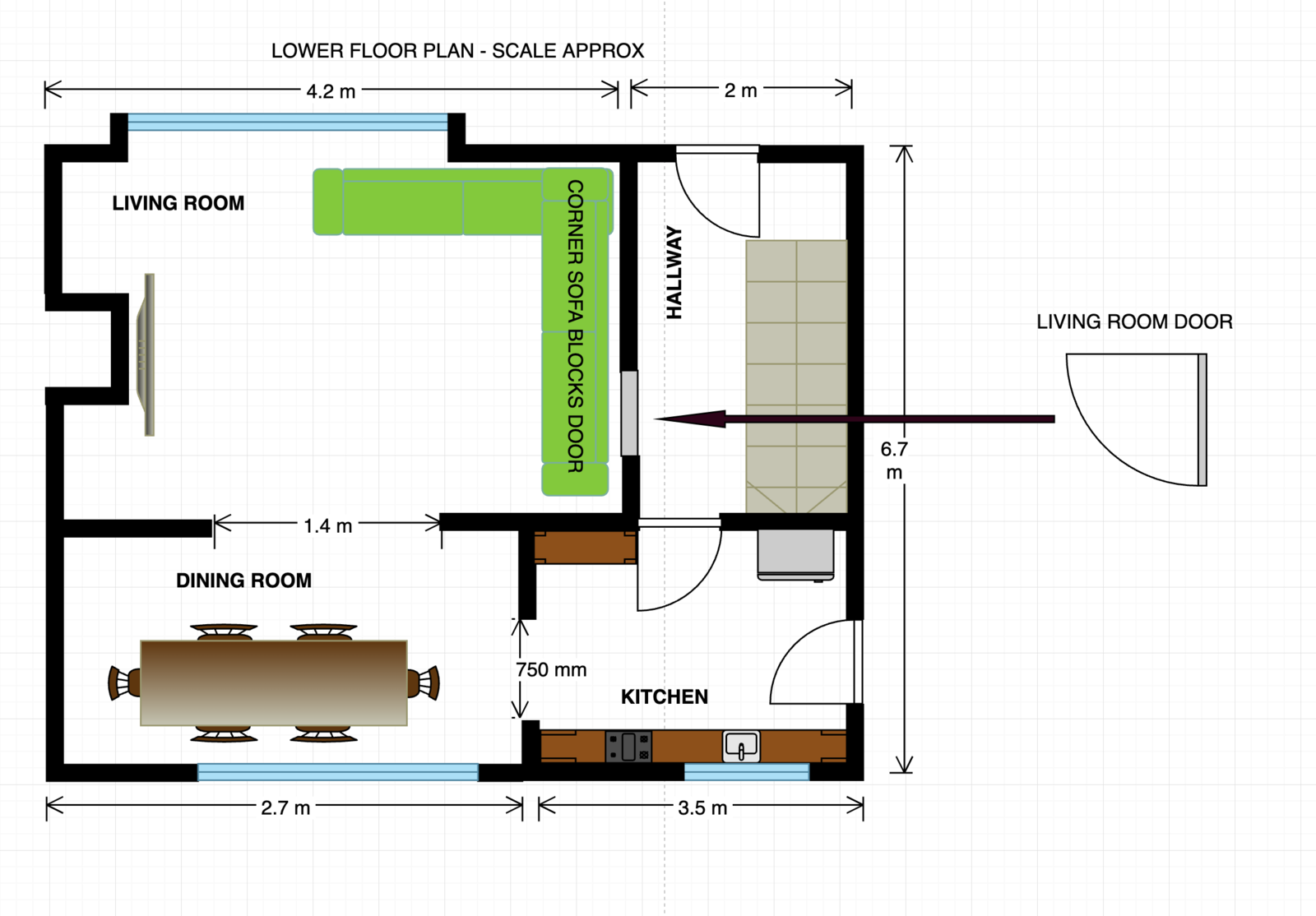

You might be correct - however corner sofa blocks off the door already ;)
Which in itself is possibly wrong but there is little control of fire escape routes in domestic situations.
How quickly could you do a full evacuation if your dining room and kitchen were engulfed in a major fire?
Personally If I were your landlord doing an inspection I'd instruct you to clear the access/fire route.

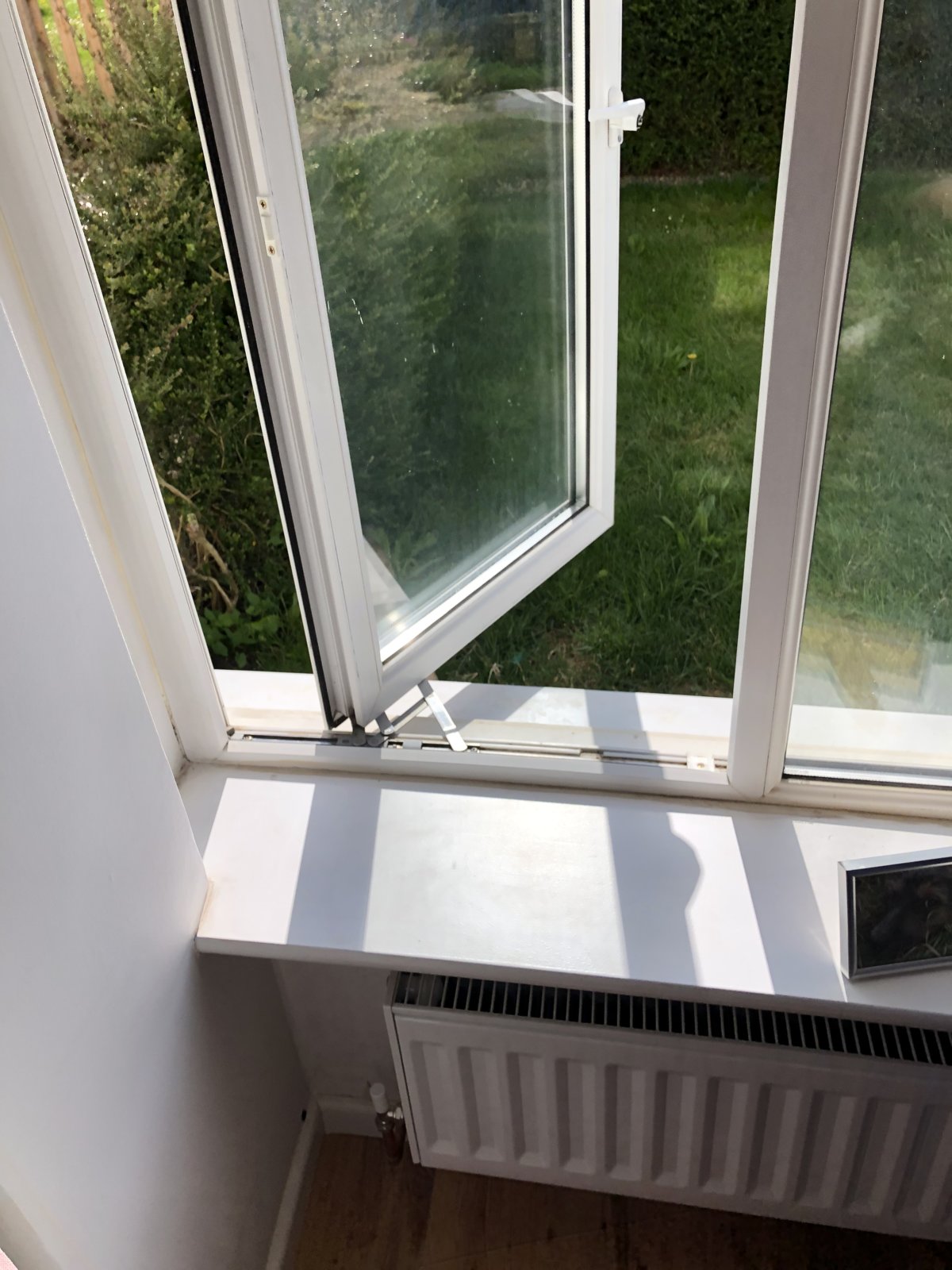

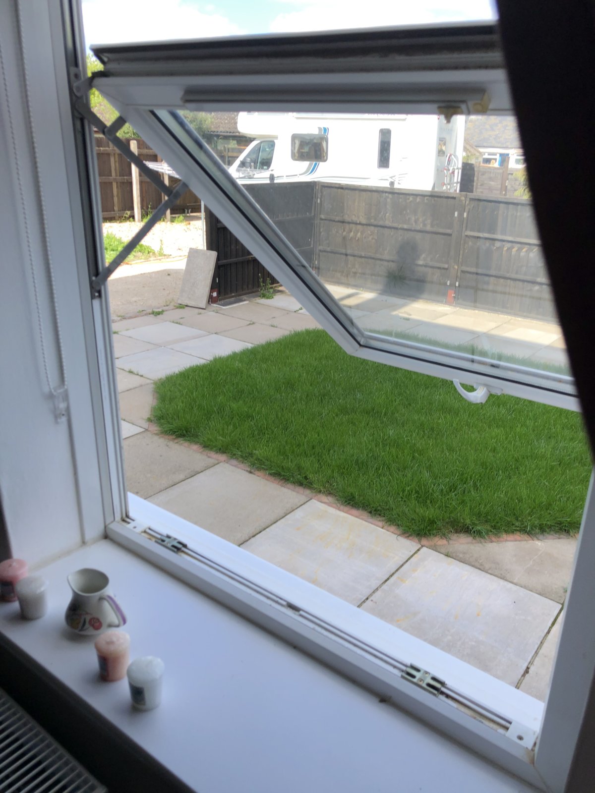

It looks like neither of those windows will be acceptable as fire escapes in their present format
I agree, try climbing out of them in the dark ( often in a fire the power is tripped out as cables burn )
And if were acceptable but are locked.... could the keys be found in the dark and panic ?
The windows are the same upstairs, so the whole escape issue is the same throughout house.​
No particularly polite way of saying this, I can't believe you are ruining the iayout of the place just for a corner sofa.
Since living here we have never used that door. There has always been a settee of some form across the door. Maybe Furniture Village will give me a 2.5k refund ;)
In that case call you HA and ask them to put it right, you should have at least one additional escape route and the window installers will have known that for a rental property.
I always ask for all of the upstairs windows to be escape windows. The additional cost has only been about £5 per opener and well worth it for peace of mind.

In very basic terms[and to be honest this may be out of date] there should always be 2 escape routes ideally from every habitable room but certainly from each floor, there is presumably only one staircase so arrangement should be in place for at least one window to be big enough and open wide enough to get through unhindered and in a hurry, either to jump out or to be rescued. There are height stipulations which from memory is something like 3ft above floor and 14ft drop maximum and a minimum opening area which I can't recall.
Quite often this simply means different hinges such that the window opens on one edge [rather than sliding along as in your pic] and when pushed fully open the hinge shouldn't be in the way. I'm not sure why, I assume because they can drop down on you, but technically top hinged windows are not suitable for escape.
