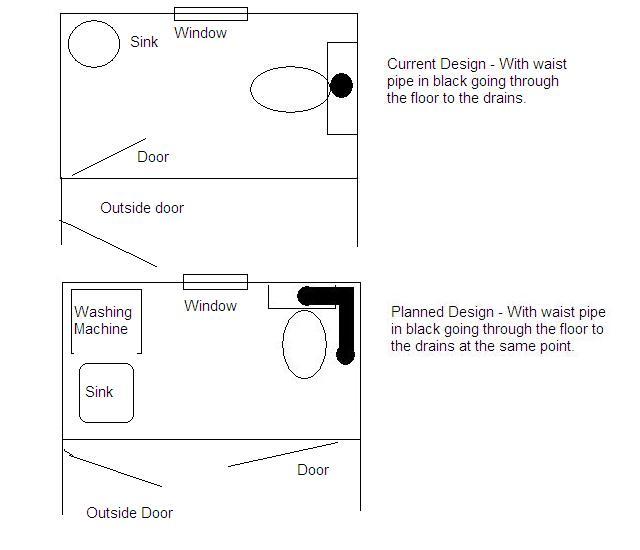

Moving of Toilet when waist pipe is set in concrete

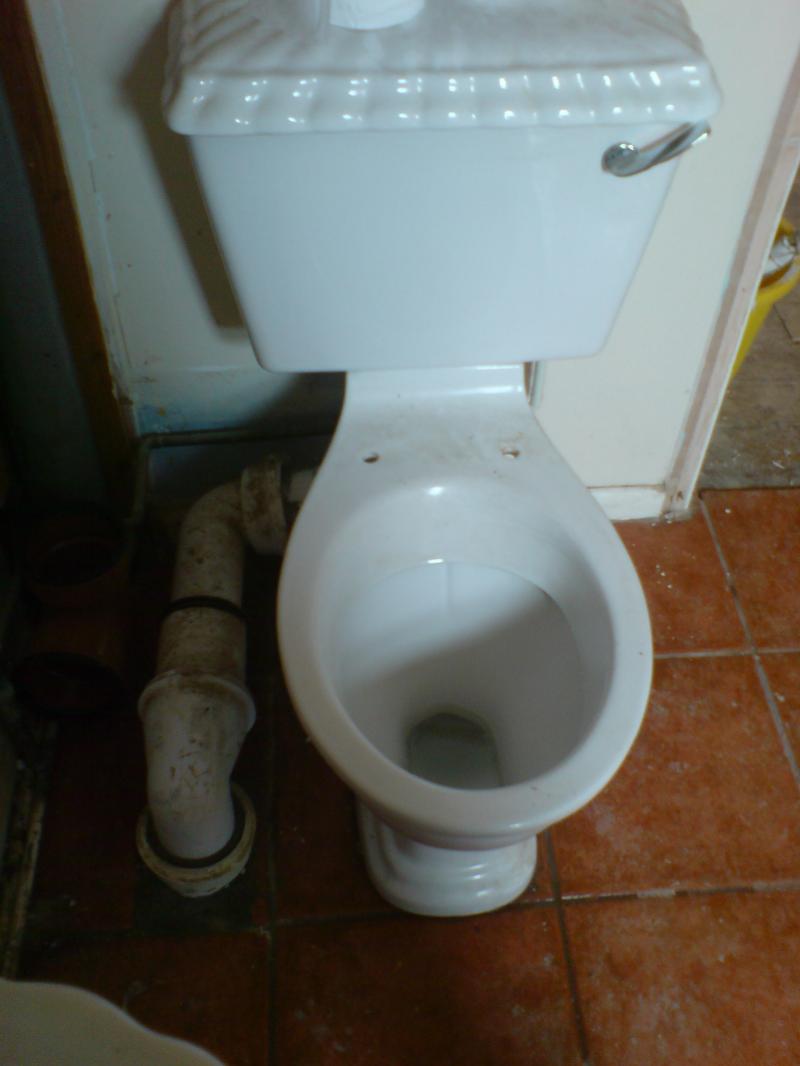

another question so sorry for this.... but what is the underground fitting that could connect the toilet (from the wall e.g. curved down pipe) plus a rain water down pipe with out having a vent pipe?
Maybe best with a picture so see below (I do like pictures!!)
Many thanks to all helping on this!
