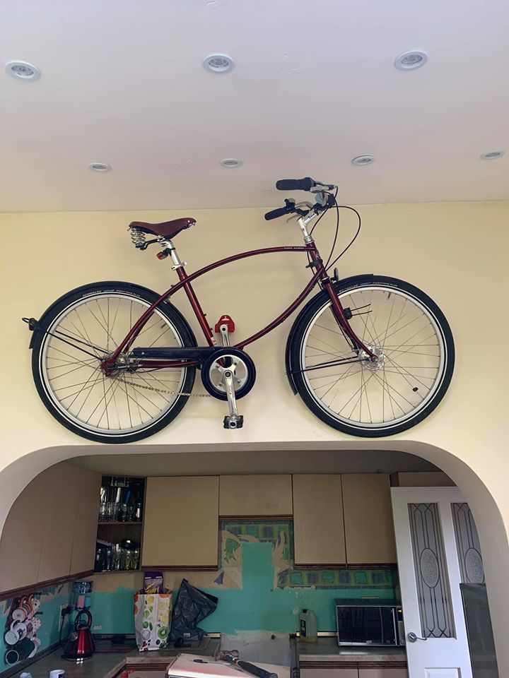

To my mind the MR16 lamp is a spot lamp, and to have spot lamps aimed at my computer keyboard or counter tops means more light where I want it without using silly sized bulbs, so bedroom has pendent and GU10 spots, but most of my floors are not white, so do not reflect well, so lamps are aimed at ceiling or walls or direct to special area, not direct to the floor, my son thinks spot lights look good, 98361719_10158572386853420_1054327038518755328_o.jpg and he has fitted fixed units, but from the bike on wall you can see how high the ceiling is, and the 16 GU10 lamps replaced one 2200 lumen 24 watt LED tube which replaced the original 65 watt fluorescent, at 5 watt each he is using as much more energy as the old fluorescent (80 watt) and at 370 lumen each total 5920 lumen around the same as the old 65 watt fluorescent.
Yes it looks good, and the bike is a good talking point, but lighting wise it does not make sense, I said he should have arranged as the great bear and gone whole way in making a planetarium.
Lighting is not easy, and I have make mistakes, I fitted lighting track and low bay lights in an area with a 40 foot between lamp and floor and it did well, but repeated at 12 foot and it was a failure, the same applies to 2 inch lamps, unless directed at a picture etc, to use them fixed in the ceiling you need a high ceiling, they look great in the show room with a 12 foot ceiling, not much good at 8 foot.
