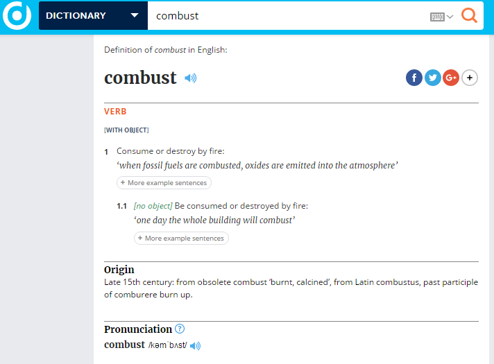

I would point out that the definition quoted is from the easily influenced dictionary, and -
not all dictionaries include the word 'easily'.

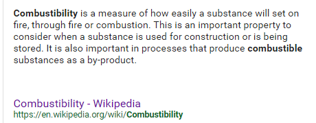

Also, the definition of 'combustibility' is given as:
Surely, if nothing is non-combustible, then the inclusion of 'easily' does not really alter anything.
If I understand correctly, on the basis of the definition of "combustible" that he has now found and quoted, he no longer believes that "nothing is non-combustible", since he now thinks that "non-combustible" means "not easily burnt" (whatever one understands by "easily").
Kind Regards, John
Yes, but if combustibility also means how easily something is set on fire through combustion, then we now have to decide how easily it easily catches fire - so back to square one.
I don't think we are, because unless "easily" is defined, we fall back on the dictionary definition. And I don't believe that many dictionaries don't define easy or easily.
