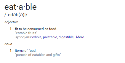

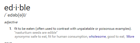

Just because I could eat something, that does not make it edible.
Not according to the definitions:
But that's the point. As there is no specific definition, the only thing which we can do is to use the "everyday" definitions of the words used.
As I said, you can argue that. However, even the 'everyday' definition of "easily" cannot quantify its meaning, and therefore down to a (probably context-dependent) judgement on the part of the person using the word.
In context, I suspect that many people's everyday use of the phrase "not easily burned" would probably embrace materials which few of us would regard as satisfying the spirit of the assumed intention of the regulation concerned.

Some things definitely are eatable whilst not conforming to that definition, so - is it wrong?
Or - do we not call ingesting materials which clearly are not food, eating - or do we have another word for it?
Does eatable (or edible) apply only to that we can eat easily?
