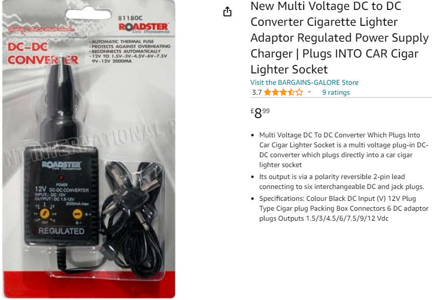

I remember a while ago now buying one form a petrol station. you would plug it into the cigarette lighter plug of a car and you could set its output by a dial of a switch to say, 9, 6 or 3 volts
Sadly an internet search I cant find anything. So first off; anyone know what one of these things aew called please?
I remember a while ago now buying one form a petrol station. you would plug it into the cigarette lighter plug of a car and you could set its output by a dial of a switch to say, 9, 6 or 3 volts ... Sadly an internet search I cant find anything. So first off; anyone know what one of these things aew called please?

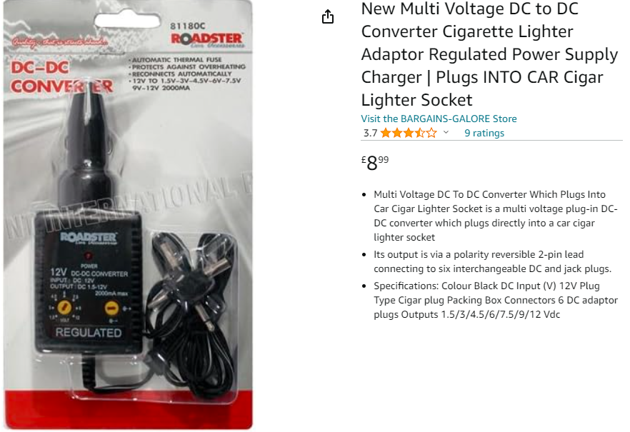

You mean something like this (see here) - which seems to offer outputs of 1.5, 3, 4.5, 6, 7.5, 9 & 12 volts?

Well maybe not; just to muddy the waters hear
My laptop says it is 15V DC input charge. So instead of going from my 12V car battery my DC-AC invertor which seams to make a lot of noise when doing very little! Then going to my laptops DC-AC adapter. I would like to bypass all of this and save power!
So from my DC system I have a 24V out put (2x led acid batteries wired in series) and if I plug the "DC multi voltage adaptor/ regulator" into it then i would need a setting of 7.5 volts right (7.5vX2=15V/ 12vX2=24V) But the setting on it are 9, 7.5, 6 est. Should this work?
Yes that is perfect! ... Any idea where i can buy it form a proper shop? ... Thanks
You're welcome, but I've no idea what you would regard as a 'proper shop' - if you buy "it", presumably it will be the same wherever you get it from? (I know you have issues with multiple suppliers, but that's your problem!).
If you search for it by name seemingly "Roadster") you might find another source. I had no problem finding that one with Google - there are a lot of similar products out there.

They are called cheap crap which will damage and destroy expensive electronic devices which are connected to it.
Depending on what laptop you have got, it may not be a case of just shoving 15V or whatever into it either.
Indeed. I'm not sure whether that will get described as "expensive crap" or what, but I would personally be fairly happy using it with my laptop!

The search term you need is "dc to dc converter" or "dc to dc power supply" - look for one that is the exact voltage pairing you require and can handle the max current the laptop will draw. Bear in mind that (as evidenced from your earlier threads on other topics) you don't seem to understand things like voltage, current, power, ac, dc, parallel and series etc very well, so it might be worth asking here whether any proposals for kit you find will work out. For example, your proposal to wire the outputs of two cigarette adaptors configured for 7.5v in series to power your 15v laptop would be highly unlikely to deliver the required current. At best they'd burn the fuse, at worst the house.
Further to this, I suspect you'll find that tha efficiency difference between the DC/DC route of your idea, and the AC/DC route of your laptop power supply will be negligible, if it's in favour of the DC/DC route at all. Don't lose sight of the fact that a small efficiency difference has to pay for the converter, which may take a long time.
