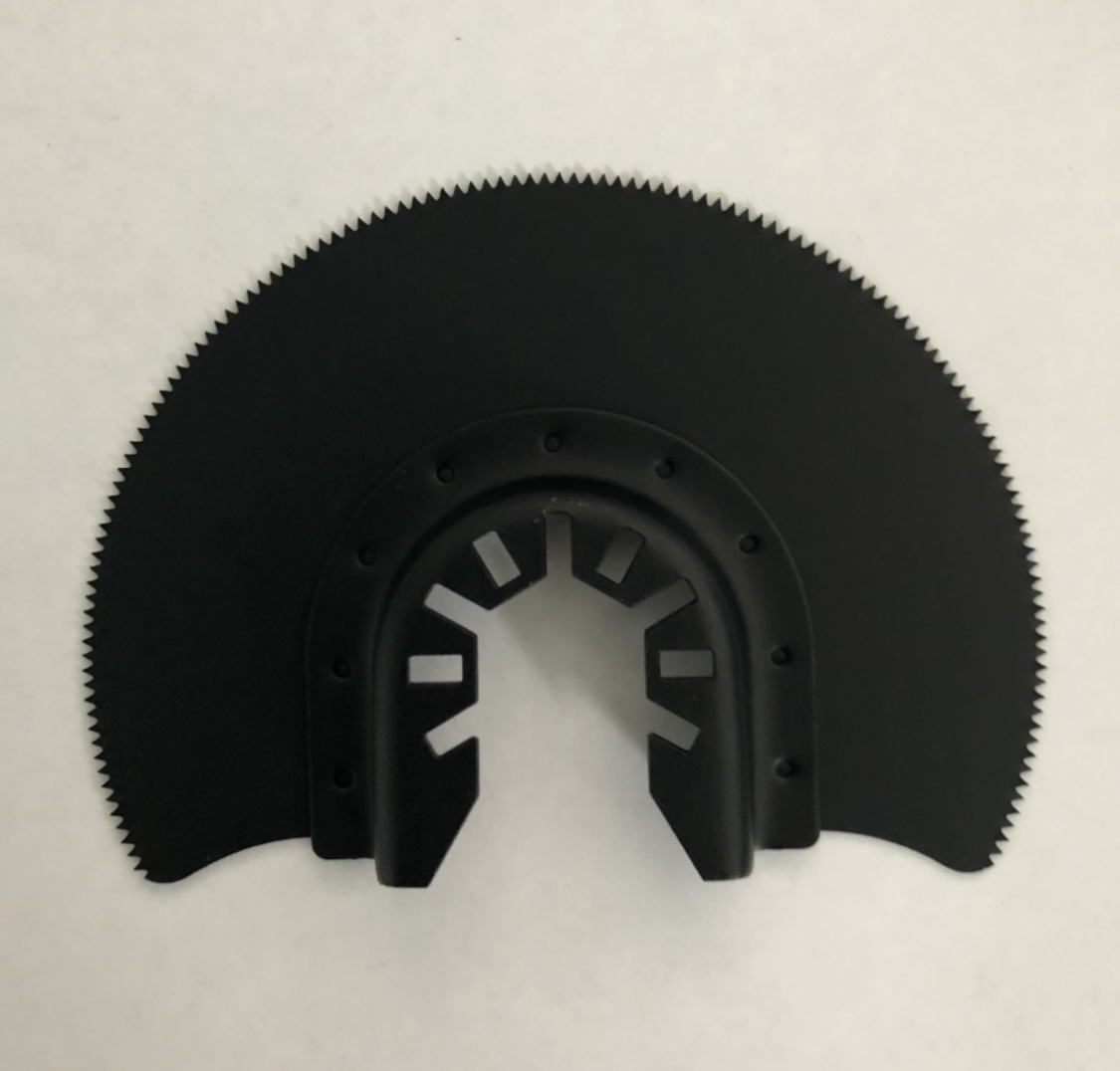

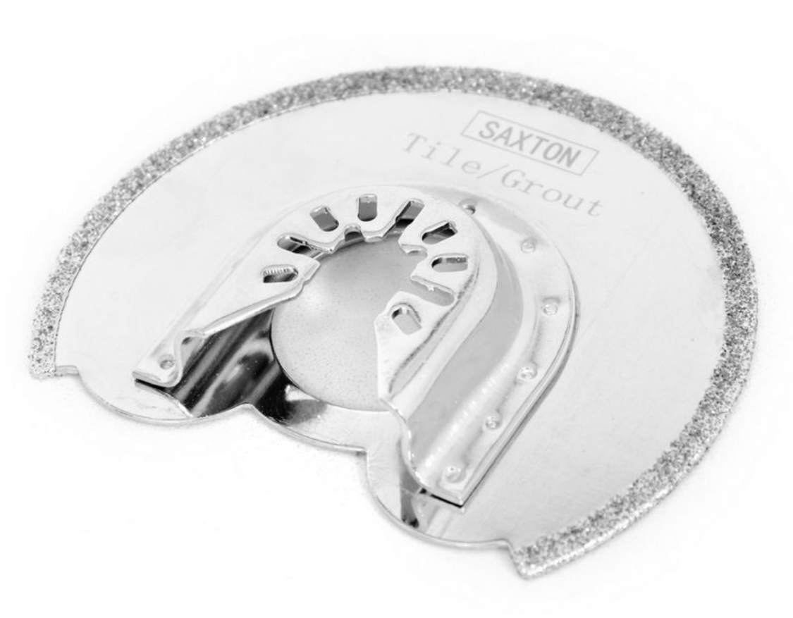

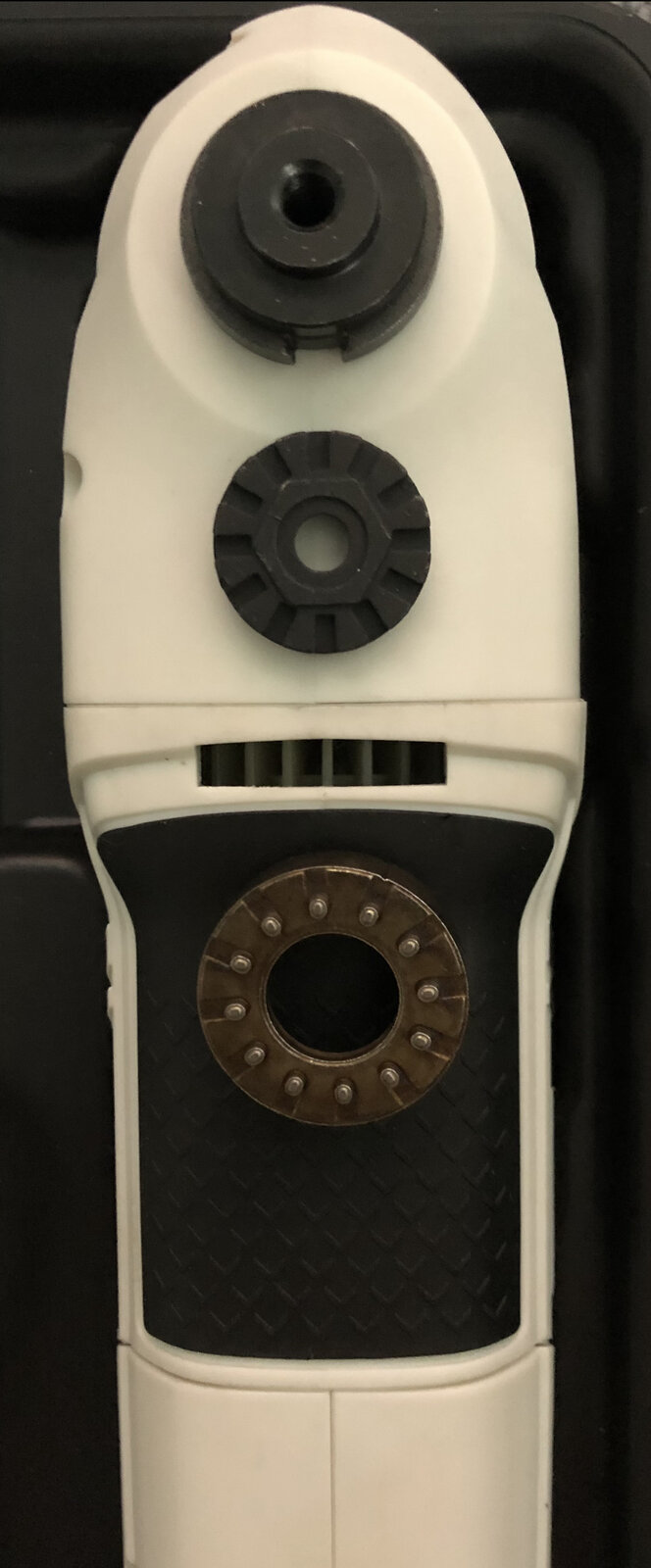

I’ve got a MacAllister multi-tool from Screwfix but not sure about whether a certain blade fitting is compatible with it. The circle bits are adaptors it has come with along with the black blade that has also come with it. I’m looking to buy the Saxton one but it looks a little different does anyone know if it will fit?

I’d have thought they were all interchangeable. Looks the same pattern as my DeWalt one.
Edit: Maybe not!
The circle adaptor is a Fein-compatible adaptor, and as they were the progenitor of all these tools if it will fit a Fein, it'll generally fit most other tools (with or without an adaptor). What does your manual say about the adaptor?
Bosch type fits according to Internet.
I guess you unscrew bolt and slide through blade with pined locking plate. Takes a minute to fit.
Other type is dewalt type that slide in and take 2 seconds..
The manual says 'The provided tool holder adaptor and the related fixing parts enable the product working with popular brand accessories which cannot be attached to the quick changing tool holder of this product.'
I have had two Fein multitools and I currently have Makita 18 volt cordless tool. They can all use the same "popular" fitting. If you buy your tooling from a firm like Saxton (Google "Saxton multitool blades") you will always be able to get a blade which fits

Yes that blade in the last picture is from Saxton which is where I'll be buying from.
