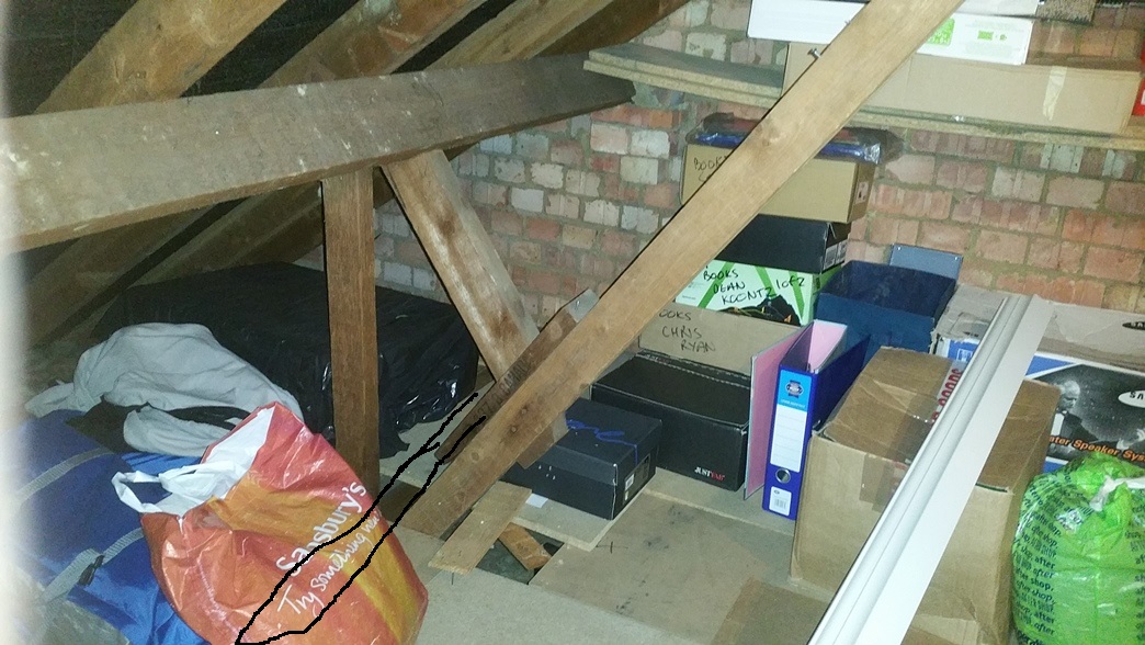

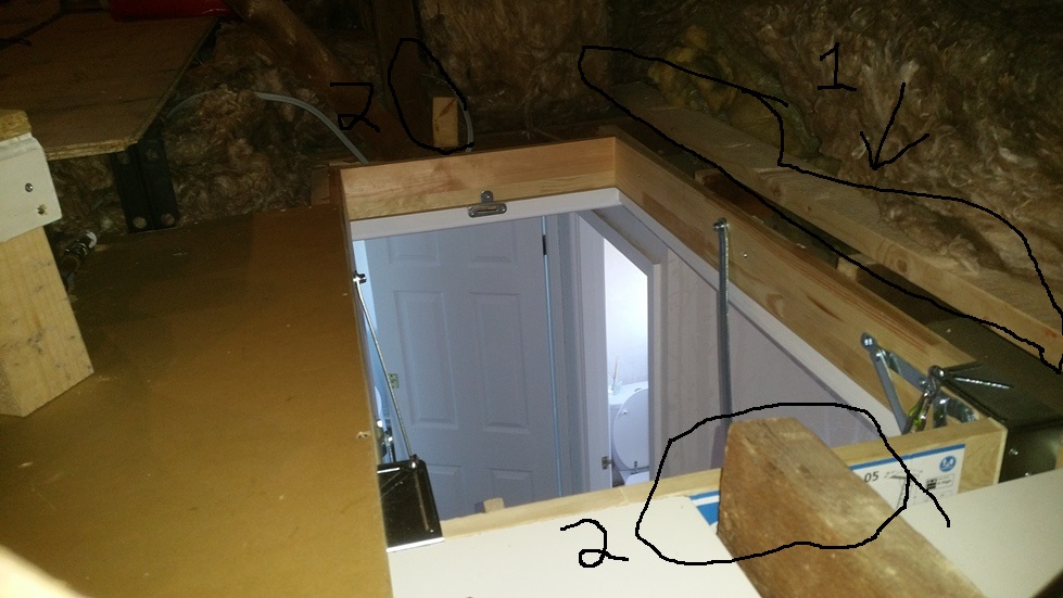

I live in a 3 bed mid terrace 1950s ex council house (the roofing style is in the second pic and have recently had our loft hatch moved from what will be our baby room into the landing. Simple for someone who knows what they are doing.....and they seemed to.
A carpenter has blocked off our old hatch and put a new one in, a pretty good job on the face of it. However, to install the new hatch they have cut through a large beam (marked 2) (I believe they called it a pearling?!?) the house has 4 of these running the entire width of the loft. I will try to attach a picture.....where they have removed this beam the new loft hatch sits nicely and they have put a slightly smaller beam (marked 1) next to it screwed to the "joists?" (the 600mm apart beam that the celiing attaches to the underside of?) I was worried about this at the time but was assured this would be ok.

The beam that has been cut is almost certainly a tie beam that prevents the base of the rafters moving outwards and sliding off the tops of the walls.
It is a structural member of the roof structure and should not have been cut.
The timber that has been cut is a binder (not a purlin - they are higher up).
It will be providing some support to the ceiling joists to prevent them from sagging. The ceiling joists also prevent the roof from spreading, but if only 2 or 3 are cut, and adequately tied, it shouldn't be a big problem.

Whoever cut in the opening for the hatch has not trimmed ie. supported the Binder cuts. The flat 2"x ( No 1 ) might be taking up some of the weight but the cuts should be supported.
Nor, so it seems, have they trimmed the ceiling joists with doubled trimming joists supporting the trimmers.
google pics of joist trimming and what I'm saying might become more clear to you?
When cutting a hatch opening of any kind in joists or rafters you must support the cut members with a surround of same size (section) timbers - aka trimming.
If the opening is not supported the joists will sag slightly, & perhaps crack the plaster finish below.
The actual custom hatch is fixed between the trimming timbers.
Yes as said above it's probably a binder for stopping the ceiling sagging but since it's classed as structural work then an SE should really have designed it. The joists should be stopping the roof spreading so hopefully you're fine on that account.
Get the person on the phone and ask how they designed it, and if the answer isn't useful then you might need to look at repairing it with another tradesmen to a proper design.

Has your custom hatch been fixed with hangers or brackets - how is it secured to the surrounding joists?

Thank tony and bernard. The first picture shows a beam up and right of the loft hatch. This is the only compensatory work done.

Hello all. Thank you for all the replies. I will have a look again tonight when i get home to see about the trimming joists etc. and have a look to see how the hatch is fixed to the joists. If only i had seen them fit skirting before they did my loft hatch.......

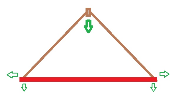

What is at the ends of the beam that has been cut ?
Are the ends attached to base of rafters to form triangle as in this sketch ?
The red beam, refered to as a tie beam, stops the bottoms of the brown rafters moving apart.
Tony is right in saying that ceiling joists are often used to act as tie beams but that is not always the way it is done.
Many roof have trusses which do not use joists as the tie beams

From the picture and the description, I thought it was a beam running from gable to gable, in which case cutting it would not cause the rafters to spread.
Is that right?
