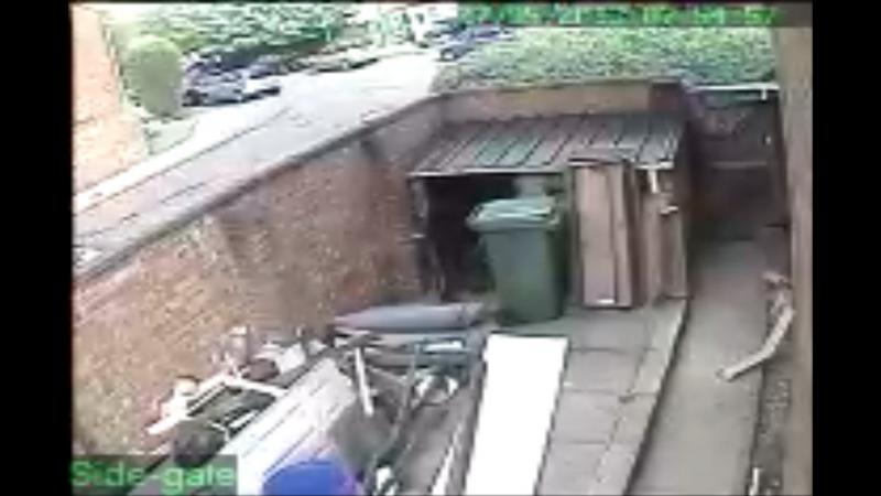

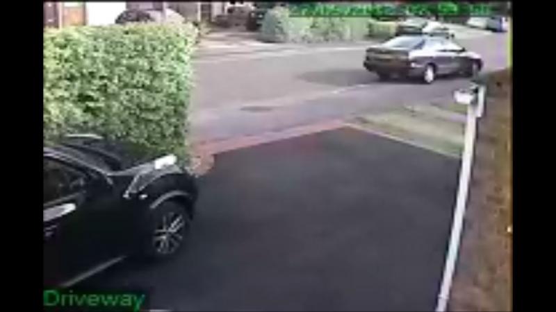

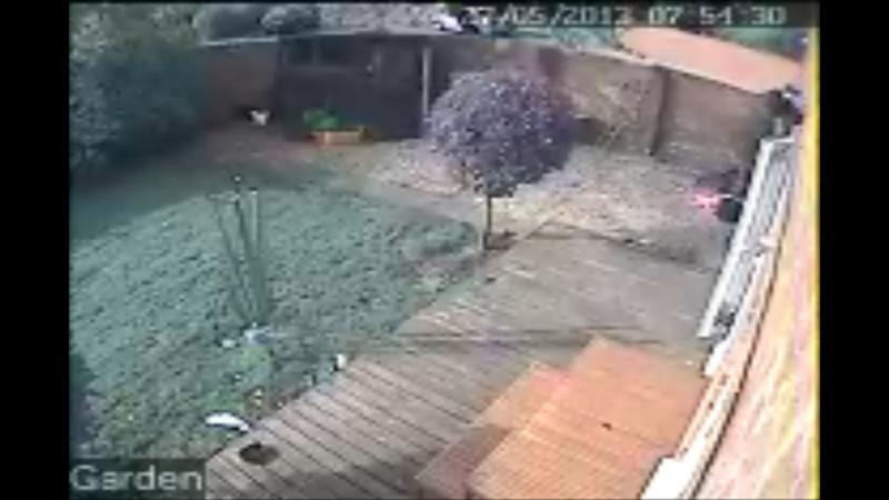

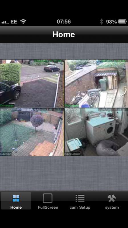

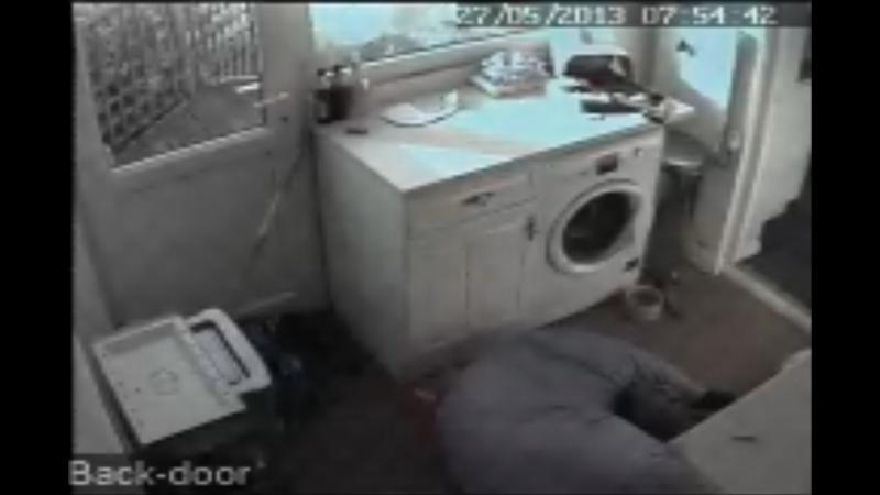

Attached are screenshots from the App running over an LTE connection (other than the first one) on iPhone 5, forgot to rotate them before I uploaded. I'll get some pictures of the 17" Dell monitor (another £20 eBay bargain too) at some point so you can see the quality off the DVR as it's much better than the App IMO.
DVR App MS500:
- Included Camera (yes, that's a pile of junk where we're doing some work) on iPhone 5 over LTE
- £9 eBay camera on iPhone 5 over LTE. We use it as a 'dog cam' while we're out
- £30 eBay camera one on iPhone 5 over LTE
- £30 eBay camera two on iPhone 5 over LTE

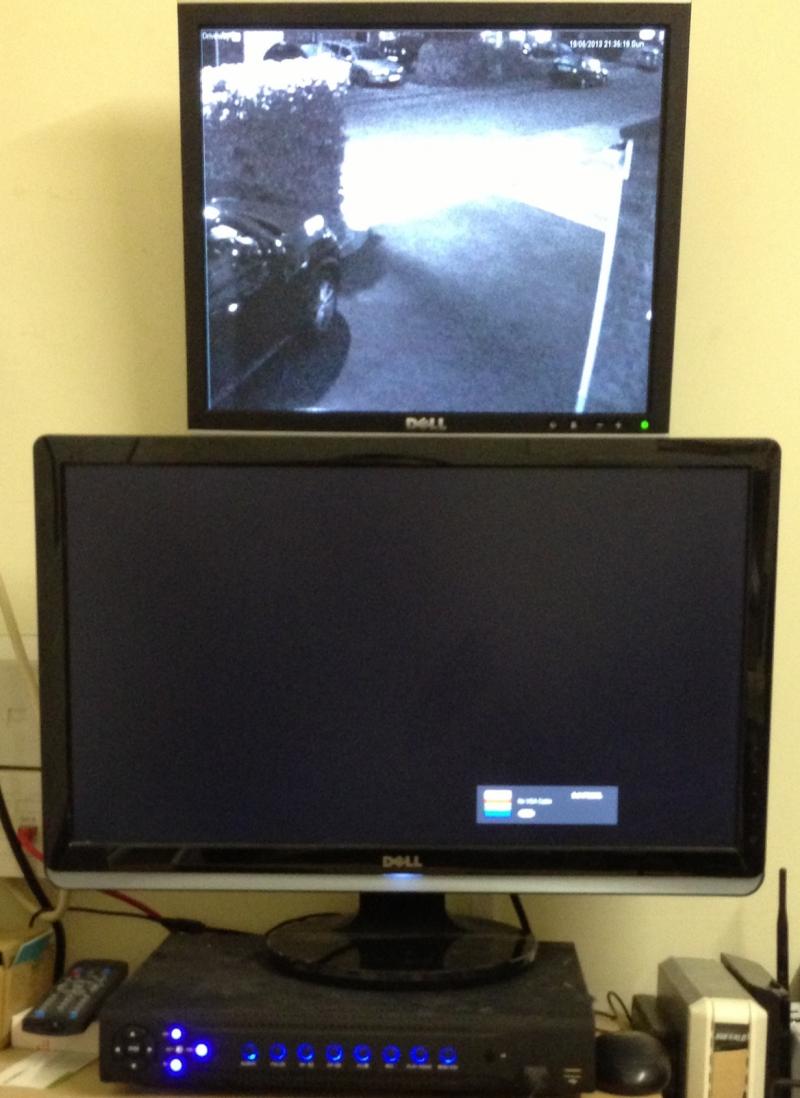

Another edit, photos of the monitor from my camera roll, not sure they do it any justice though:
Night vision eBay £30 cam:
All four in Dell 17" Monitor:
that looks very effective at low cost.
how long do we have to wait to know if the service life is acceptable?
They look pretty acceptable. What is the night time quality like for the other 3 cameras?
How do you get the MS500 App? I have searched the app store but got nothing.

* I got the wrong name, App is VS500 free on the App Store, MS500 isn't compatible. Presume your DVR needs to come from the same manufacturer though?
* Other cameras at night;
- eBay £9 OK but only has a very small room to cover
- eBay £30 number two the same as the one in the image, plus I have an IR security light covering the back garden anyway
- Maplin one a bit more grainy/noisy so not so good
* On the above, I need a more powerful power adapter running the cameras, or shorter cables, as when all four are on there is not enough power to run the IR due to cable length/resistance but I've tested them all individually and now just need to get around to the upgrade when I have five mins spare!
