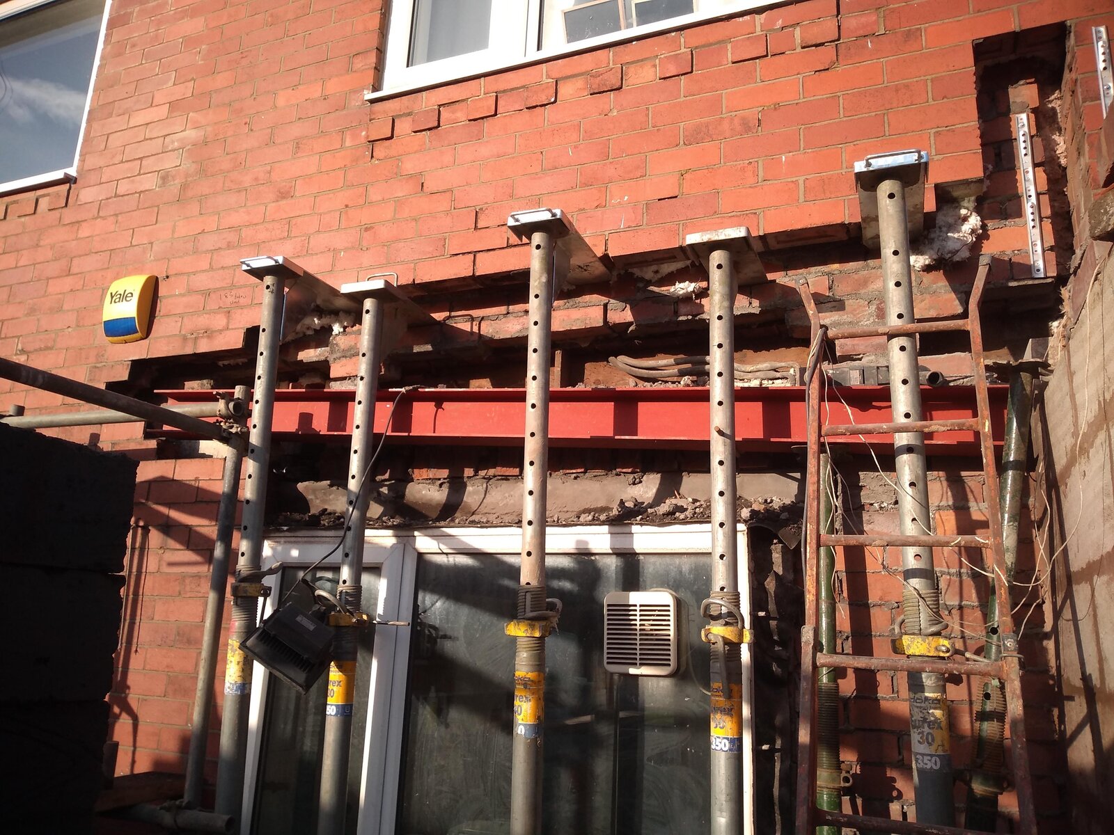

I have managed to source myself a 2500mm long universal beam from a friend FOC. This will work just fine i think holding the full width of the wall plus allowing me to cut the trimmer into it.

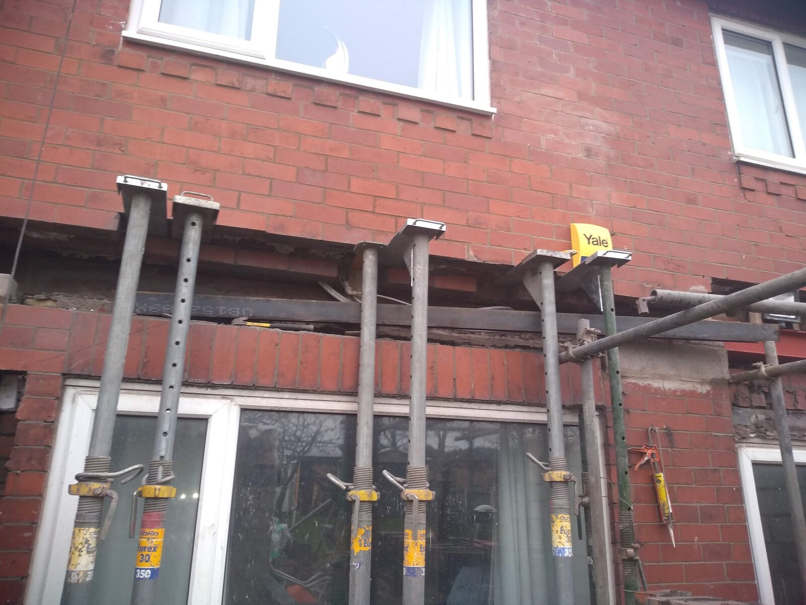

Now the question is how does it get installed whilst keeping the strong boys in place? I only have access from 1 side so i cant slide it in from the other?
Might need to move those boys a bit higher (one at a time), those angled bits get in the way when doing the inner skin from outside. When I did mine I squeezed the steel in from a scaffold on the left then pulled it up:
In the picture it's not floating in mid air, it's sitting on a steel bar through one of the acrow holes, and the brickwork above was knackered already due to plastic windows not my propping!
The left hand one was worse, I had to tip it on its side because I couldn't get it past the triangle on the second strongboy in.
Oh, and don't forget to prop the trimmer, I'm sure you've got it in hand but sometimes easy to overlook when you've got 10 other things to think about.

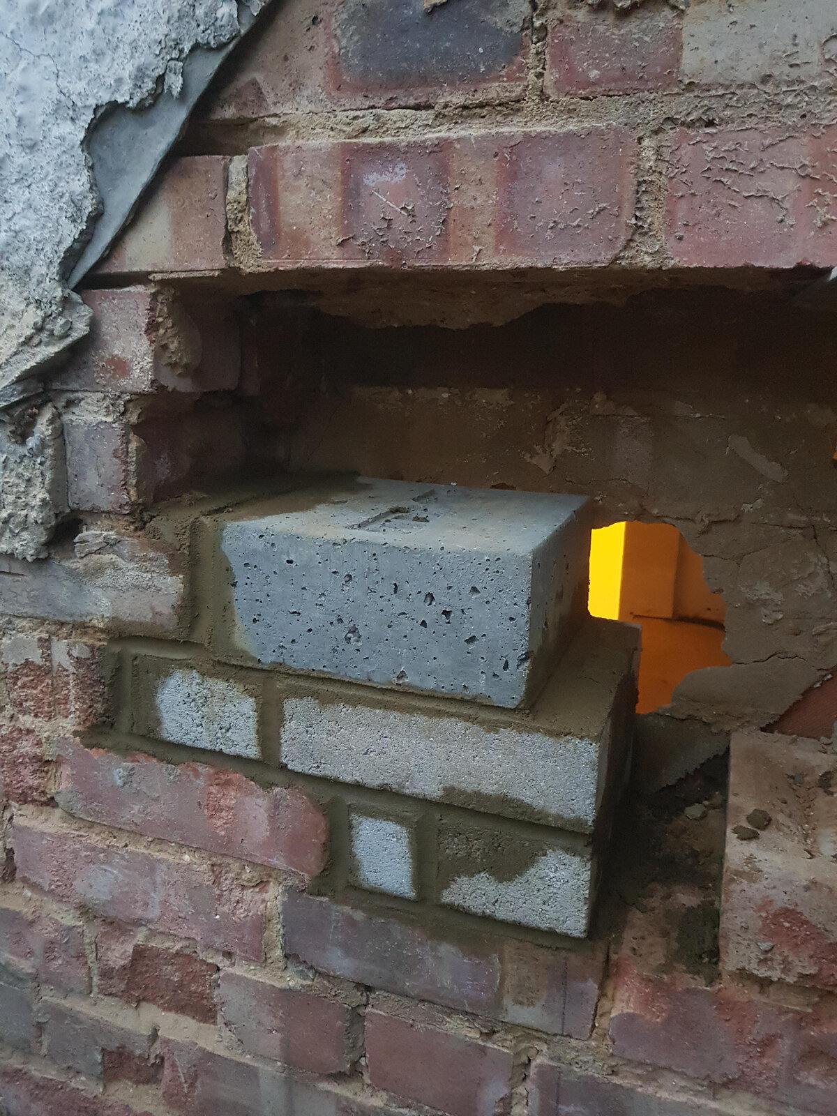

Ok things are moving on. I removed a few more bricks, have a nice large section of internal load bearing wall to site one end on 200mm+ and have installed padstones at each end to support the load as the existing brickwork seems a bit worse for wear.

I have 5-10mm clearance in height for the steel. How is best to install
1) sit steel dry on the padstones and pack between top of steel and brickwork
2) Support steel up onto the brickwork and pack between the bottom of the steel and padstone
3) Remove 1 more layer of bricks above. bed lintel on padstone and install a new layer of slightly smaller cut bricks/blocks on top of lintel
Thanks. So more important to have the packing under the steel. This makes sense and will be far easier to achieve.
How dry should the mortar be for such a small bed does it make much difference?
If you've only got 5mm I think you'll struggle. You want to jack it up with a decent bed of mortar to fill all unevenness in the bottom of the bricks so you need clearance to do this (10mm bed on top of steel plus 5mm space to slide it in without scraping the bed off). I'd knock the padstones off (and if you can find a use for them elsewhere keep them - they're not really necessary - more of those blocks will do). Then just build up tight under the end bearings. It's really difficult to fully fill tiny deep gaps with mortar.
Yeah you don’t want to be trying to push mortar into a 5mm gap, when you said packing I assumed you were planning on slate packing the ends of the steel which you could do and avoid removing the padstones
