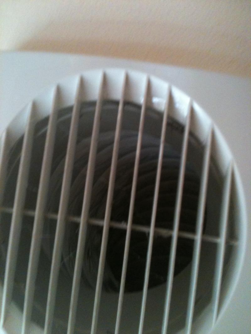

I have an extractor fan in my bathroom that comes on when the main power cord for the shower is pulled. The extractor is in the ceiling and is not flush to the ceiling. It does not have any way to shut this so it lets the cold air into the bathroom, its like having a window open all the time. I have looked in to the vent part in the bathroom and I can see a tube, like you sometimes see on tumble dryers to vent the moisture outside. The tube leads to the side of the the house in the loft and the vent can be seen on the side of the house from outside. It is a constant open vent that lets a lot of air in all the time (not just on windy days). fine in the warmer months but last winter it was really cold.
Is there anything that I can buy to fit over the top of this to help with the problem. What would be good is something that would have a pull cord so I could open it when the extractor is being used and close again after. I have this same problem with the vent in my kitchen window but in the winter I just cover it up with clingfilm to solve the problem. dont really want to do the same thing with this as would have to keep going on a step lader to take it off and put it back on. Please can anyone help as it can get really cold in my bathroom. It was so bad this winter just gone I have to put a draught excluder at the bottom of the bathroom door as it was making the upstairs of the house cold.

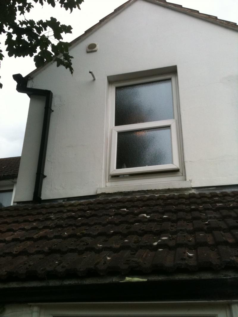

I'd recommend a cowel vent on the outside. The cowl, or hood, keeps the rain out and reduces wind effects, and there is a flap that opens to let the fan blow through. The brown colour tones OK with brickwork, but you can apply non-drip gloss oil paint if you want to change the colour.
http://www.screwfix.com/search.do;j...yl3tLySwRKTLs!-980593536?fh_search=cowel+vent
don't get the sort with little flaps like a venetian blind as they rattle annoying in the wind, until they break off.

i would never be able to get to the outside of the house where the outside vent part is. its right at the top of house at the back but cant just put a ladder up to it. below it (getting in the way) is a single story utility room it has a slopped roof so cant even put a ladder on that. i could put a ladder up the side of the house but its to far in to reach. is there anything that can go inside my bathroom or am i going to have extractor replaced ?
The inline vent should be ok but can you post a photo of the inside and without getting up a ladder, what you can of the outside?
Yeah, looks like the outside has no flaps at all, try to measure the diameter of the pipe inside to make sure the inline one will work and it should just be a matter of taking the pipe off the inside vent or somewhere along the pipe and attaching the inline vent between the 2. you may have to access it from the loft. The instructions should tell you the best place to put it.
