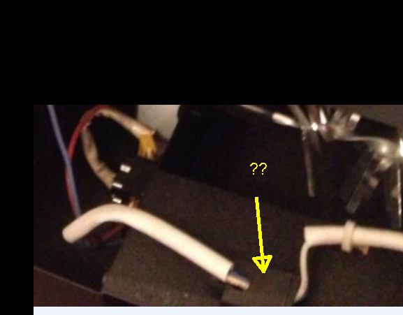

Ok, have opened it up to have a look. The only thing that didn't look right to me was burnt crispy stuff just underneath the bulbs, but that could have been from a year ago when one of the bulbs did shatter inside:

Does any of this give any clues, or is there anywhere I should be looking a bit deeper?

If this is an unsheathed wire going under a metal bracket ....
.... the insulation could be damaged, causing an intermittent short.
I opened up the little bracket, and another one the same the other side, but nothing looks damaged in there either (to my very untrained eye) :(
Perhaps the socket/house wiring is to blame after all...
