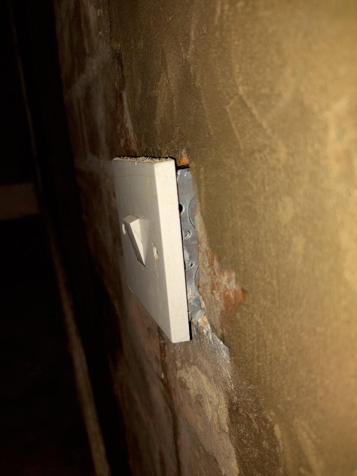

As the back box is not an exposed-conductive-part therefore does not require earthing at all
To clarify, are you saying if you have a plastic light switch and recessed metal back box, the earth wires could be joined in a connector, and not attached to the back box?
(I'm not trying to make up my own rules, honest.)
As the back box is not an exposed-conductive-part therefore does not require earthing at all,
You are joking !
What will happen if the back box becomes Live ?
a) The screws holding the front face to the back box will be Live to the touch.
b) If the plaster around the back box is damp then that damp area of the wall will be Live to the touch

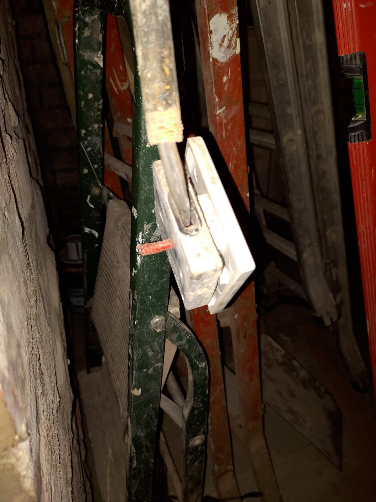

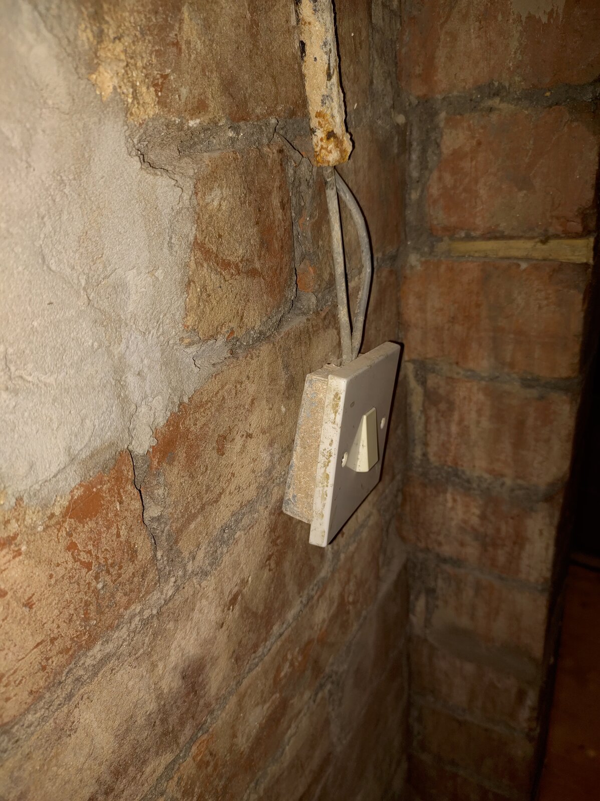

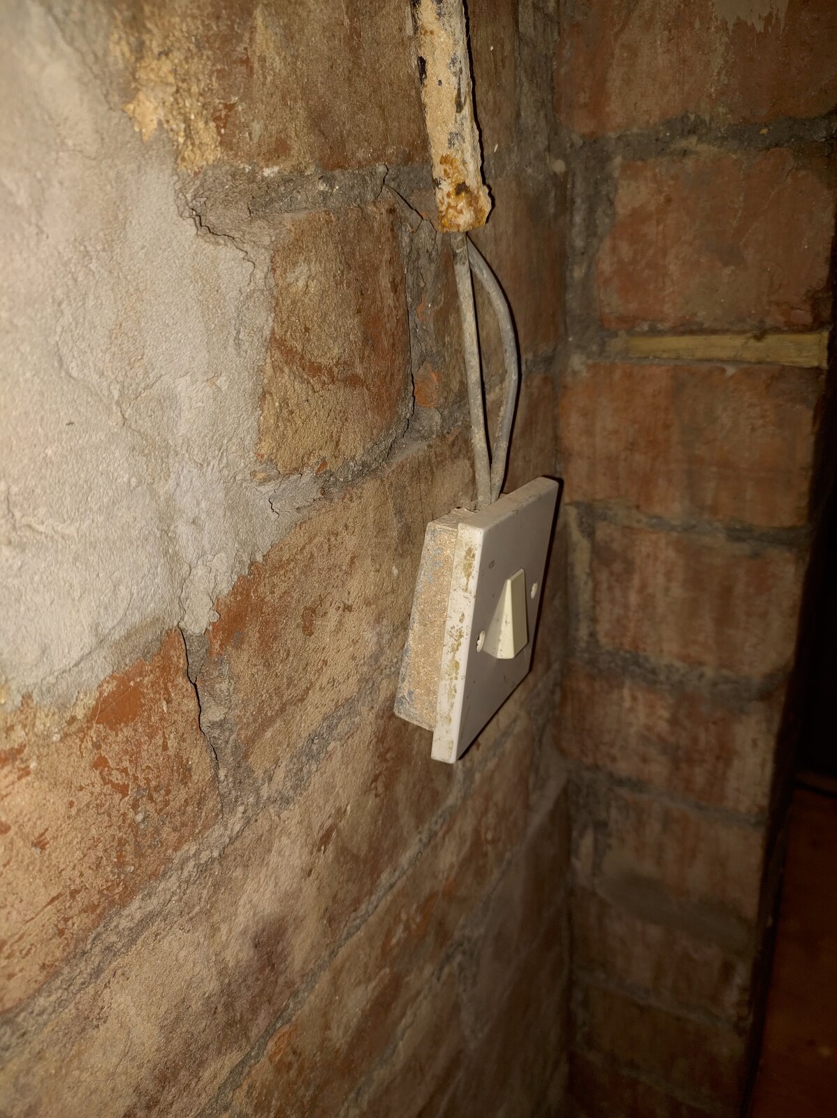

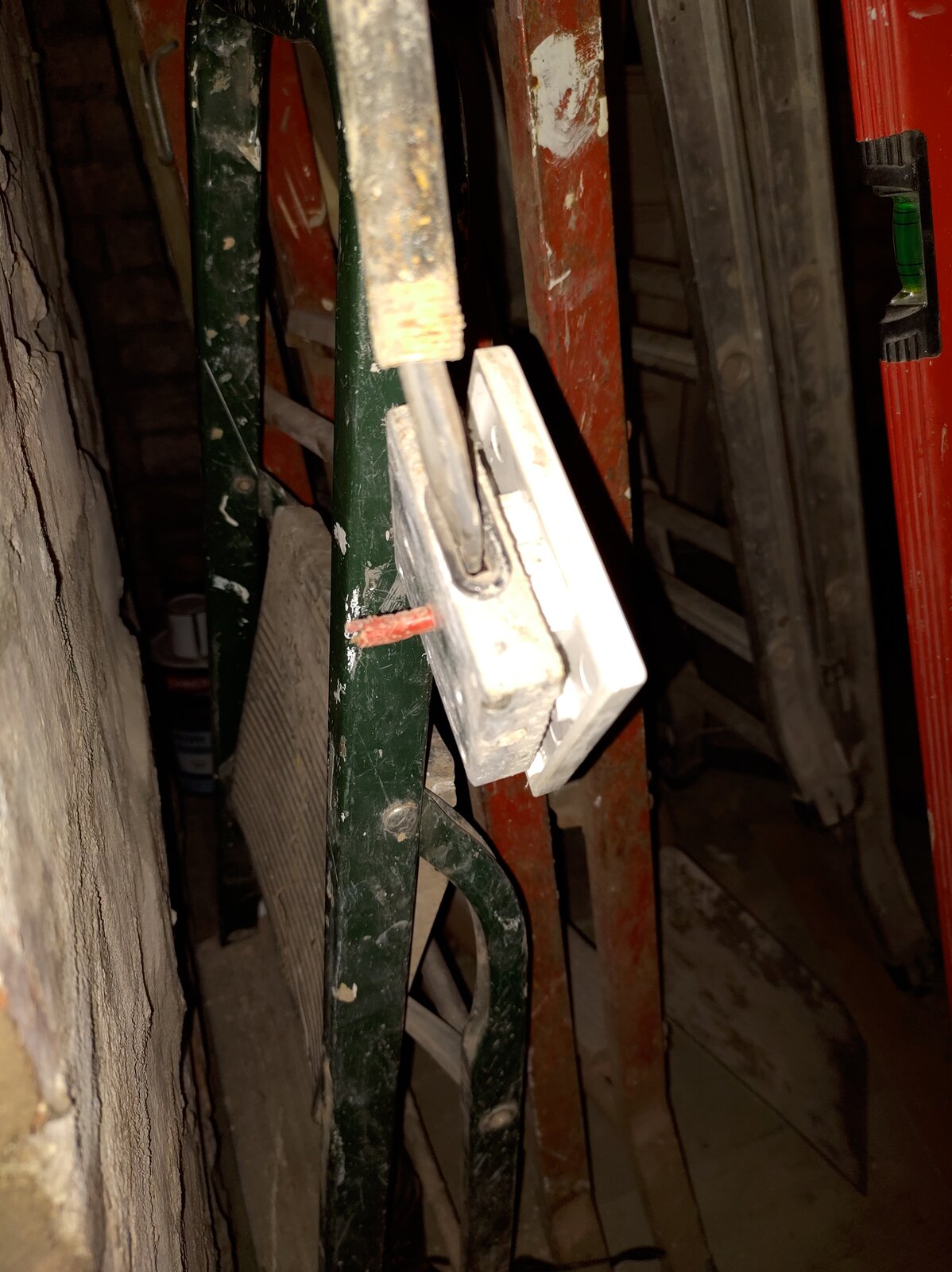

My house at the moment, I've made sure all the earth or CPC's or whatever are in good condition.
The last one was a pain today, PVA'd the wall for rendering and it was running down the cable into the backbox - dabbed it with some kitchen towel and nothing popped in the fuse box so happy days.
I have known some doing continuity tests report defects on light switches = plastic switch, test made at accessory screws, no earth reading.
The back box may or may not be earthed but the screw lugs contain plastic inserts so you could never get a reading anyway.
