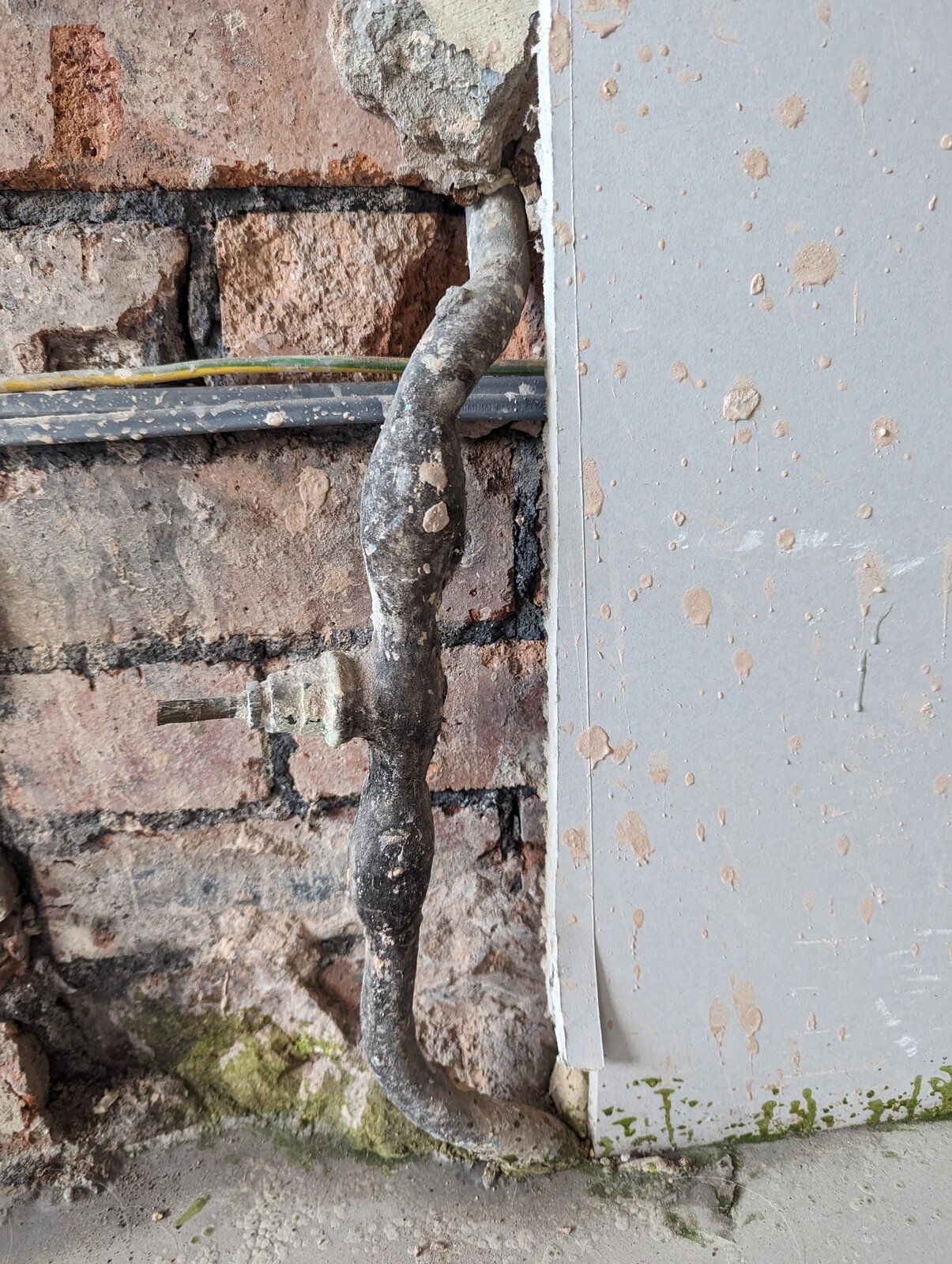

I am currently getting my kitchen done and have come across the water main pipe in the kitchen that I have never seen before.
Can anyone advise if this pipe looks like it is the stop tap for the house ? I was going to get the plumber to replace it with a lead to copper valve. Pic below but he is advised that he can't mess with it until we stop the water going to the house which is my next problem I am struggling to locate my external stop tap outside my property. This is the only thing I have found pic attached and I can't get to it for the life of me and have never seen this type of cover S

It looks like a typical water stop valve cover, though a very old one - try opening it. Judging by the cover, likely the valve below it will be seized, but worth a try at turning it off.
Also might be worth contacting your water supplier, some are replacing lead, with copper to the inside valve, for free.

Thanks for the reply mate. I have tried to lift it but it won't budge at all. I am with united utilities so they will only replace up to the boundary of the property which is not ideal.
My problem is that the lead pipe in the second picture needs a lead to copper stop tap fitted so I have one for access in the kitchen but at the moment I can't access my external one and United utilities are saying that they don't maintain them anymore so it's basically my problem. I have a plumber coming later but not sure what else he can do if we can't even get to the external tap. United utilities said they will only help if the plumber is unable to use a freeze and squeeze method but we need to have a very good reason for them not being able to do it.

Regardless I think my issue is if I somehow manage to open up the grid and the valve is seized/ won't work would it be united utilities responsibility. I don't want the lead pipes replaced on the drive/ boundary as it will cost me too much. I just need to replace part of the lead piping with a lead to copper stop in the kitchen (second picture) as I don't think I have an internal stop tap unless the pipe in the second picture is ?

As it is outside your boundary it must be UU's problem to fix it. Lifting the metal cover will not be too difficult, normally a T key fits, but a flat screwdriver should lift it, maybe loosen it with a lump hammer?
I think you need to think long and hard about this one and see how finances are placed. If pic 2 is you mains then that is only going to cause problems in the long term. The best approach, especially with lead would be to have it replaced.
As far as locating the external toby that would be for UU to establish, as that's their responsibility. Once that's known that give you a starting point and the main isolating point. Just because your current mains runs up the driveway, doesn't mean that your new one has to.
Surely there has been wet works performed in the property at some point, that would need the mains shut down and I wouldn't say it was turned off at that lead by the looks of it. The chamber lid will go, it just needs worked on and some lubricating/penetrating oil used etc

It's pretty much essential to have a working means to isolate the supply, in case of an emergency anyway. What are you going to do, if you have a burst pipe this winter, or need to change a faulty tap washer?
You can get a new pipe 'moled' in nowadays, they'd dig a metre deep hole in the footpath at the stopcock the use a mole to tunnel the cable under your drive to a suitable hole near your kitchen the you'd use something like an insuduct to get it into the property.
