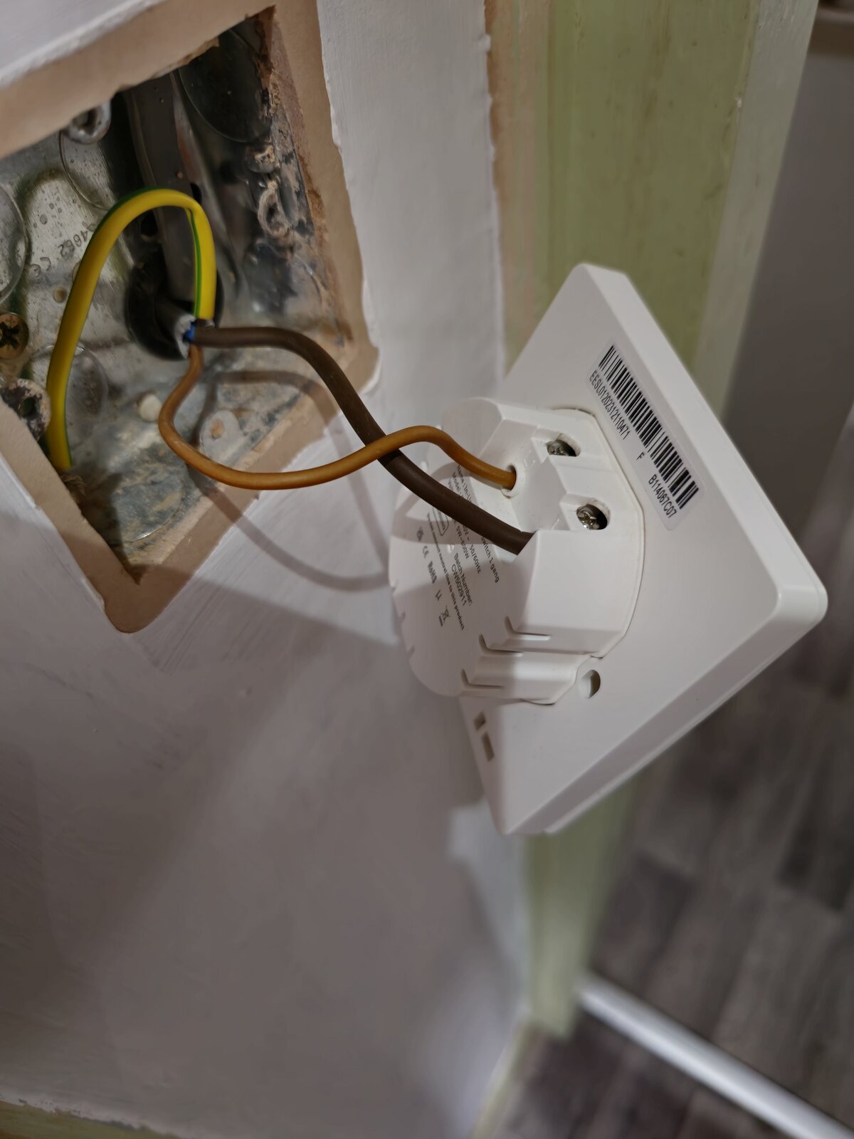

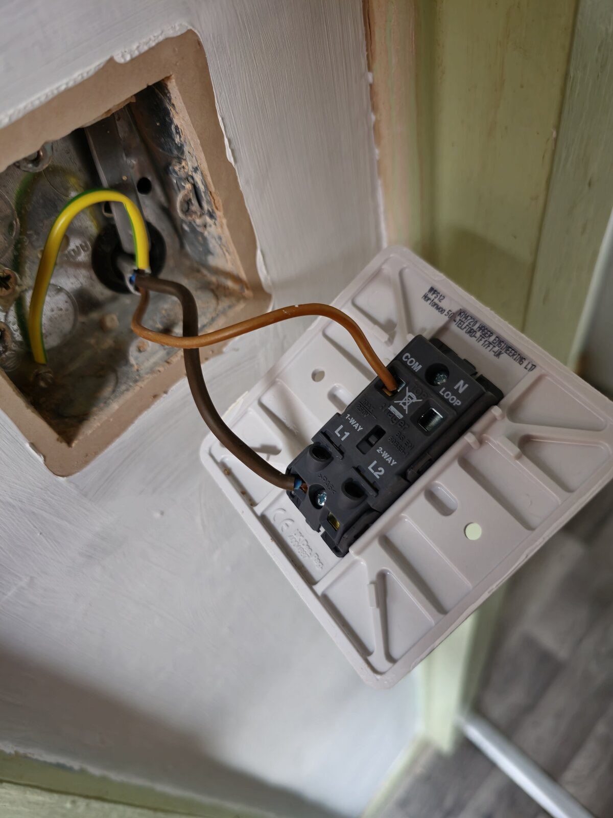

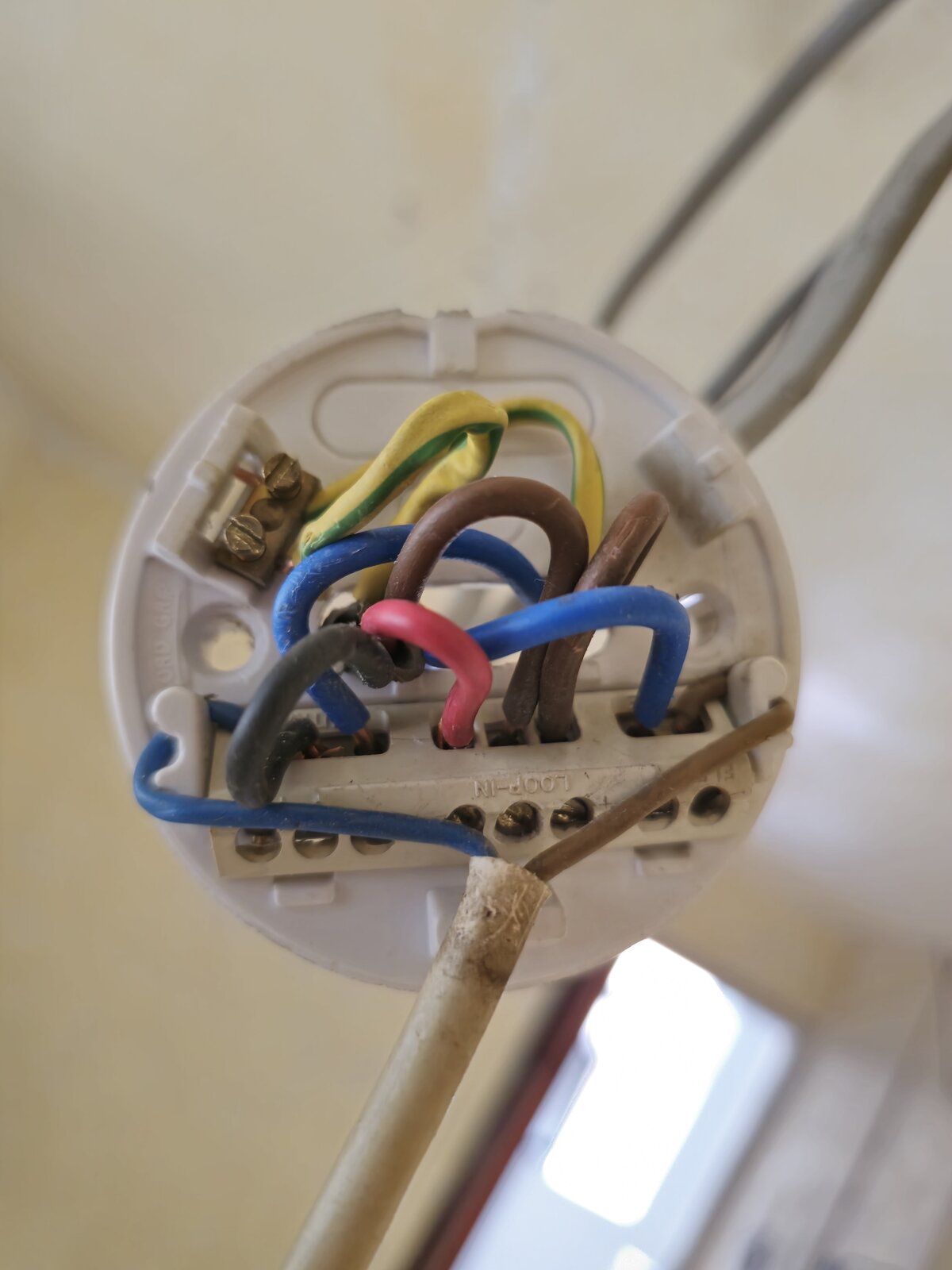

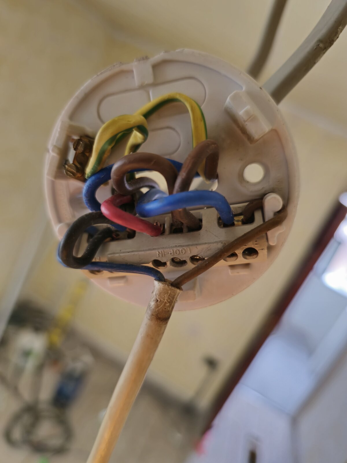

Is there any way this rose, or any joints that may have been made to relocate it, could have been wired incorrectly?Could it be that the rose isn't connected properly? It was originally elsewhere and my father moved it to the center of the room, but I assumed he wired it correctly. To be fair after he moved it, the light switch did work, until he disconnected the one that I don't want to be using anymore.
You only have to get two blacks or whatever the wrong way round for weird things to happen.

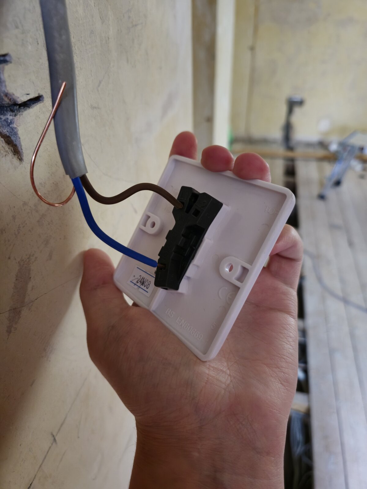

When I say neutral, I simply mean... blue. I'm not an electrician so "switched live" is a difficult concept for me to understand, lolYou say there is currently a neutral at the switch.
Surely that's a live feed to and switched live from the switch?
Well, as I say, if the standard plate switch turns the light in and off and the light bulb doesn't flicker, dim or flash, then it would appear to be wired OK.could have gotten something the wrong way around?
If the light turns on and off with a regular switch, it should do the same with the Quinetic controller.

The other thing to try is to temporarily fit the Quinetic controller in place of another switch that is operating a single lamp and see if you get the same problem.
