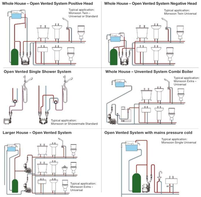

As the subject line says... I am looking for advice on how to fit a shower... in a cost effective, simple and safe way as possible.
There are however, one or two little specifics that may make a difference...
1. The shower is to be fitted in my photographic studio where the ceiling is about 11 feet high, and I would like to be able to vary the water coming out the head(s?) between drops, mist, and a combination of the two.
2. Both the hot and cold water tanks are about 3 to 4 feet higher than the ceiling and around 45 feet away from the studio where I want to install the shower!
The image I have attached (below) is from the Stuart Turner brochure and what I imagine I would need to do is the 'Open Vented Single Shower System'.

The cold water tank is on the roof of the building, about 14 feet above what will be the shower head. The hot water tank which is about 4 feet above the shower head. Both are 25 metres away from where we need the shower head to be.
The hot water is scalding hot at the tap in the bathroom directly below the hot water tank.
What I hope will work is to take a hot and cold feed from both tanks, run it across the ceiling and down the wall to the floor where I will have a thermostatic mixing valve going to either a Salamander Single Booster Pump 2.40bar or a Stuart Turner 46420 Monsoon Pump 4.5 bar Single Standard (Positive Head). This will the go up to something like this...
http://www.youtube.com/watch?v=iaRiY5N5qec
Am I crazy? (am I going to blow myself up?)
14 feet above the point of delivery should give a reasonable flow anyway, and you may get away without installing a pump at all. I have reservations about using a pump over such a long period of time (10 to 15 minutes) due to the amount of water it will use. I'm not on about wastage, but more the size of the cold water tank that is supplying the setup- the pump will be "pulling" water from this both directly and indirectly via the hot water cylinder.
You would need a twin impellor by the way - this is installed before the thermo mixer and not after.
