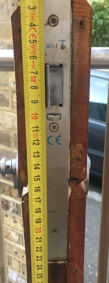

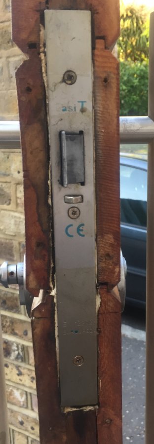

Hello
I need to replace the lock latch in the pictures attached but strugggling to find it online.
Anyone can help?

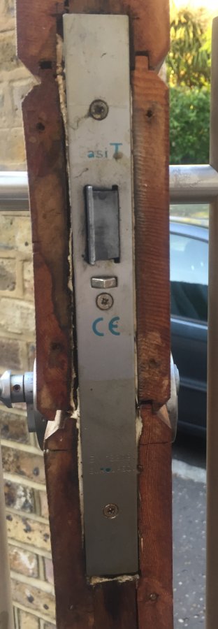

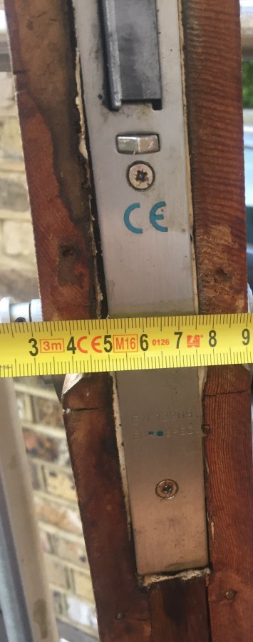

I think I can see some letters or numbers stamped into the fore-end. What do they say?

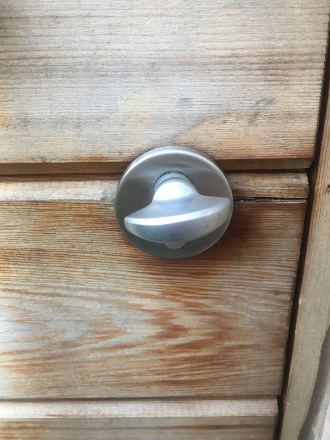

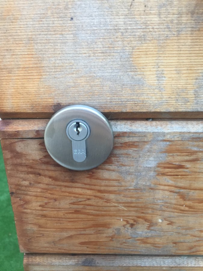

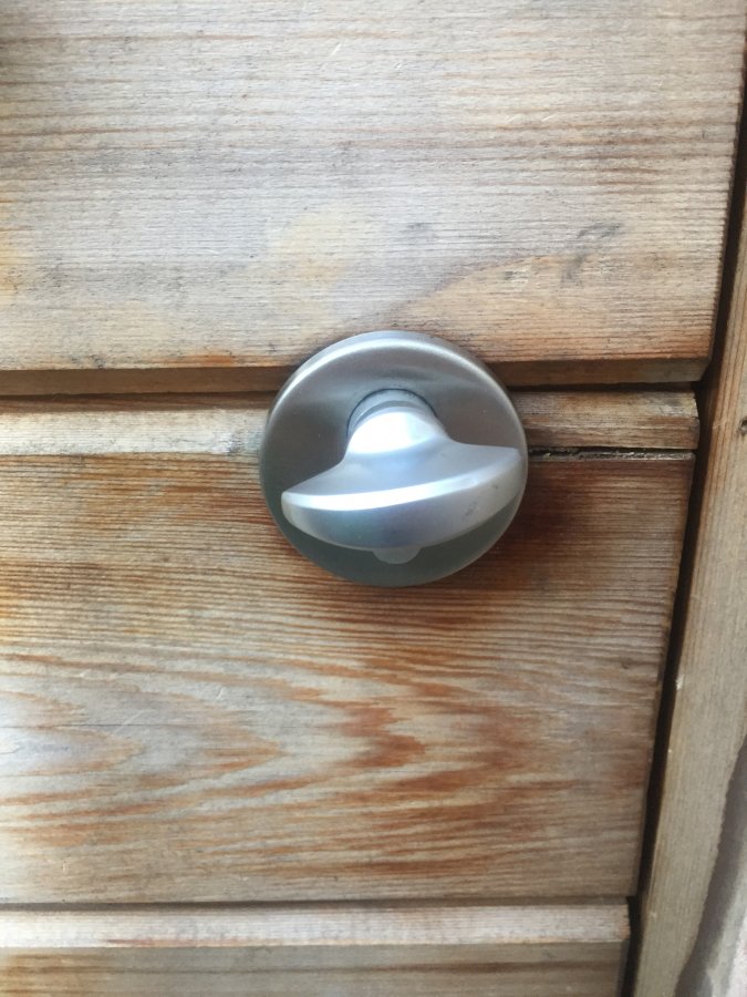

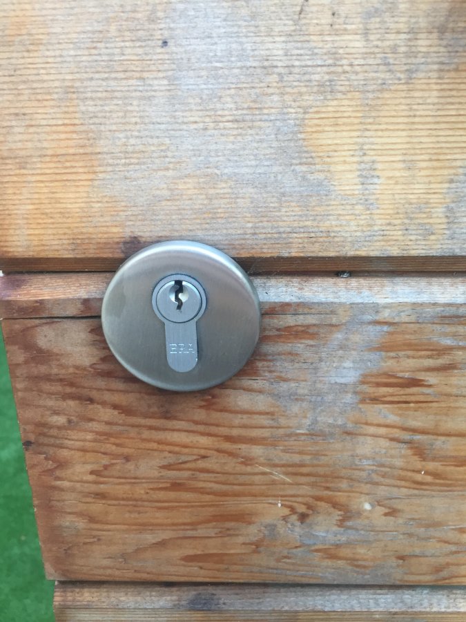

Show us the handle(s) and keyhole.
How secure a lock do you need?
The construction of your door or gate looks odd - I can see horizontal boards but no vertical styles. How is it made?
Yes, I tried googling for them, it says:
EN 12209
EURO SPEC
More images attached.

I have seen Eurospec as a brand
http://www.afs-securitysystems.com/eurospec/

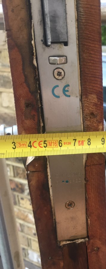

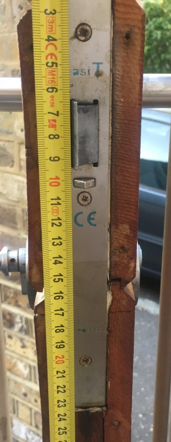

You will probably have to take the lock out of the door to measure and photograph the casing, and the positions of the spindle holes.
Yours looks like a deadlocking latch. I see yours takes a Eurocylinder, and the one fitted has an external key cylinder, and an internal thumbturn. These are easily obtained, you will need the length on both sides.

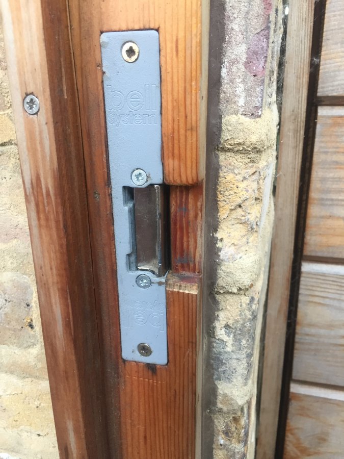

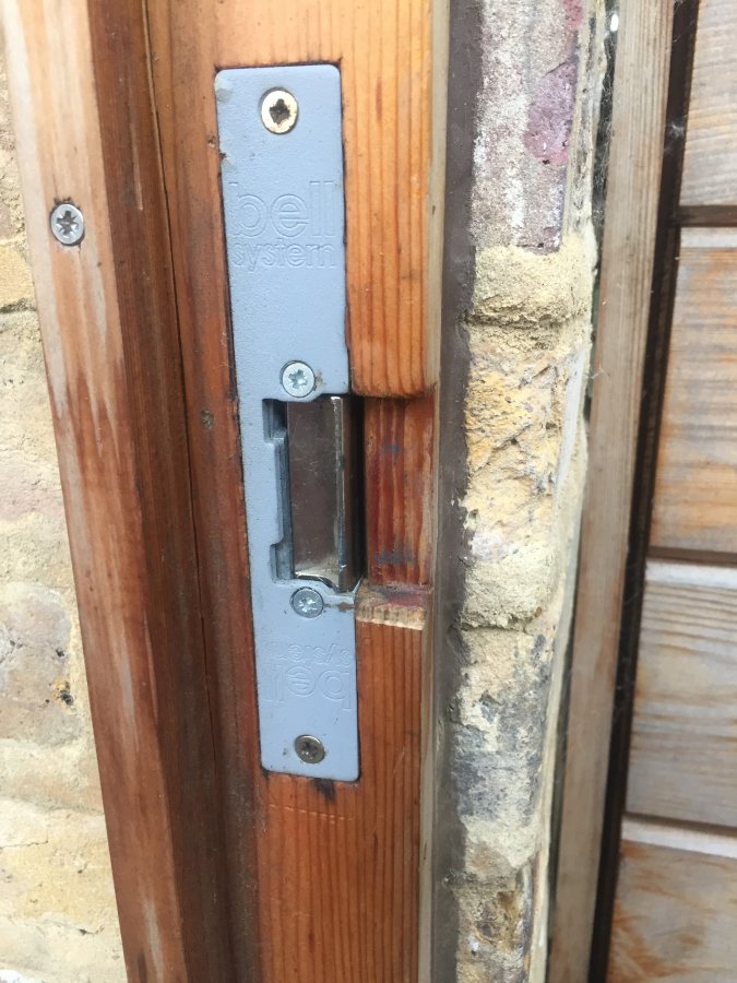

I see you have an electric latch release. Is this working, with a doorphone?
What's wrong with the old lock?

Yes it is working with a door phone however when we allow in using the door buzzer the door doesn't open but I can open it using the spindle from inside.
I've already replaced the other part it locks on and the door buzzer releases it properly so I figured it must be this part causing the problem.
Other part it locks on = first image in the second set I enclosed.
Thanks for the link, however measurements don't seem to fit?
do you suppose that the latch might be protruding too far, perhaps due to wear or the door having sagged, so not quite clearing the electric release? I wonder if you could test it with a small screwdriver, applying a bit more pressure to either of the parts to move them slightly further apart.
Possibly. It is a wooden door so has been impacted by weather over the years. If I jiggle the door it opens better so might suggest a problem with the door rather than the lock although a bit clueless about how to fix it. I'll try tightening the hinges suggested here...
