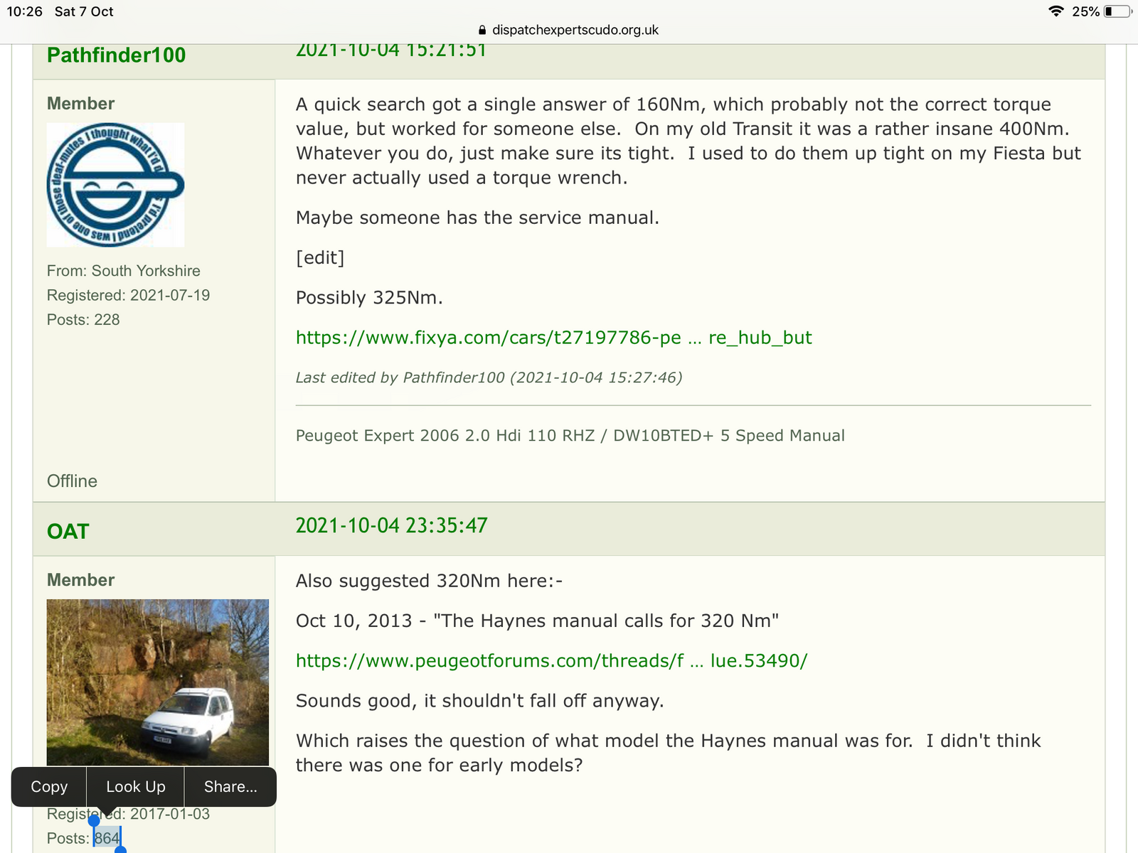

Search engine is your best bet , someone asked on this forum for the hub settings an got:
Thanks, have seen that one. Could be useful, but hoping not to have to pay £26 for torque settings. Not really a manual in the proper sense, complete with oily fingerprints on the pages.
This may be of help
Mine's the earlier MK1, but I suppose will be a useful guide. Found the torque for bottom ball-joint clamp bolt-nut assembly on there (70 nm), which I would guess is pretty universal. Unfortunately they only quote the rear hub nut torque, unless I missed something. The front hub is the vital one I need. May end up handing over my 26 quid. o_O:(
Hub nut is 300nm the other 2 settings aren't on autodata, track rod end nut is 38nm how does it compare to the balljoint nut for size?
