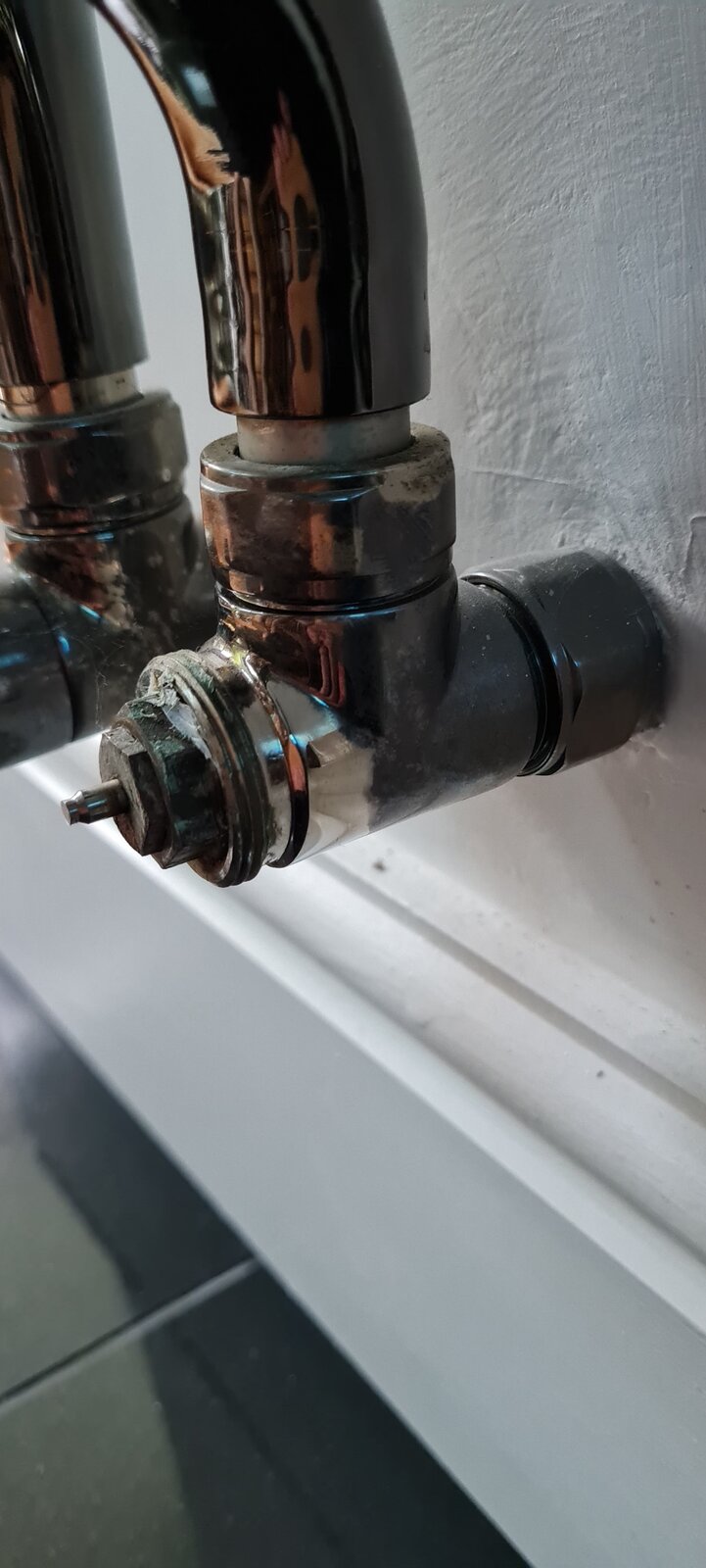

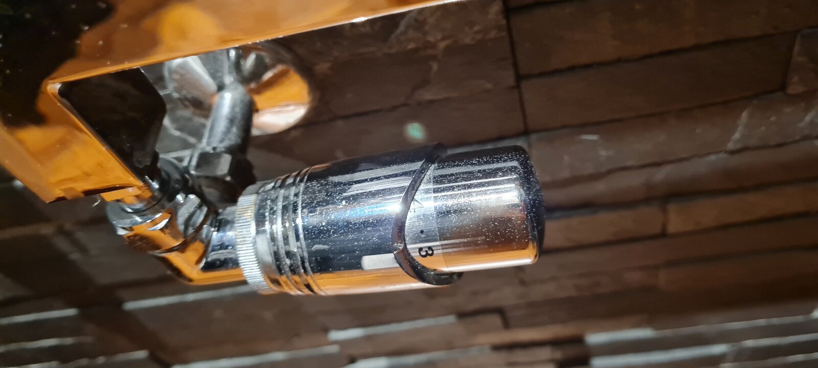

need to replace two valves, and drain system down. DIY job or get someone in
29 Jun 2014
210
7
Essex
afternoon all, last winter i had a couple of radiator valves that started weeping, one had been the year before and i put a small cup under them with the plan on changing them. I understand its a drain the whole system down, i have a drain plug on the rad in the utility room that i can use.
I haven't bought any valves yet but will have a look on screwfix or toolstation for the right ones.
the radiator tank in the loft has a bit of flimsy wood so no lid as such and its full of gunk, so i was going to wet and dry hoover all that out then try to drain it dowm.
i'm ok with DIY after watching a few how too's is this the tpe of thing for a DIYer or call ina plumber. my worries are, i drain it down and get a air blockage or worse, some crap in the system blocks it up, and the trying to undo the valves and twisting them or breaking them
The carp in the system is the biggie to avoid- good call on the wet & dry vac.
Key to not destroying stuff is at least 2 good wrenches- one to hold the valve/whatever steady against the loosening/tightening force you'll be applying with the other.
