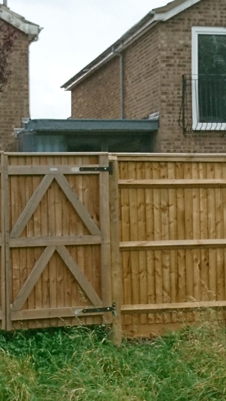

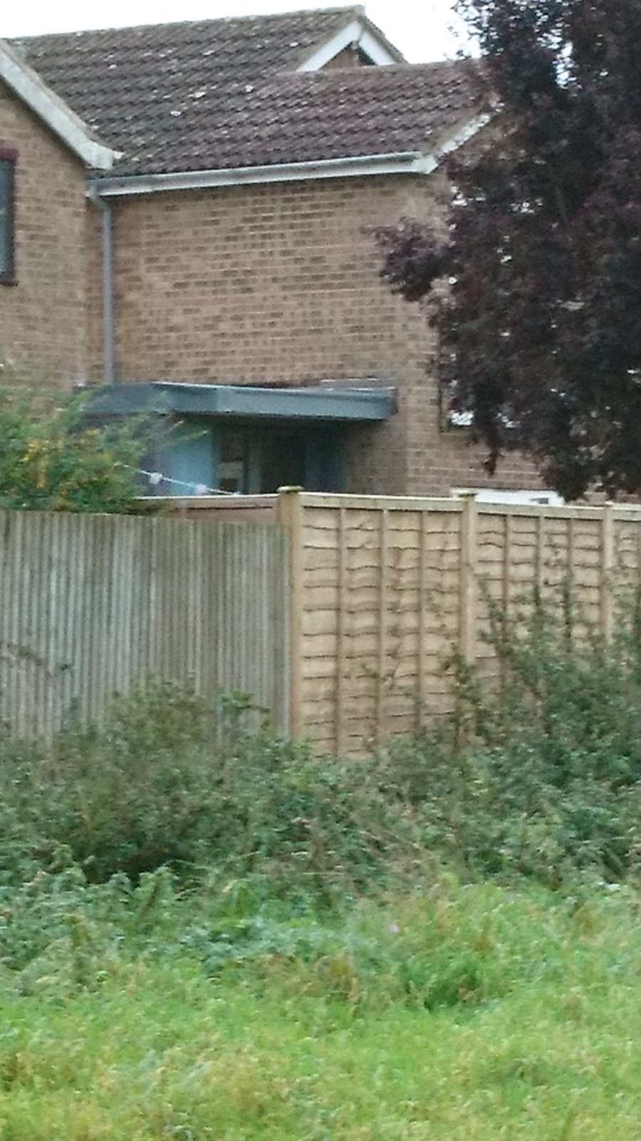

Hi guys, I'm Tom! I'm new hear and looking for some advice as the planning department seem to be no help at all...
So, my property is a linked detached house ( connected via garages) my neighbour had decided to build what looks like a continuation of his garage to the rear of the property. I know this can be done under permitted development laws due to the size but the problem I have is they had attached it to my rear wall. They have chased the lead into my house and drilled there roof structure to my bricks. As you can imagine it is now like living in a semi detached because they use it as living space ( party room). I tried to explain this to planning but they told me it's a private matter and a party wall agreement... Can anybody give me some advice as to what to do...

Where is the boundary line. Is your wall fully within your boundary? Or does your wall form a party wall.
You may get some help form a party wall surveyors. https://fpws.org.uk/

Did they serve a party wall notice and provide any drawings relating to what they planned? Did you give any oral or written permission agreeing to the extension? Did you at any time tell them to cease work prior to the completion or ask the council enforcer to get them to stop?
On the face of it you would have a claim for trespass
read: http://www.bailii.org/ew/cases/EWCA/Civ/2011/186.html
http://www.bailii.org/ew/cases/EWHC/TCC/2010/2678.html
you need to act very quickly a court may be reluctant to order the modification of the extension, unless you can demonstrate you took steps to stop the work during the trespass.

My neighbours fence is in line with my exterior wall so where he has built this extension is on his side but is my wall if that makes sense. He never told me he was building any kind of extension let alone attaching it to my property. They have not long moved in maybe 6months ago and have done alot of work to the house from driveways to new windows etc so I never took notice when he was making noise because it was normal when doing work like new patio and things but never noticed it being attached to my property until recently they had a party and it was like I was in the same room! When I looked over the fence noticed it was in fact attached. He never asked me permission or even told me what his plans was.
