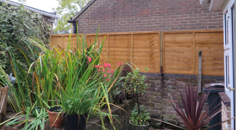

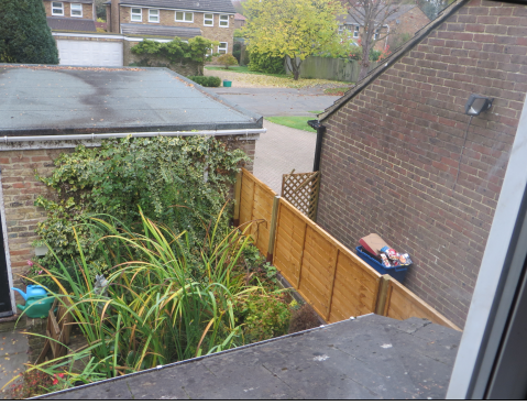

Just before the planning application was refused the neighbour placed a 1m wooden fence on top of the existing side boundary wall at the front (see photos). The wall is 1.09m and with the fence panels the boundary is 2.09m.
This fence is an eye-sore and blocks Alfred's light etc. and Alfred wants it removed. Alfred believes the fence is a ruse - if the fence is already blocking the light/view then an extension can not be refused for blocking the same light/view.

Re the photos:
Fence1 - is taken from Alfred's upstairs window. The building to the left is his garage. The vegetation forms part of Alfred's front garden. The neigbour's house is to the right. The proposal would have resulted in a rear door being inserted about where the waste bin is located.
Fence2 - is taken from Alfred's front garden. His front door is just in view to the right.

Forget logic, who owns the wall? If the neighbour owns the wall there is nothing you can do about it. If Alfred owns the wall then the neighbour must remove the fence. Though he could just build it right behind the wall anyway.
I think it looks better with the fence and I cannot see why it could be construed that the fence blocks any light there’s a bloody great brick wall right behind it. The planners will still determine the application on its merits and why would the first floor not still be detrimental? This fence makes no difference to an extension at first floor level.

Should be a simple matter of looking at the deed plan. The flank wall of Alfred's detached garage is likely to be built up against the boundary in which case it would seem the boundary wall in dispute is also build up against the boundary and would therefore be Alfred's property and the neighbour has no right to fix the fence panels to it. The other alternative is the walls are built astride the boundary and as such could be party walls but neighbour still cannot unilaterally fix the fence panels to the wall.
Ultimately Alfred is likely to be disappointed as he has no right to the view between his garage and neighbour's house so as Freddy said the neighbour could erect a fence on his side of the wall. I too do not think the fence is all that unsightly and does not contribute towards loss of light given the proximity of the neighbour's house.
There's no question of whom owns the wall. If you look at type of brickwork on the wall, and the garage, and then compare it to next doors property, then it definitely belongs to Alfred, and the neighbour had no right to erect it.

Irrelevant of the wall ownership they had no authority to fix a post to his garage
The neighbour has almost certainly ereceted the wall in the wrong place. But there's nothing to stop them moving it 4 inches over to the right place. I can't see what escalation of the dispute achieves.
It wont be quite so easy to erect the fence free standing, it would need to come in from the wall a fair bit and they'd lose some of the width of the path. Personally, I can see why they want a fence, but its for them to erect it on their land. Unfortunately, doing nothing ultimately ends up in the neighbour (after some years) acquiring a right.
The OP is under the assumption that they've put up the fence to strengthen their case for extending their property closer to his, and if he's right, then they're already intending to lose their path anyway. As they have no right to erect the fence on Alfred's wall, if they really want a fence for genuine reasons, then they'll have to sink the posts on their property, not his.
As the wall belongs to Alfred, if he leaves it there, then fence becomes his as well.
