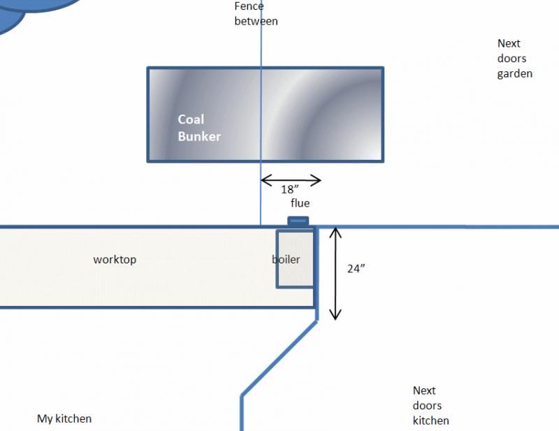

To be honest the boiler is pretty much right up against the inside wall on the righthand side. It's under the worktop.
Of course, it may be the case that it shouldn't have been installed that close to the *internal* party wall? In that case... :-(

I've read through most of the post with interest. If the fence is in the correct place, the boiler flue cannot be inspected or checked from your property. This is clearly an unsafe situation. You either have a boundary dispute or you have to rectify a safety issue with your boiler.
i would not say it safty issue as you can walk back till you can see the hole lot and my fga could reach it
Really ? How would you classify it on a Landlords if you had to sign your name to it.
What if the neighbour stands loads of stuff on the coalbunker and builds up the fence to its maximum height obscuring view and safe access.
Got to be at risk.
Is there anything you can derive from the coal bunker on where the original boundary lies? Whats the first floor like? does that have an offset? Got any chimneys on roof in party wall? Got any pictures of the rear of the building? Funny floor plan but still reckon you are going to have to shift it.

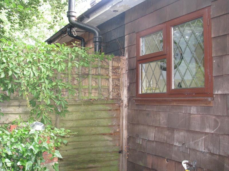

Someone asked for a picture of the back of the property. You can't see the other side of the fence of course, with the flue. But it's about 18 inches from the fence, wire grate covering in.
I was also asked about the coal bunker; this is in fact divided into 2 - so there could be an argument that *this* is the party wall :-( When this was done of course no-one has any idea. Does that sound likely?

Having just looked at your picture's the fence just doesn't look right to me it's too close to your window. Another clue is the downpipe which is right over on your neighbours side this is most likely the central divide between your properties one downpipe will be on the front another on the back both are usually dead centre with one property being responsible for the front one and one the back one.
I've noticed the soil pipe too and wondered if this is leading to your bathroom or is it just a vent?
The properties seem to be of a chalet type, not sure if this has any bearing on things though.
Someone at sometime has put up a fence in the wrong place and all as been well for quite a few years until another factor came into play.
It's certainly created a tangled web for you but for me the blame lies with the person who erected that fence thinking it will never matter many years ago!
To be fair when the fence was erected it was done with nothing but happy spirits! The previous owners (of both properties) got on famously, and they have been nothing but EXTREMELY supportive during this crisis.
You know what it's like; you don't intend for things to get sticky at any point. So yeah no challenges against them - they're LEGENDS.
