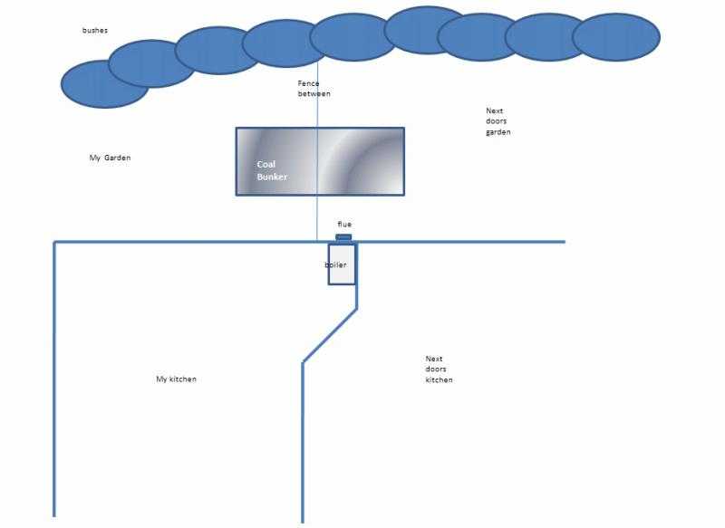

I've tried to do a bit of sketch - hopefully this will make it a bit clearer.
As you can see there is that kind of 'offset'.
My old neighbour said that the boundary is actually about 18 inches to the right of the fence that was erected. Which would put it inline with the internal party wall. I don't think however, that my new neighbours would even listen if we told them the boundary is actually 18 inches into their garden! I'm assuming the fence position almost dictates it :-(
I guess this would make sense (who knows why the house was divided with that offset internally!)
I guess I'm still a bit confused about the party wall thing. If the boundary is indeed along the fence, then they must own the outside of the wall (the offset bit where the flue is), and us the inside of the wall - I'm assuming this is how it works?

Thats an interesting situation. Its not very common so there will not be much case law but there will be some and D Hailsham might be able to rersearch that but he must be on holiday at the moment.
Based on your sketch, it seems the fence line is almosy midway between the main party wall and the rear party wall created by the offset.
Based on what you have shown, I would say that if the fence position is NOT documented clearly on the Land Registry plan ( most likely ) then there is a good argument that the actual boundary in the garden and the rear of the house is in fact the line formed by the rear party wall.

Can you do an expanded drawing of the boiler and boundaries with dimensions?
You cannot discharge or have ANY part of the flue within 300 mm of the centre line of the party wall. At least thats the way that I interpret the regulation.
It may be that the boiler is still too close based on how you have drawn it.

Thanks Tony,
Yes the deeds pretty much show a straight line going from the front of the house to the back, not taking the internal wall offset into account.
Therefore, I guess there is a challenge that says "The rear boundary is inline which the inside party wall".
I think from a 'show willing' perspective, we're also keen to point out that as an act of good faith, we make no intentions to reclaim this bit of the garden, and are happy for them to have that extra 15SqFt. However, we would request that they do take no further action to build on this.
