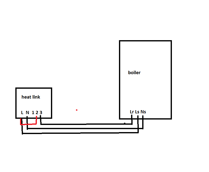

Hi All,Would be great if i could get some help.
Had a new boiler installed worcester 34cdi however didnt have the nest to hand back for plumber to fit so attempted to have a go myself yesterday however it doesnt seem to be working correctly.
I have connected it in the following way (below), the heat link is connected and powered and clicks when i change the temperature however it doesnt actually turn the boiler on ?
connections are in the image and below.
(boiler) Lr - 3 (HL)
(boiler) Ns - N (HL)
(boiler) Ls - L (HL)
(HL) L - 2 (HL)
Looks OK to me. You don't show the incoming 230V supply but I guess it's connected to N & L at the Heatlink and via the connecting wires also to Ns & Ls at the boiler. For a combi these would have to be present for the hot water to work.
So you need to find out if the Heatlink making terminal 3 (call for heat) live when it clicks on? Are you able to test this with a multimeter? If it is Live, the Heatlink is OK. Then the same test should be made at Lr (Live return) at the boiler.
Also, check that the connections at the Heatlink are secure and that the screws are firmly clamped on the conductor and not the insulation. The Heatlink can be a bit fiddly especially for those not used to making electrical connections in confined spaces.
I assume that the wiring is exactly as shown in your diagram, including the L to 2 link and that there isn't some wiring to an existing room thermostat connected in somewhere.
Thanks for the confirmation, so i have checked all the wires and i think one may have been loose, the double wires into connection 2 on the heatlink.
So i just want the nest to control the radiators, therefore what setting am i supposed to turn the knob to on the boiler? it seems like when i leave it on the lowest setting(frost) the nest doesnt fire up the boiler when i turn the temp above the house temperature on the thermostat, however it does work when the boiler is set at numbe r1 for example?
