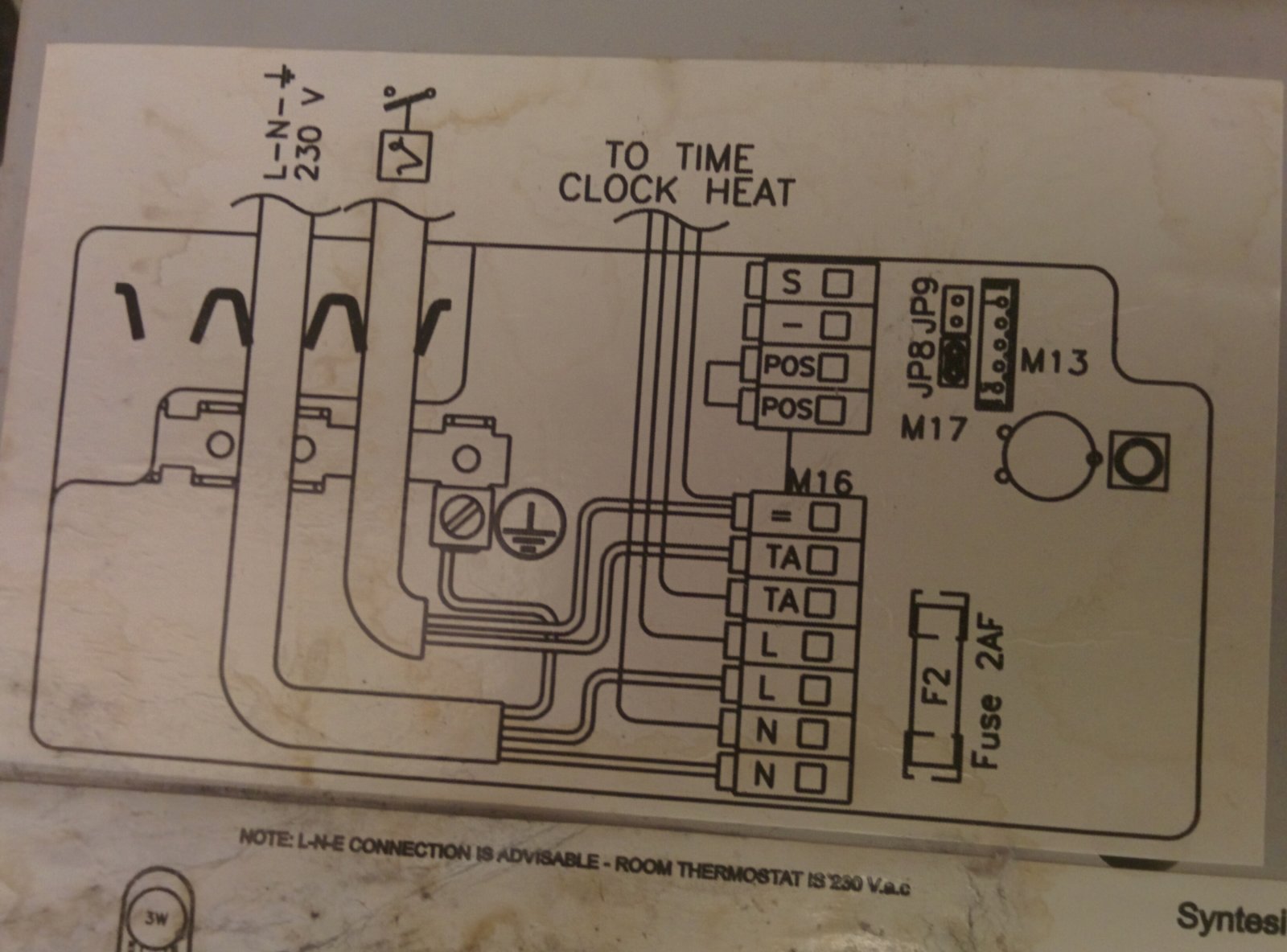

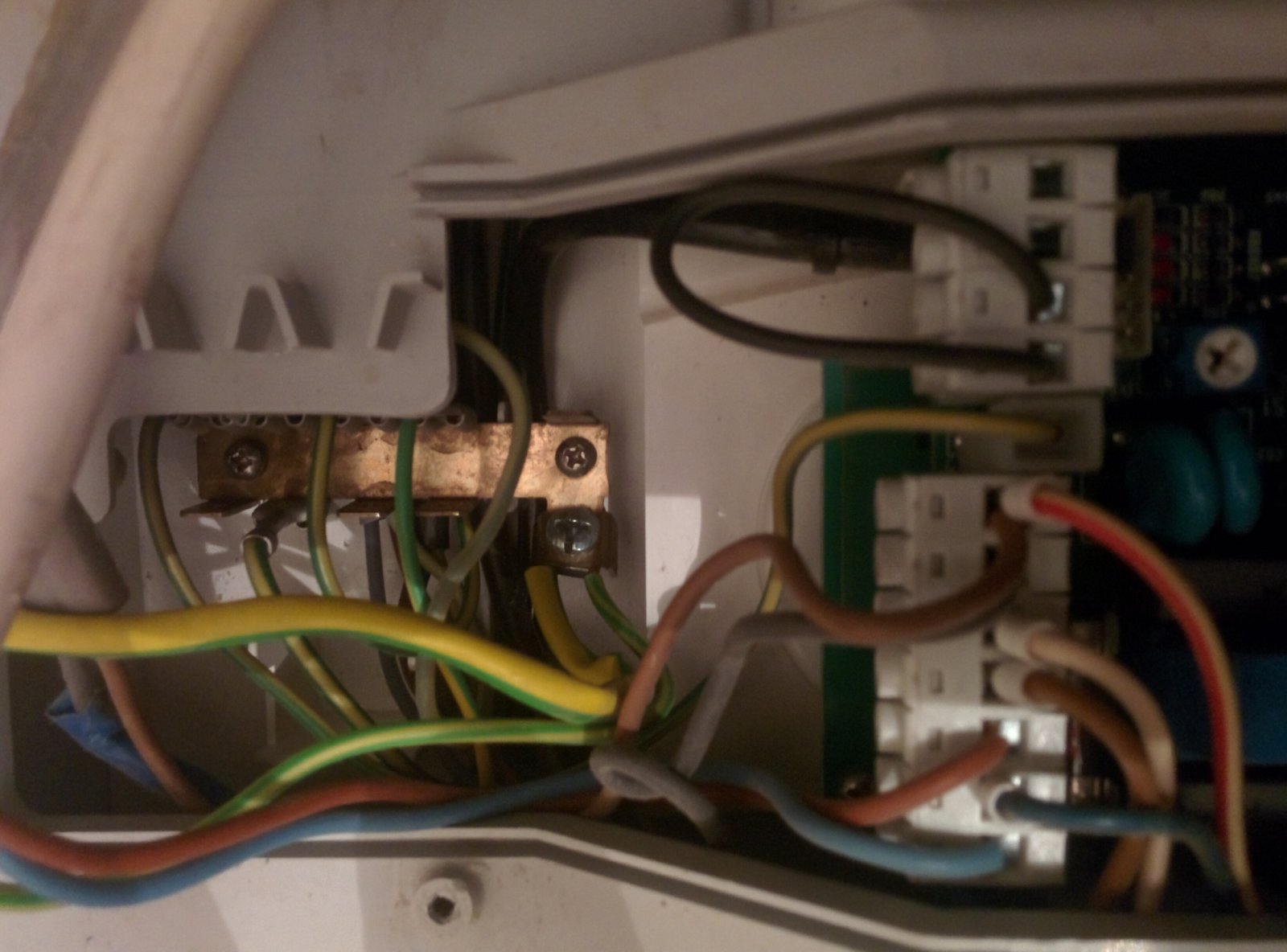

Hi folks I'm looking to connect my combi boiler up to nest thermostat,
I have a myson programmable thermostat on the wall at the moment leaving the boiler switch at constantly on.
My question is ,is just a matter of taking power back to the heat link from the boiler and then taking a wire from the thermostat cables on the boiler back to the heat link or is there anything else I need to connect, thanks

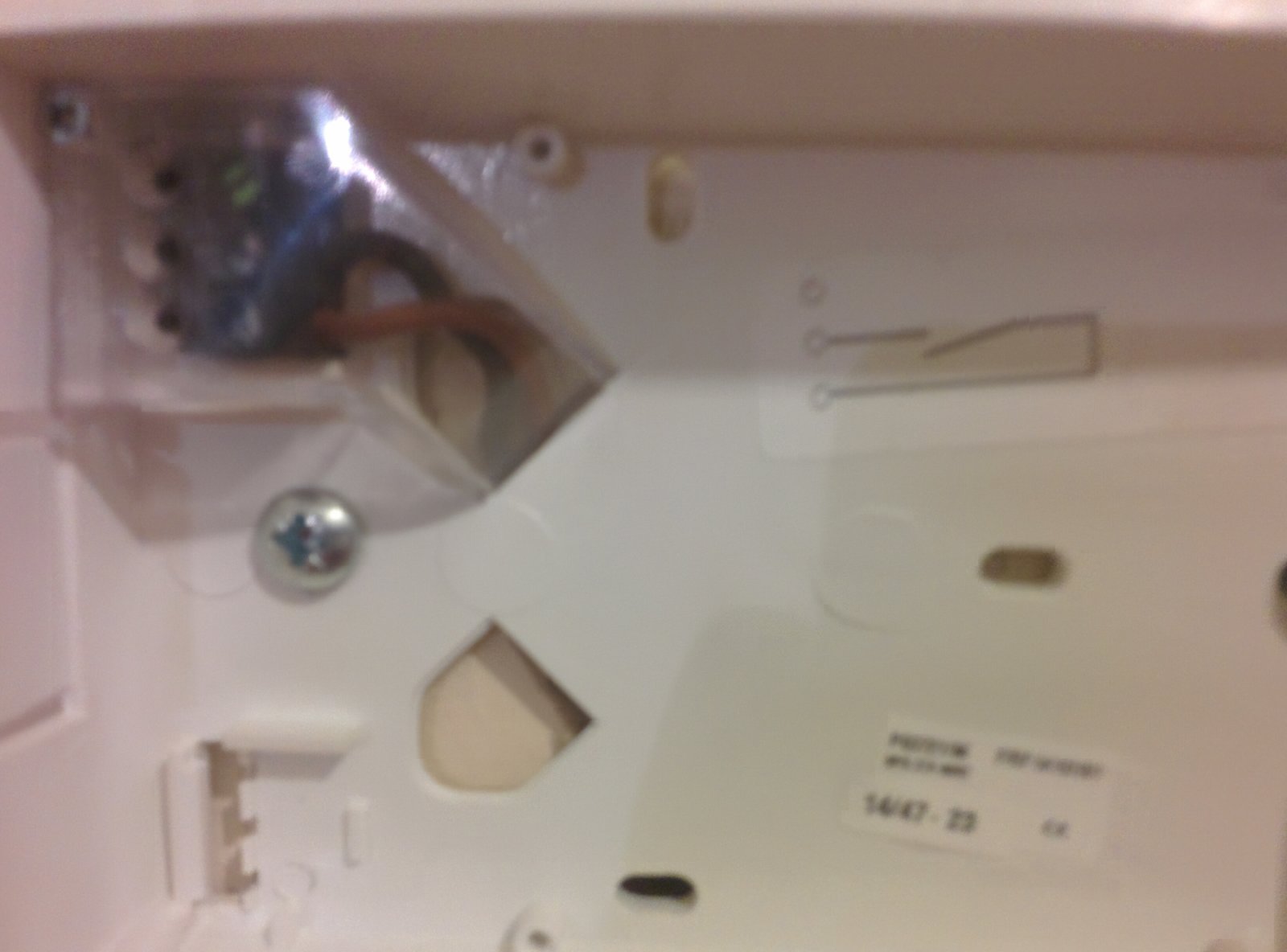

Hi mate thanks for getting back to me.my current thermostat is a myson mprt wired controller,there is only to wires going from boiler to thermostat.

OK, thanks. Sounds like you have figured it out yourself pretty much. So:
The bottom wire in the photo (brown?) goes to the Heatlink terminal (2) Common
The top wire in the photo (black?) goes to Heatlink terminal (3) heating call for heat.
Then you need to run a 230V N & L supply plus earth to the Heatlink. This should come from the same source as the boiler. Either the 'load' side of the 3A fused connection unit, or the boilers L, N & E terminals that are supplied from the fused connection unit, whichever is easier.
I'm not familiar with the physical construction of your model of boiler, but if it is necessary to open up the room sealed part of the boiler to access the wiring, then the first method should be used. Only a Gas Safe engineer should open up the sealed part.

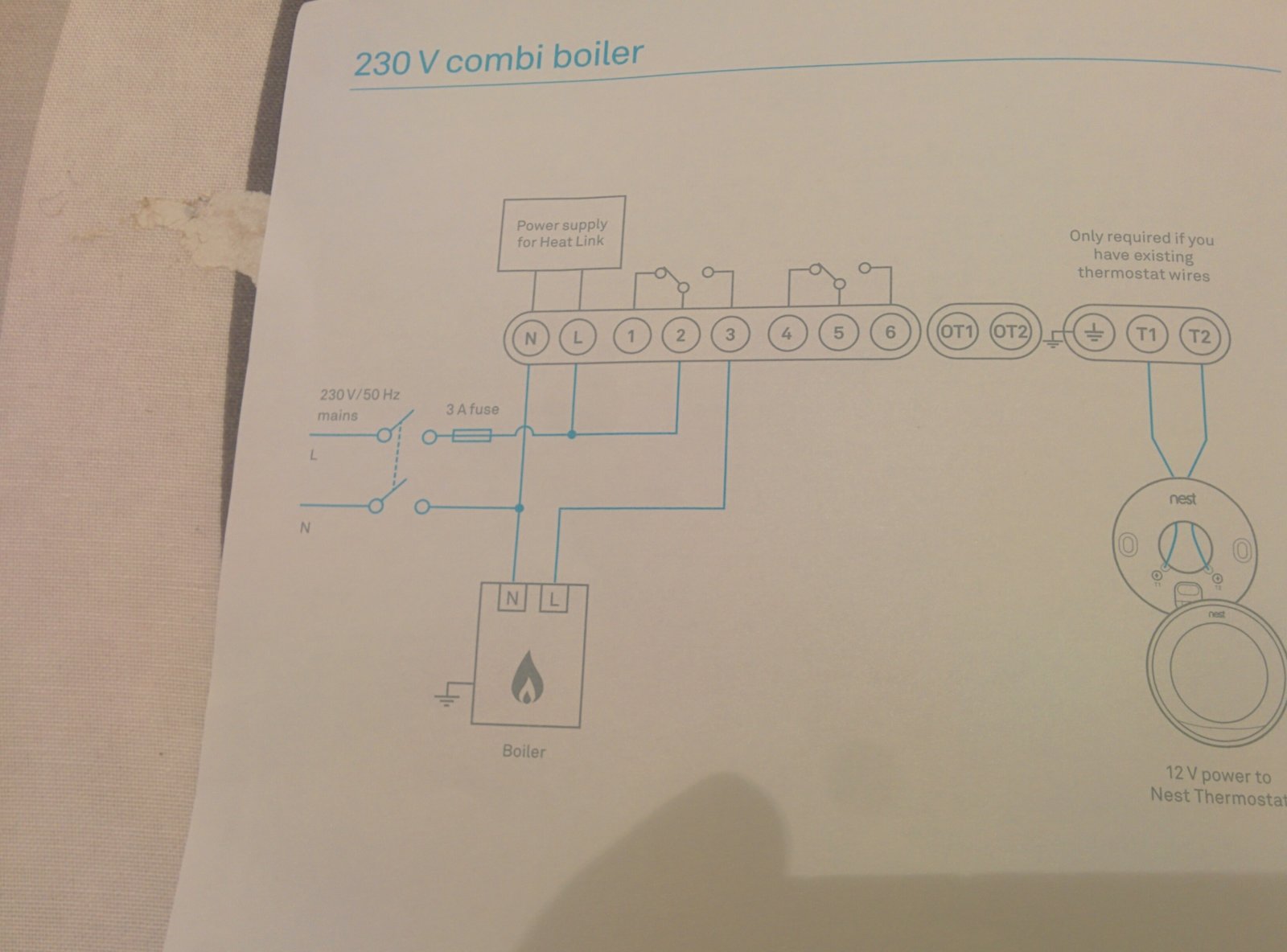

After speaking to spark on-site today am going to use a 5 core heat resistant cable and take power from boiler
N boiler-N heat link
L boiler- 3 on heat link (loop 2 to L on heat link)
E boiler - E heat link
T1 to thermostat
T2 to thermostat
The spark did say try it with out the loop first

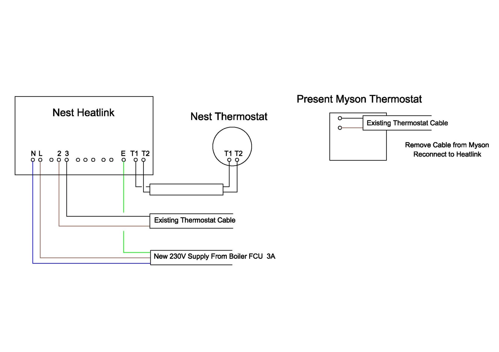

5 wires are required for the mains wiring. Two already exist at the Myson mprt and then the 3 new wires you require are a mains supply N, L & E. So, to summarise the 5 wires as follows:
New 230V supply from the same supply as the boiler to provide power to operate the Heatlink
1) New Live (L)
2) New Neutral (N)
3) New Earth (E)
Thermostat switching wires
4) Brown wire presently going to the Myson mprt is removed from it, and instead goes to the Nest Heatlink terminal (2)
5) Black wire presently going to the Myson mprt is removed from it, and instead goes to the Nest Heatlink terminal (3)
You can use a plug in power supply to power the Nest Thermostat, but if you want to run a wire from the Heatlink to the Thermostat to connect their T1 & T2 terminals, then that's fine, and would be my preferred solution. T1 at the Thermostat goes to T1 at the Heatlink. And T2 at the Thermostat goes to T2 at the Heatlink, However, as this is only 12v, then then a separate cable should be used from the one carrying the mains voltage.
To summarise
L on boiler to L on heat link
N on boiler to N on heat link
E on boiler to E on heat link
Brown cable that goes to myson thermostat on boiler removed and replaced with new cable an run to 2 on heat link.
Black cable that goes to myson thermostat on boiler removed and replaced with new cable and run to 3 on heat link.
New cable run from T1 and T2 on heat link to T1 an T2 on nest thermostat.

I think you are about there. Just, not quite sure what you mean by....
Original cable to myson thermostat will be short as heat link is outside of boiler ,I have easy access at moment
However, this is what you should be looking to achieve.
Note, that this is pictorial only to illustrate the connections. In reality, the cable outer sheaths should be extended into the Heatlink and secured under the cable clamps provided.
